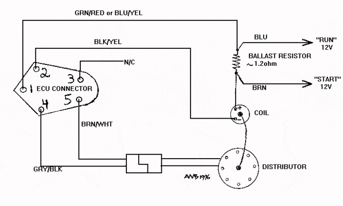

I am not sure of colours but there are two power wires. One supplies voltage while cranking the other supplies voltage in the run position.
The cranking one would go direct to the coil the run one would go to the ballast resister.
Only one resistor is required.
cool72
Oct 13, 2013
36
3
Thanks, I have to identify the cranking wires which should go to the starter then the running wires (other side of the resistor?) Where I also connect my ignition/tech wire? Sound ok?
340challconvert
Feb 13, 2011
5,458
2,929
Parsippany, NJ
This should help!
cool72
Oct 13, 2013
36
3
Great detail, thanks much. I will post my results when the engine runs. Thanks again
