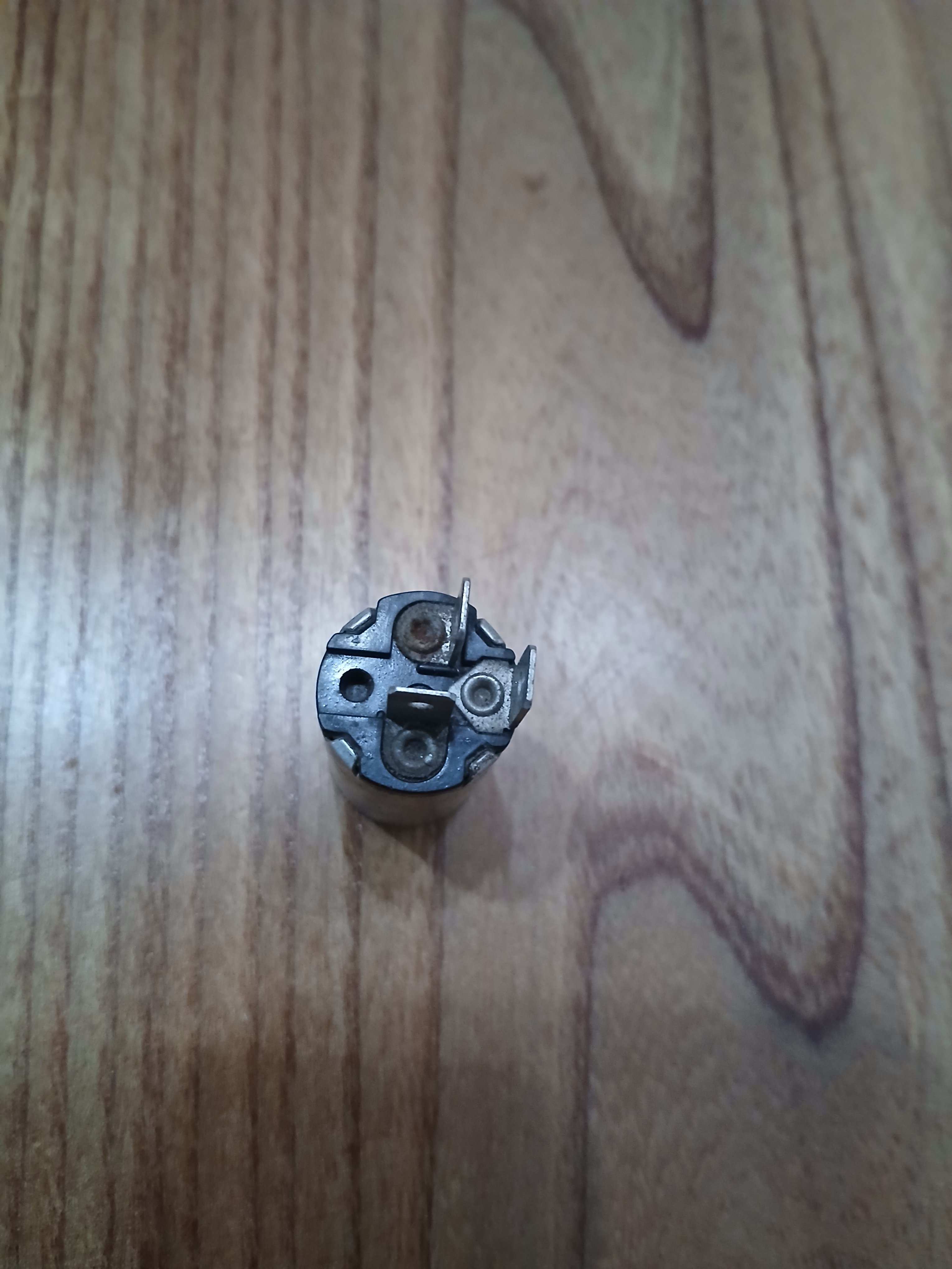

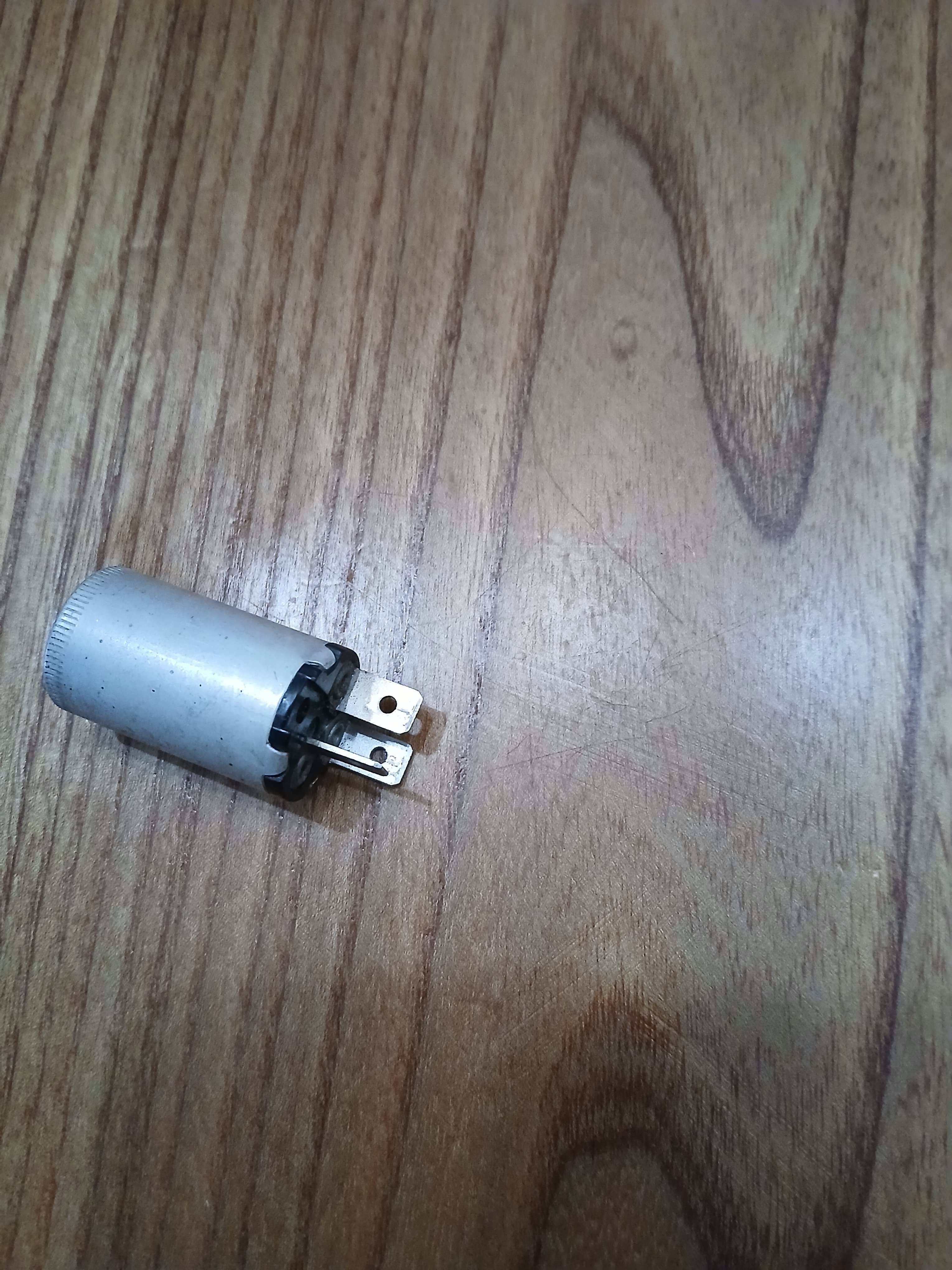

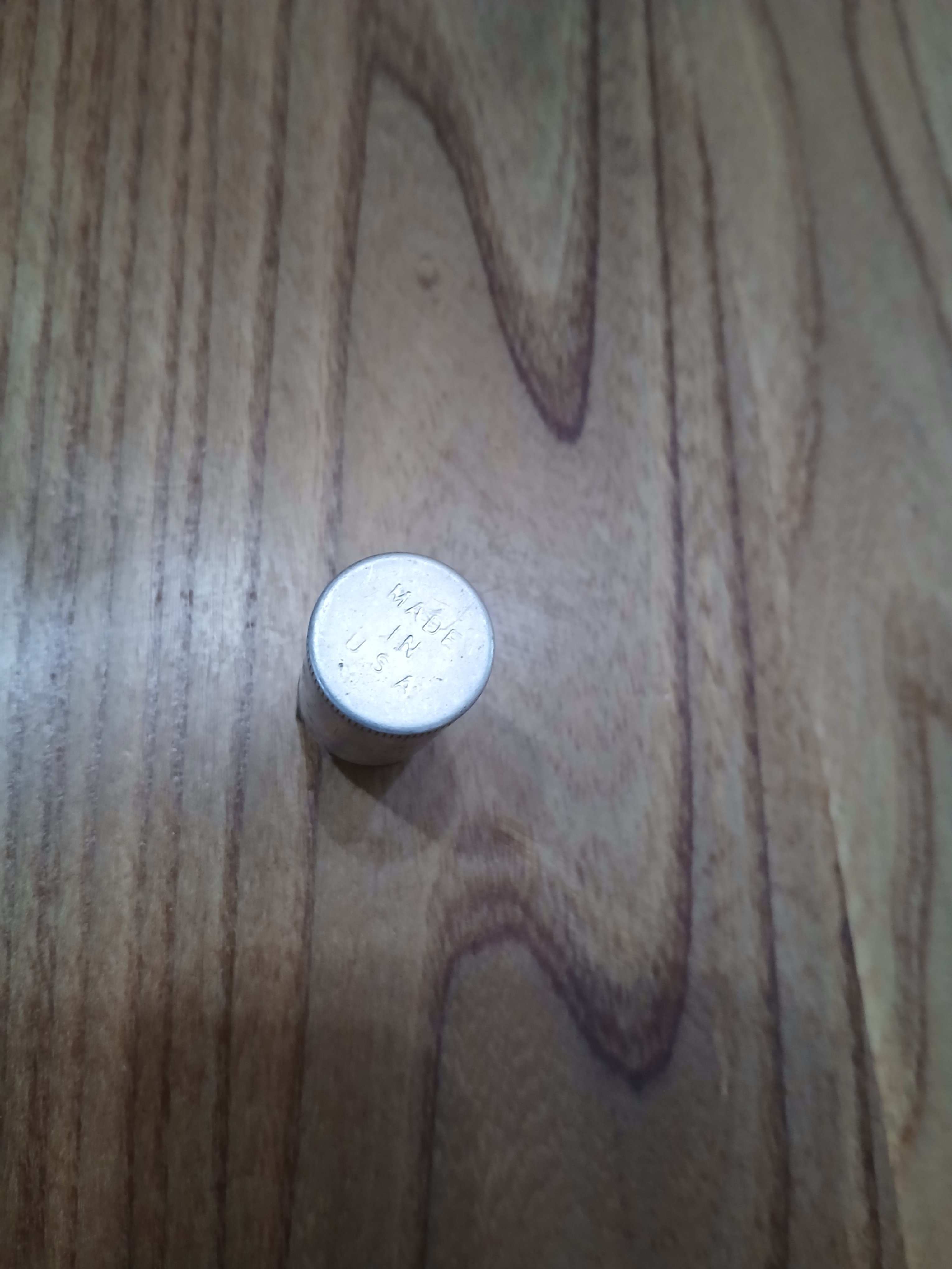

I believe it is a flasher, turn signal relay? Been looking on the internet, and have had no luck identifying? Trying to locate a new one, because this one gets super hot. Any input would be appreciated.

Do you have the AO1 light group? That timer operates the delay on the ignition key and the switch title lamps.
When you open the door the lamps illuminate and when you close the door they stay on for about 25 seconds.
That timer comes live and gets quite hot if you leave the door open.
If I want to hold the door open I disconnect the battery or pull the timer out of it's connector.

The delay timer should cool down when the door is closed - if not it may have been damaged when someone left the door open for a long period or there is a door switch fault etc.
Someone on here posted it was supposed to be held against the steering column so the column could act as a heatsink. I leave mine hanging in mid-air away from any wires etc.
Summit Racing has them manufactured by Crown # 2889565

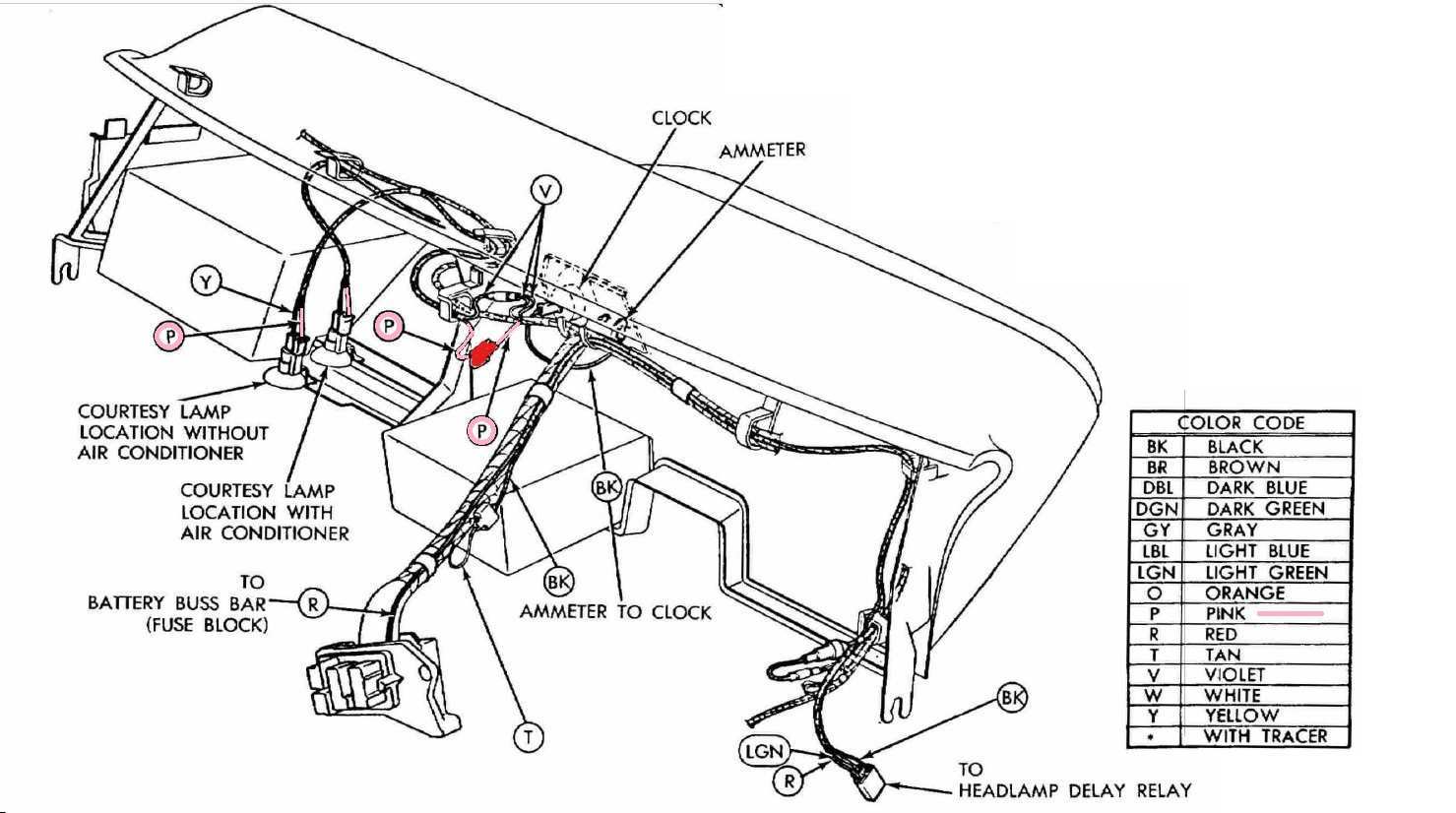

Don't know, but the dimmer switch is bad. Maybe that had something to do with it??

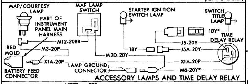

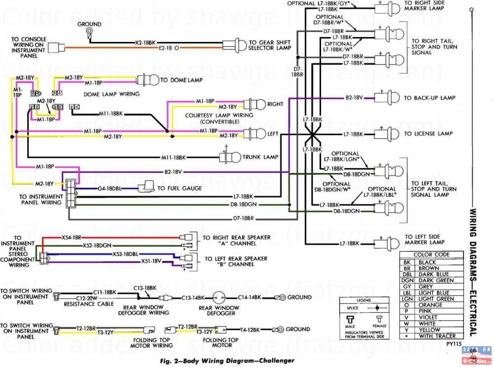

No I don't think so if the wiring is correct. They are two different circuits. The pink and yellow wires are for the dome light. Door switchs and dimmer sw for dome light. The delay relay is on it's own circuit if you look at the diagram above.
Challenger RTA
Oct 28, 2018
4,222
2,267
PA Flood city
The M6B-18Y* coming off the delay timer is connected to the door switchs. When the door opens it trigers the delay timer. When the door is closed it times out.
