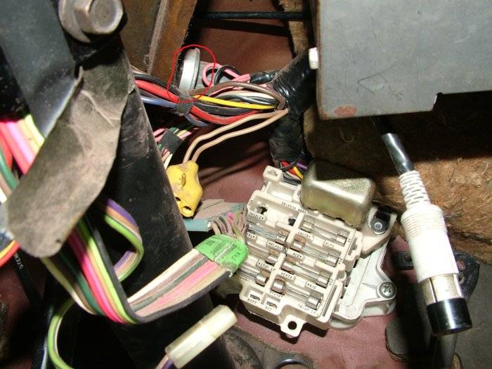

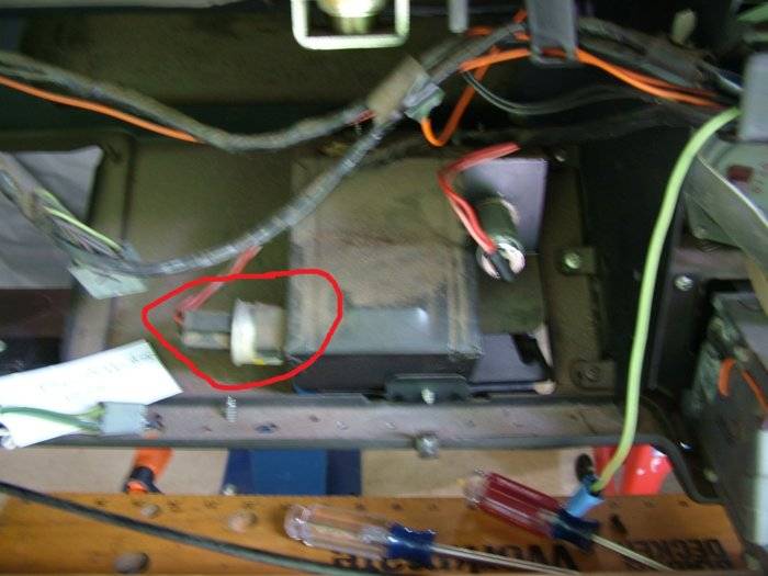

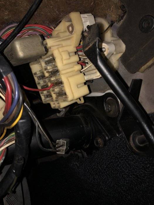

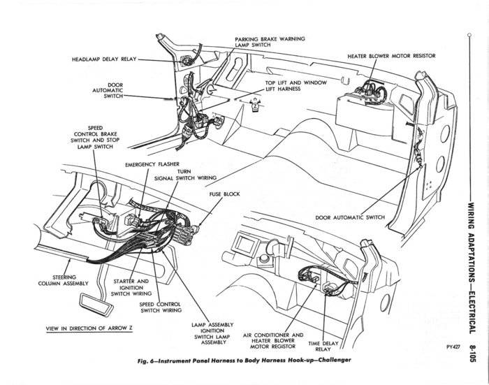

Where is the flasher relay located under the dash? The FSM says its on the brake pedal bracket....I don't have one on the bracket. Can someone send me a pic?
This should get you close!
4 way flasher is on the fuse block and the directional flasher is usually behind the ash tray
The one in the fuse box. They are both the same part but 2 separate functions
I guess depending on what year you’re working on. Good picture. I believe the one on the pedal bracket if the 4 ways. Just checked my car, the flasher is not on the fuse panel like I thought. My bad, must have been my other car I was thinking of. Oops
