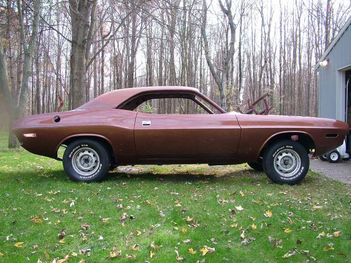

Rick....It does install from the outside. Your quarter panel needs to have the recessed area for the flip top assembly to work. PIC is a little hard to see the recess.

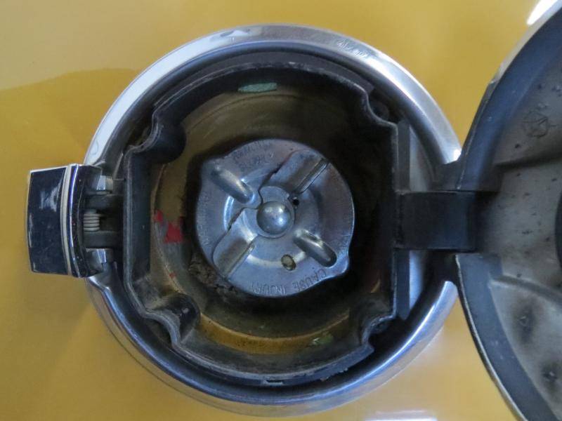

Put small stainless steel allen bolts through the front with nuts on the back. While not impossible to steal, it makes it just not worth the hassle. There is a gasket that goes under the trim ring. Does your cap have the spring with the rubber stopper on the end? If not, you will need a small cap to put inside of the flip top. Without the cap you will dump fuel when you go around corners.

Thanks guys, I was wrong it does have 4 mounting slots. My car is 2 1/2 hours away in the paint shop so I couldn't go look at it or take pics. I'm wondering if the little recess is not deep enough?? (after market 1/4 panel too) When I was last out in CT. looking at the car you could see the black mounting tabs ,certainly didn't look right. I have a 68 Cuda with a flip top no cap under that one . I am aware the challenger does have a cap under as I have that. Still not sure ,??? Maybe someone can snap a pic with their cap flipped open. Rick

Welcome. Look at post # 6. The link that I show have the pictures that will answer your questions. The holes are already there. They are self tapping type. The flip-top cover comes with the screws. It also take a s/s trim ring. The cover should come with a rubber cup on the bottom side of the cover. This is to acts to do 2 things. The cap required to go under the cover is usually the locking type. The rubber seals the key slot and act as a flexible seal to keep the cap from rattling loose with time. Be sure to clink on the links inside of the links also. Matt has a good picture on post # 11 of a cap properly installed.
