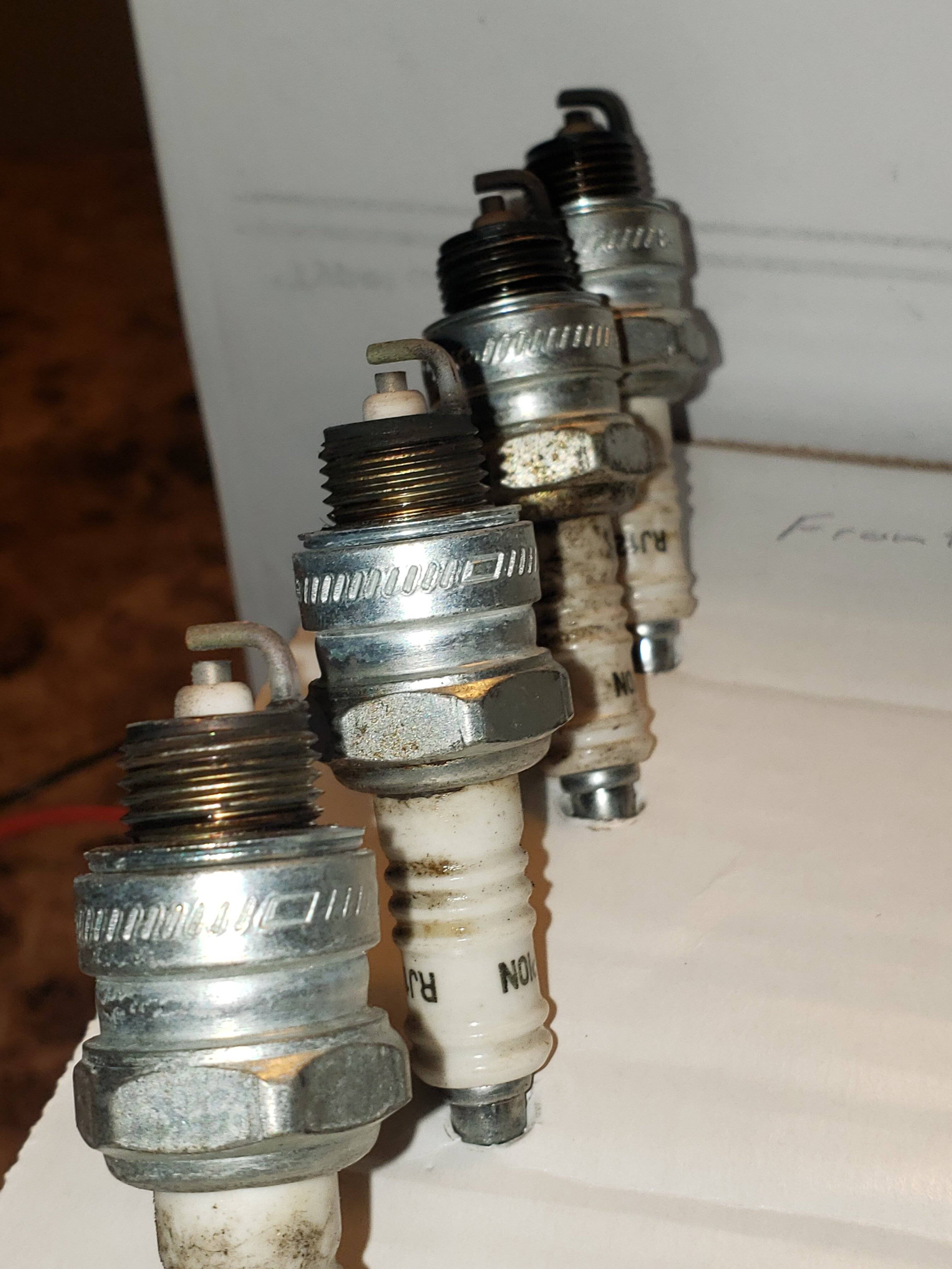

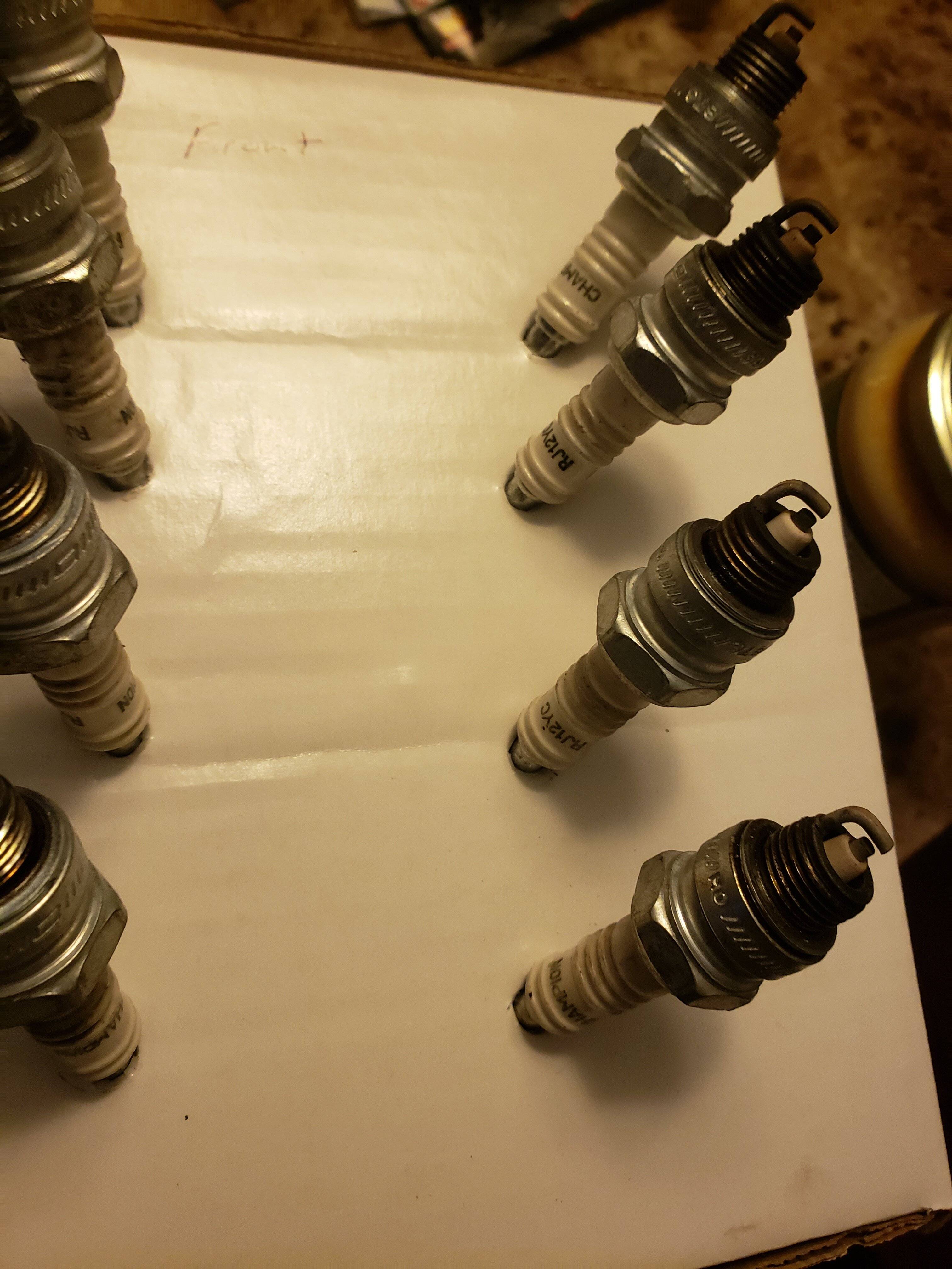

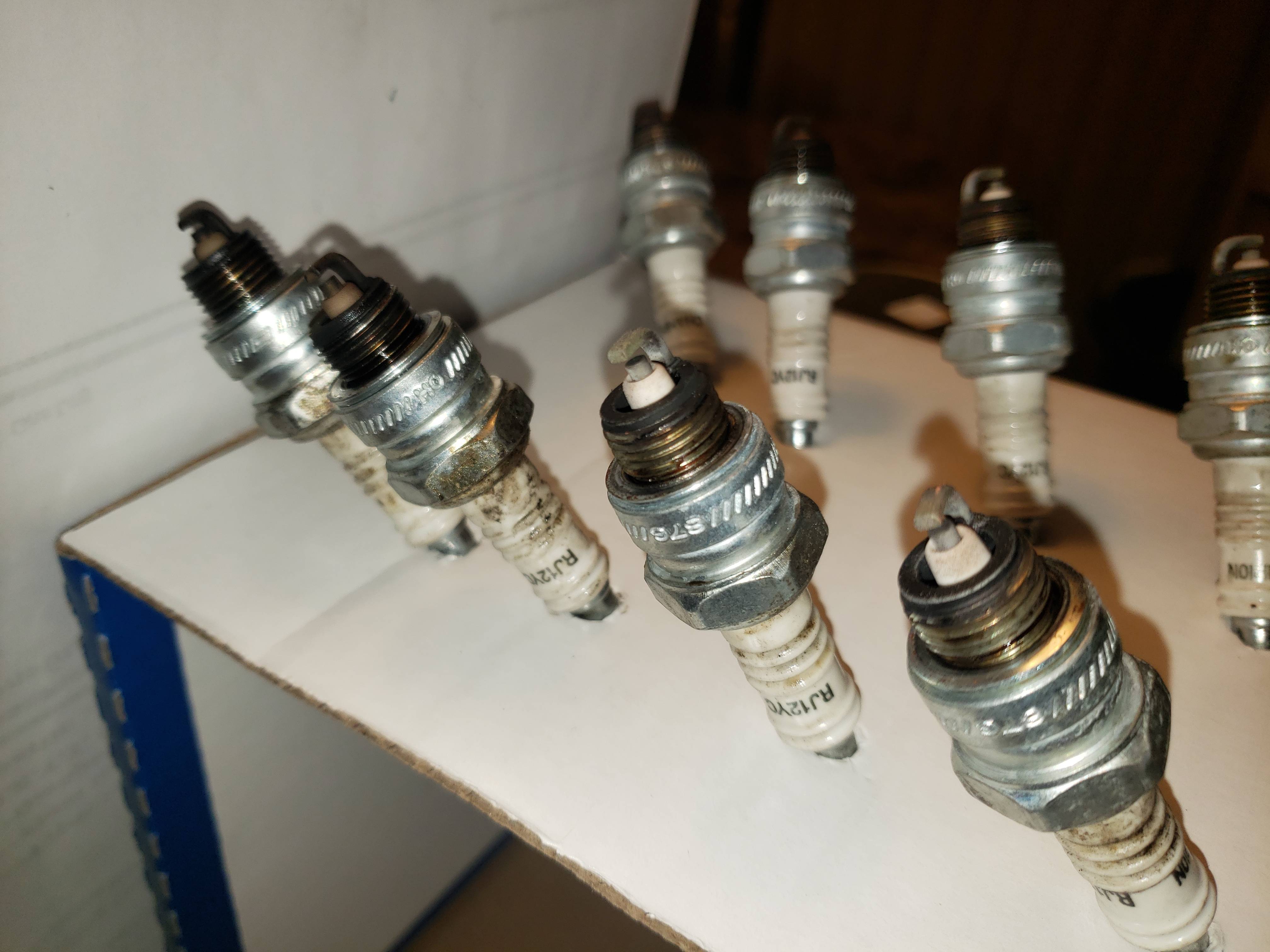

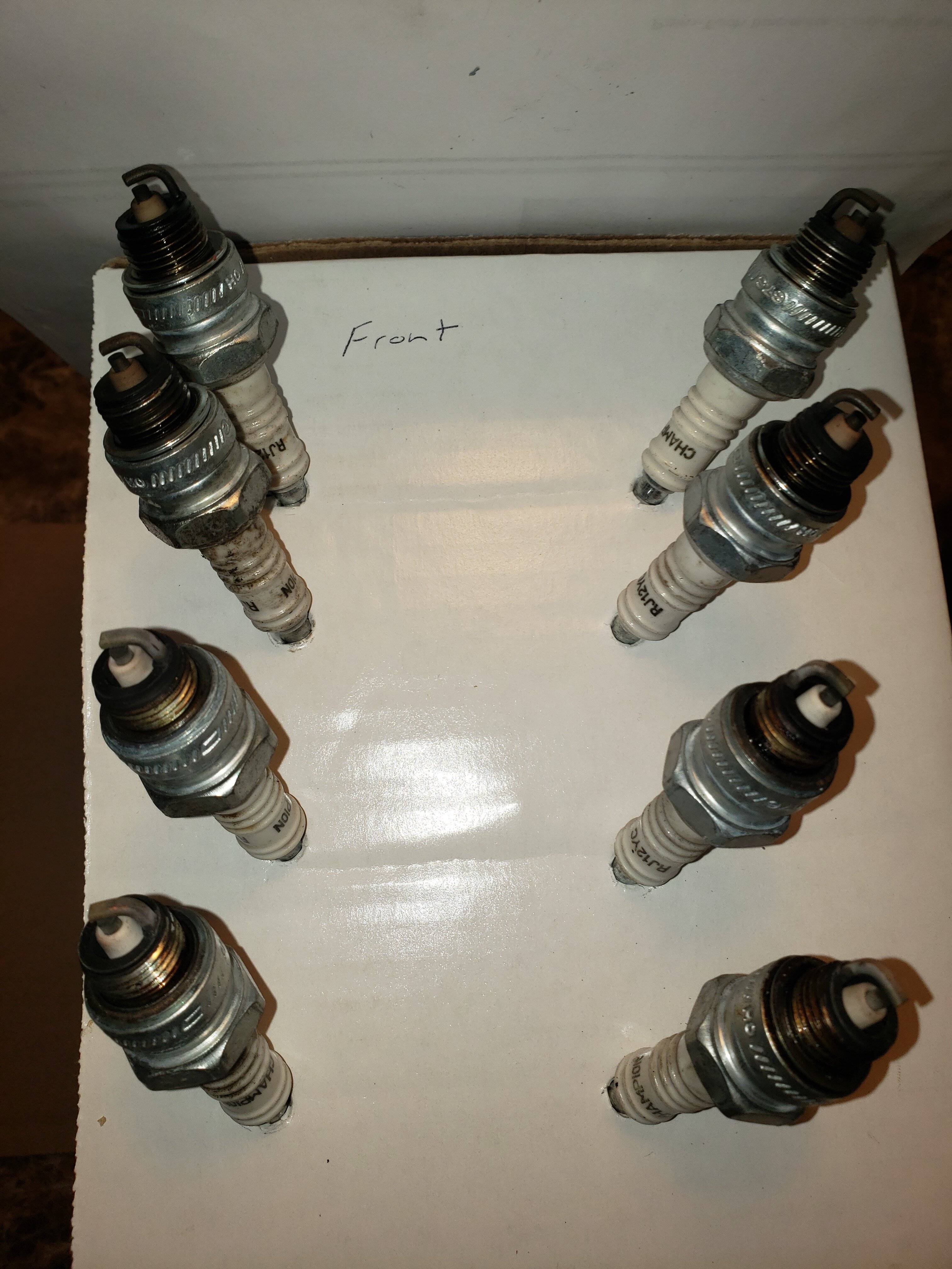

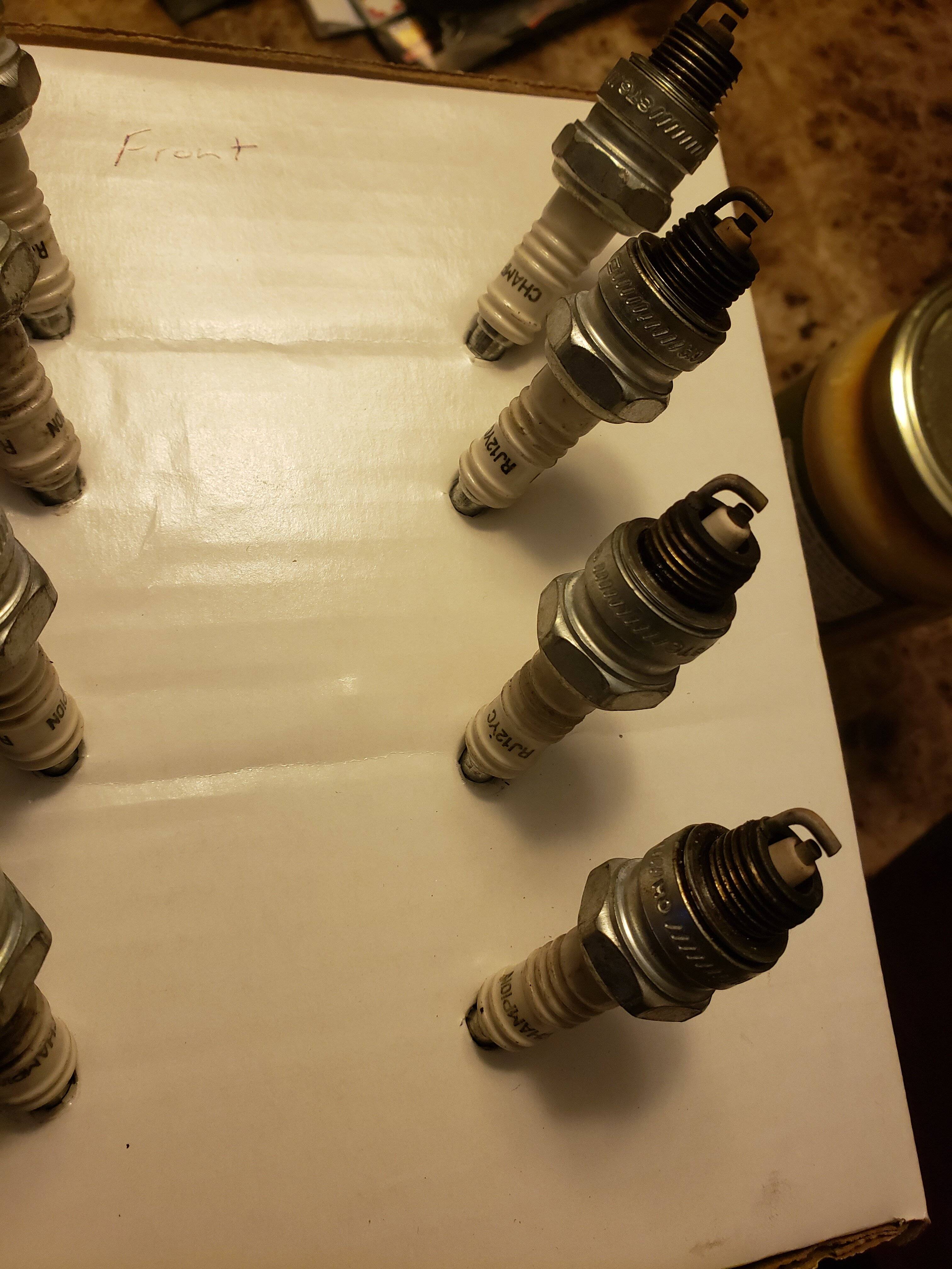

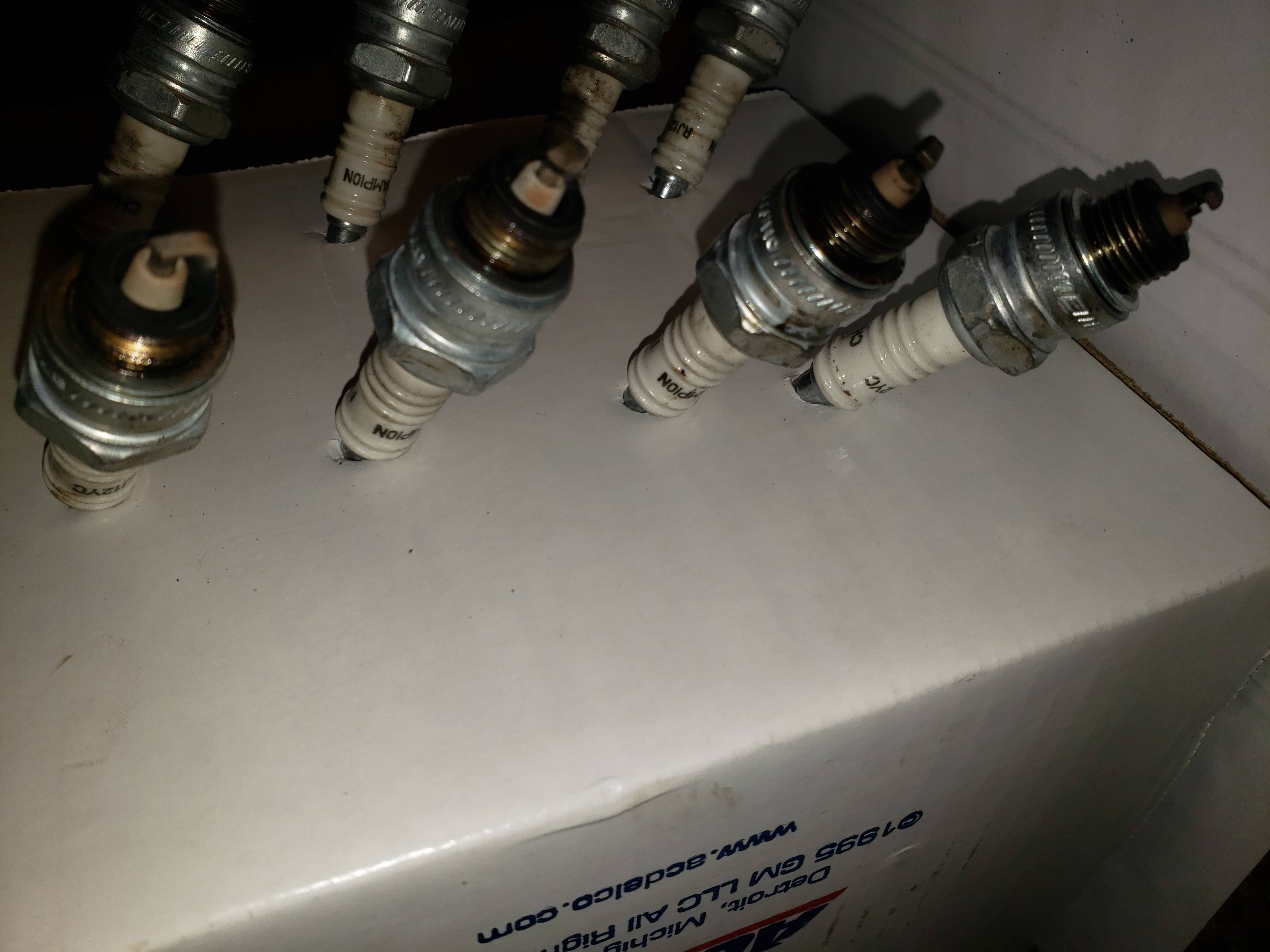

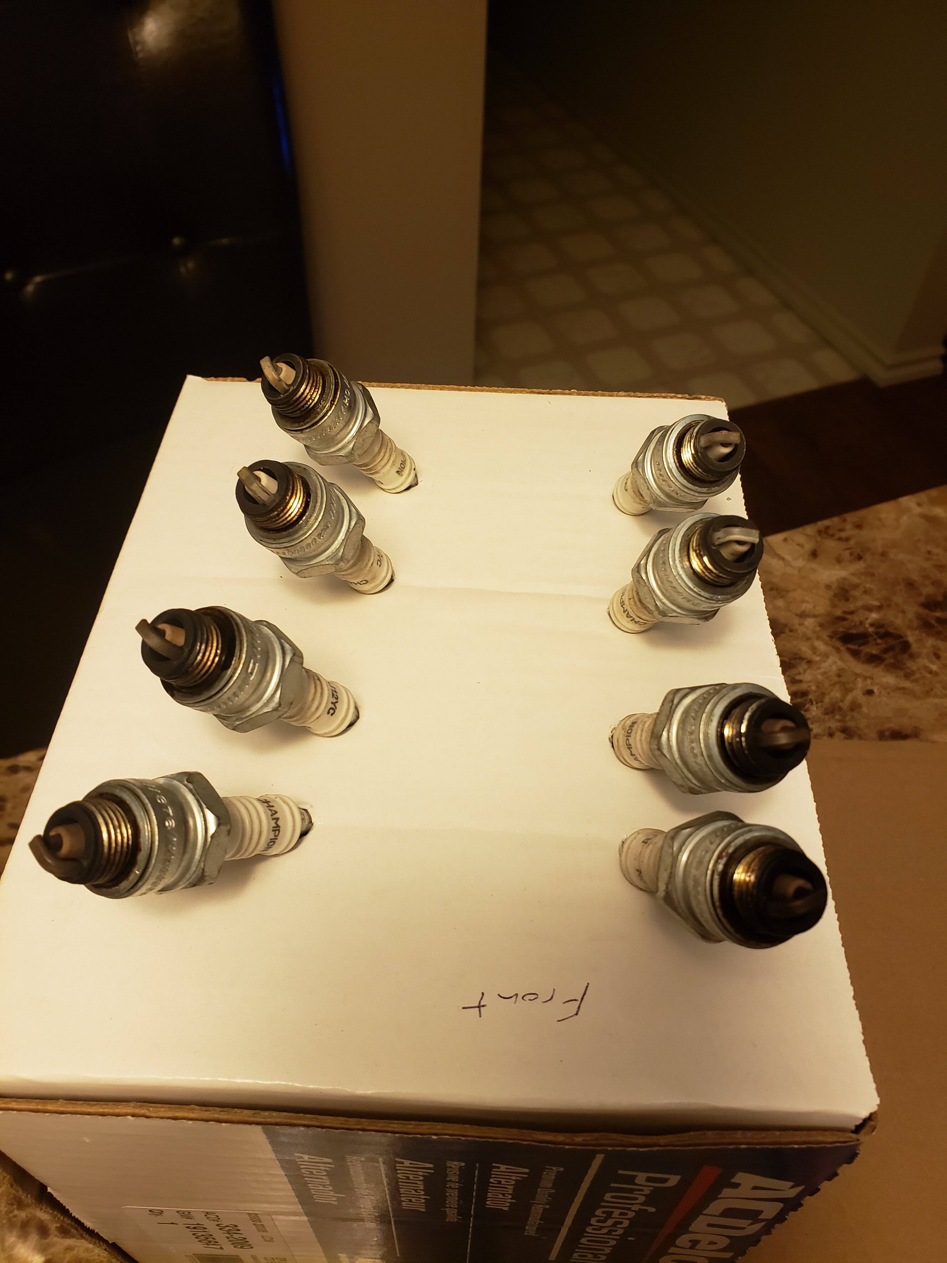

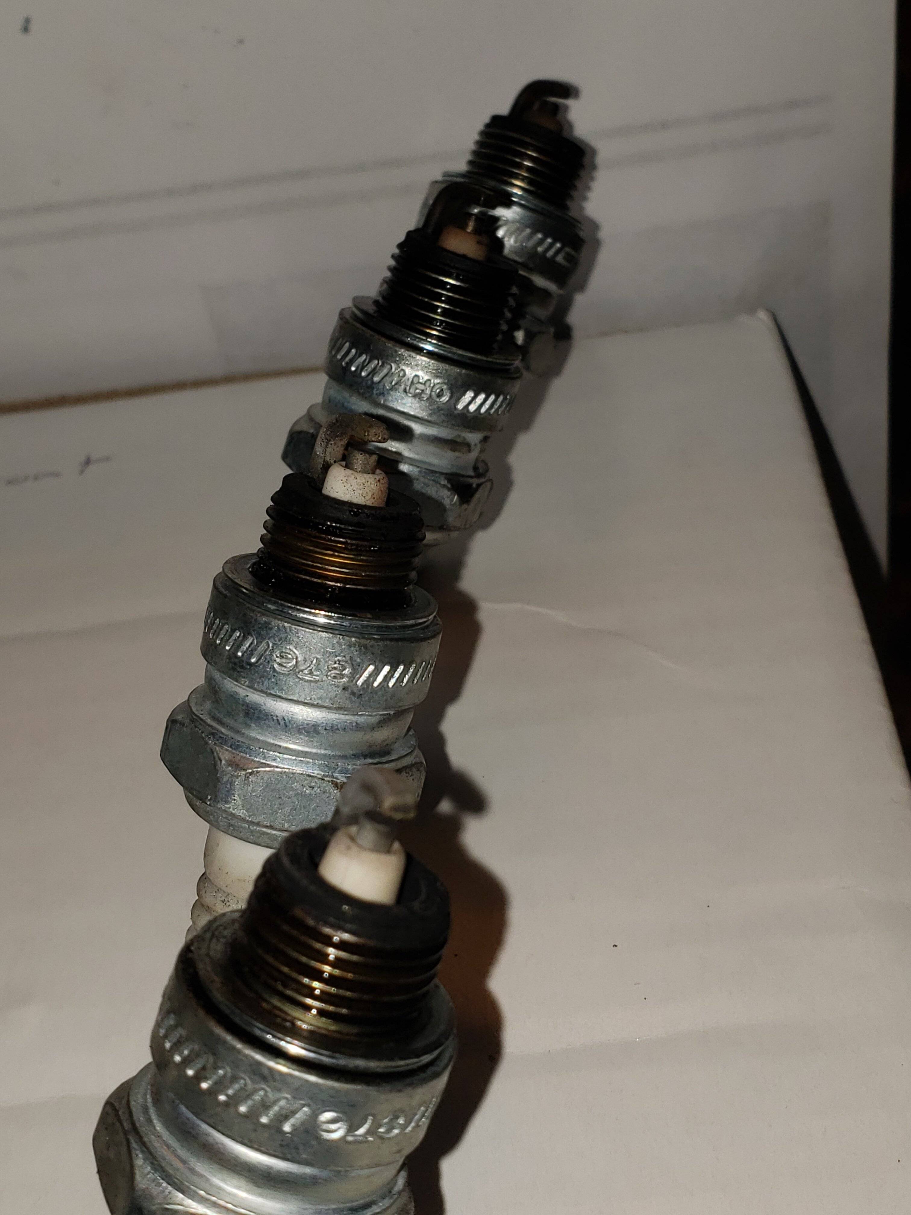

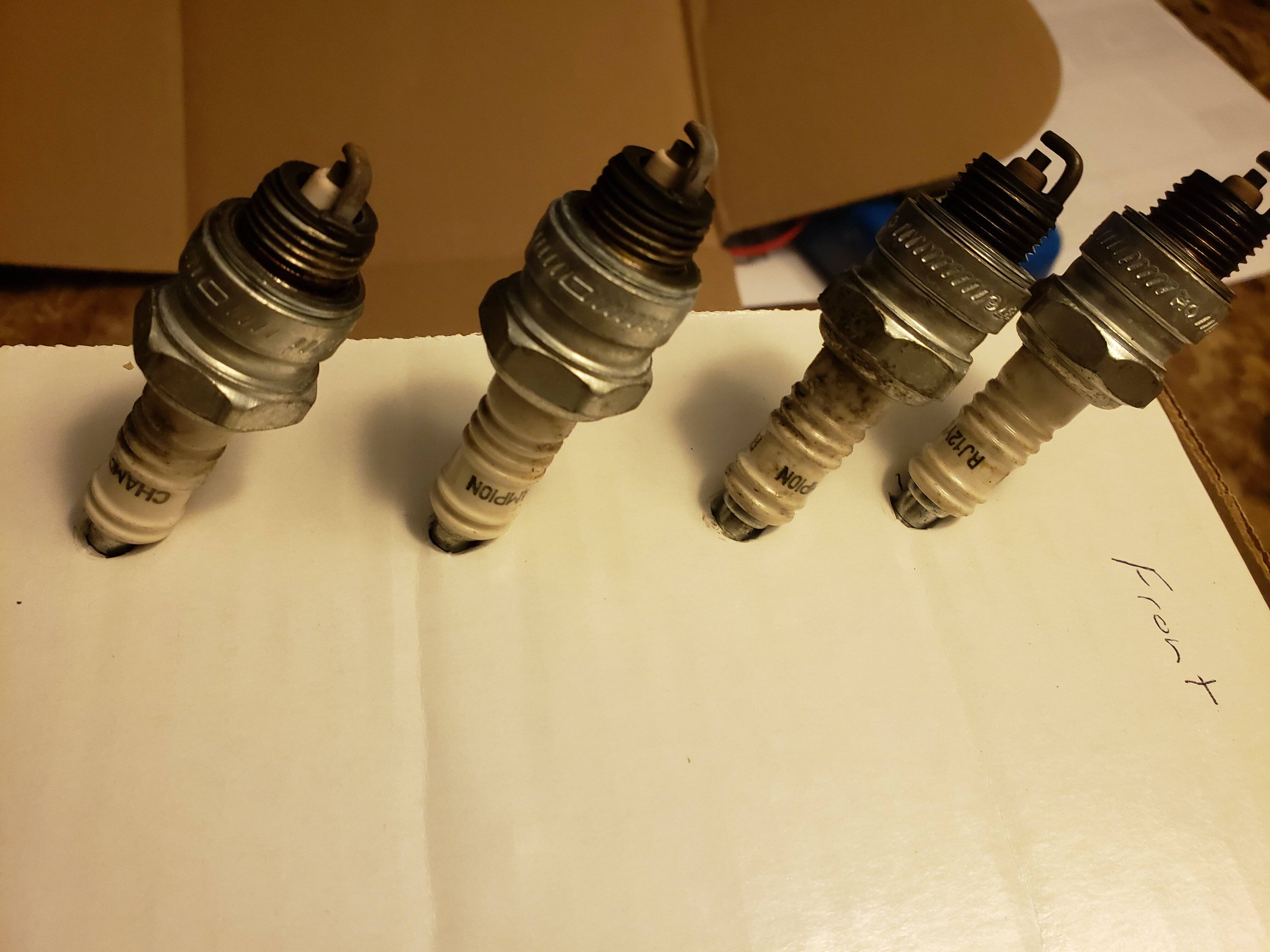

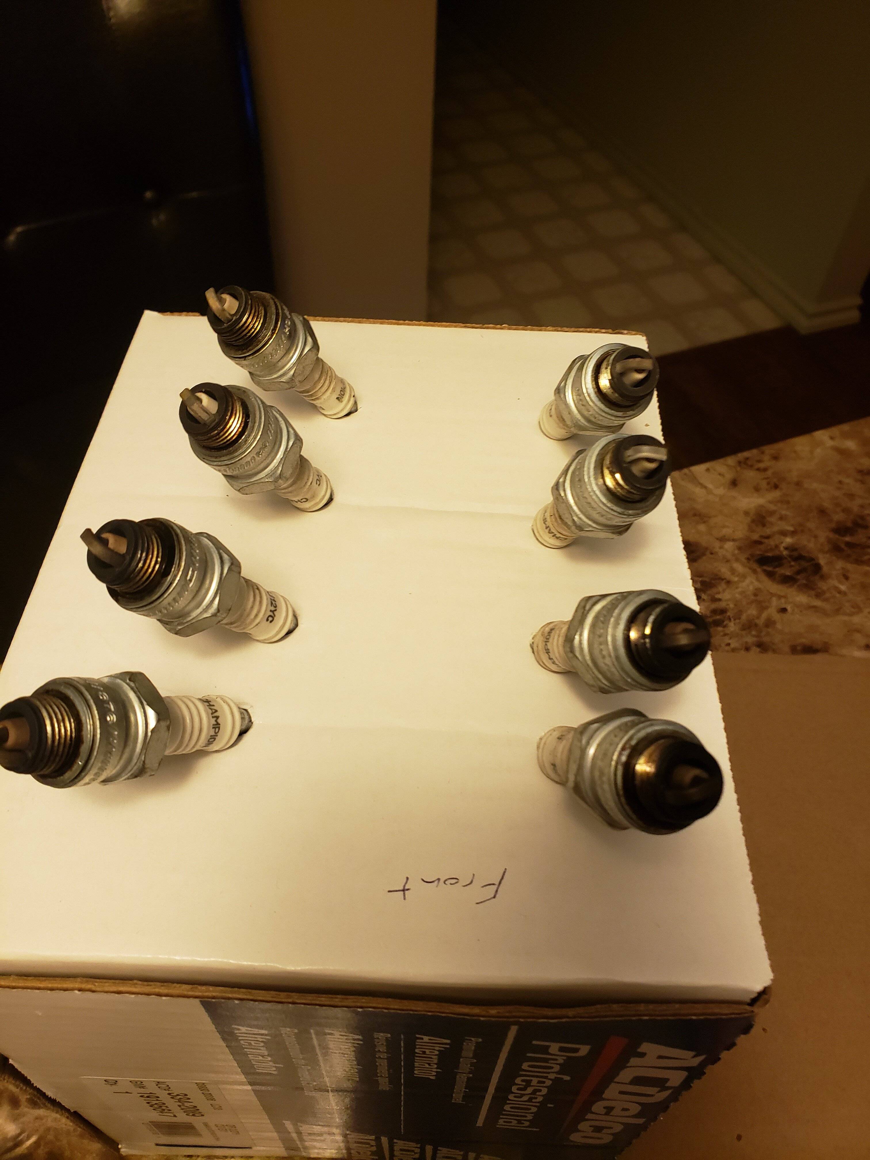

Front drivers plug was wet with gas and second from front had little smell of gas. How can I fix this one cylinder? Here's pics. Anyone else see anything I should be concerned with?

I had a 440+6 in a 69 Barracuda and had problems fouling the plugs. Would run great one day like crap the next. I did not have a good body to engine ground, junkyard ground strap cleared up my plugs immediately. Moral of the story, a weak spark, for whatever reason can cause headaches in tuning.
Many 6 packs run "fat" and plug fouling is relatively common unless you can really dial in the carb set. It takes some time and experience to get them sorted but its work the effort. A good O2 gauge is very helpful in the process.
He said that 1 plug was wet... that is why I suggested that he swap that plug, restart and check it again. If same hole is wet, ignition.
New parts don't always work properly. Verify by this simple test.
New plugs, cables and cap . And its running as good as when I got it in January.
