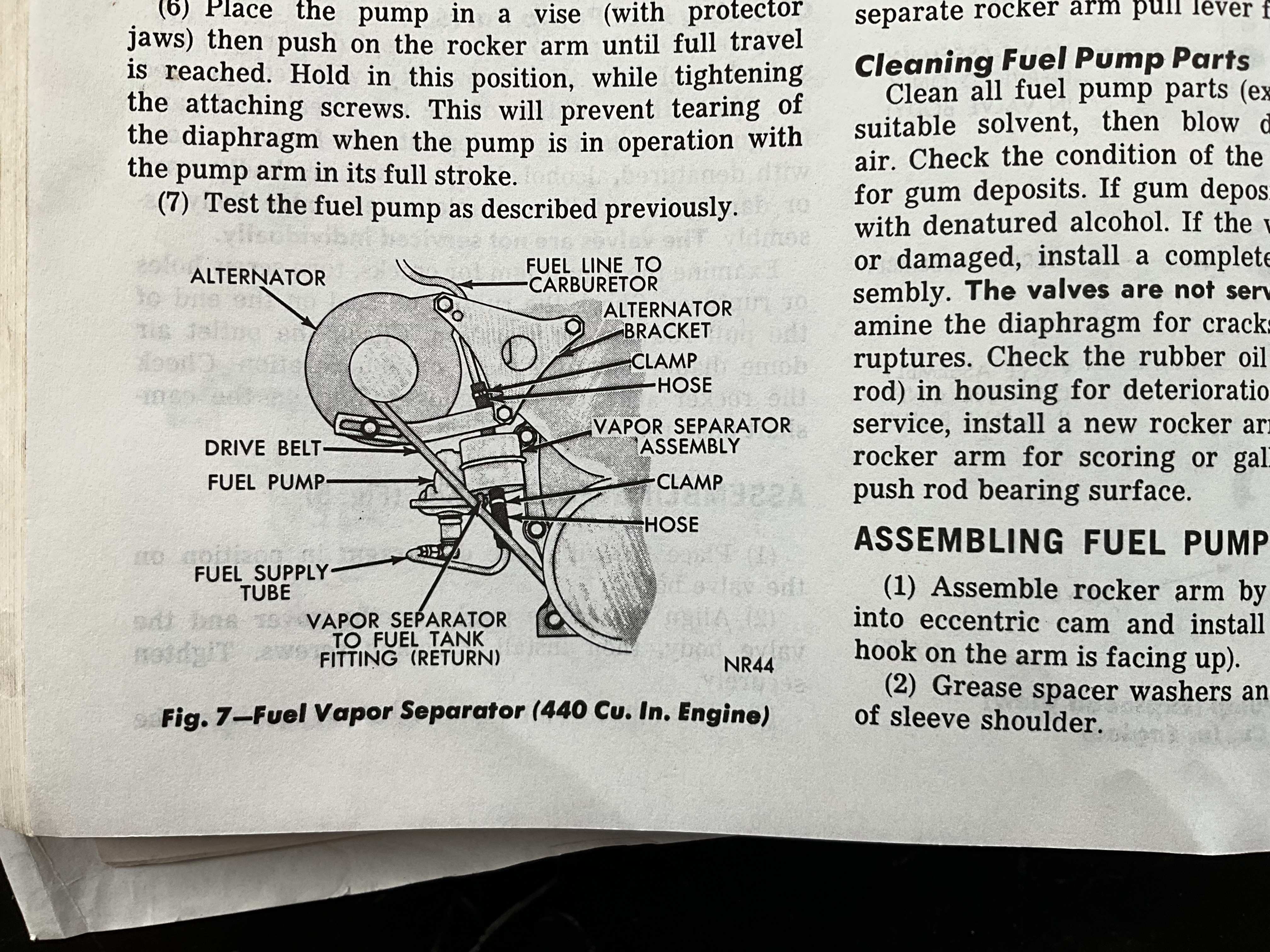

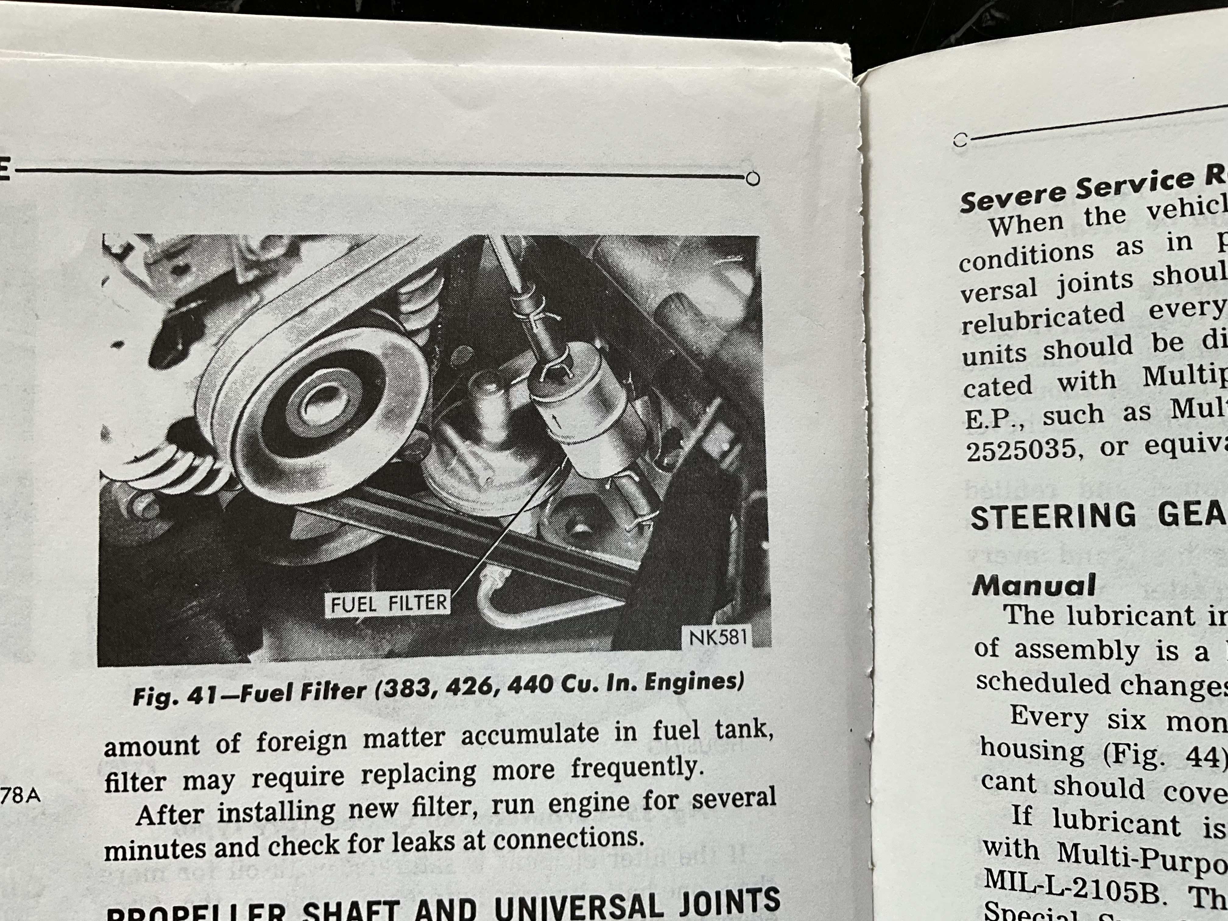

I finally pulled out the service manual but of course its very confusing.
In the “Maintenance” section is show a fuel filter, but not the vapor separator.
In the “Fuel” section is only shows the vapor separator.
My Dave Wise manual is not clear if there is a filter, or not.
Can anyone confirm if a 1970 440 4bbl AVS does, or does not, have a discrete fuel filter between the carb and vapor separator?
If the factory didn’t use a filter, looks like they relied on the vapor separator screen, but that seems risky on a high performance engine.

Looks like the vapor separator does its job….
But my question is did the 1970 440 engine also come with a fuel filter after the vapor separator? From the factory. It’s confusing from the manuals and resto guides

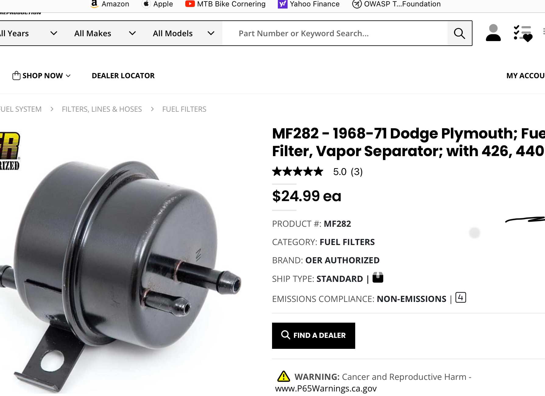

OK. As is OER description of the part, it is a fuel filter and vapor separator in one unit, as was the factory assy. No need for an "add on".
