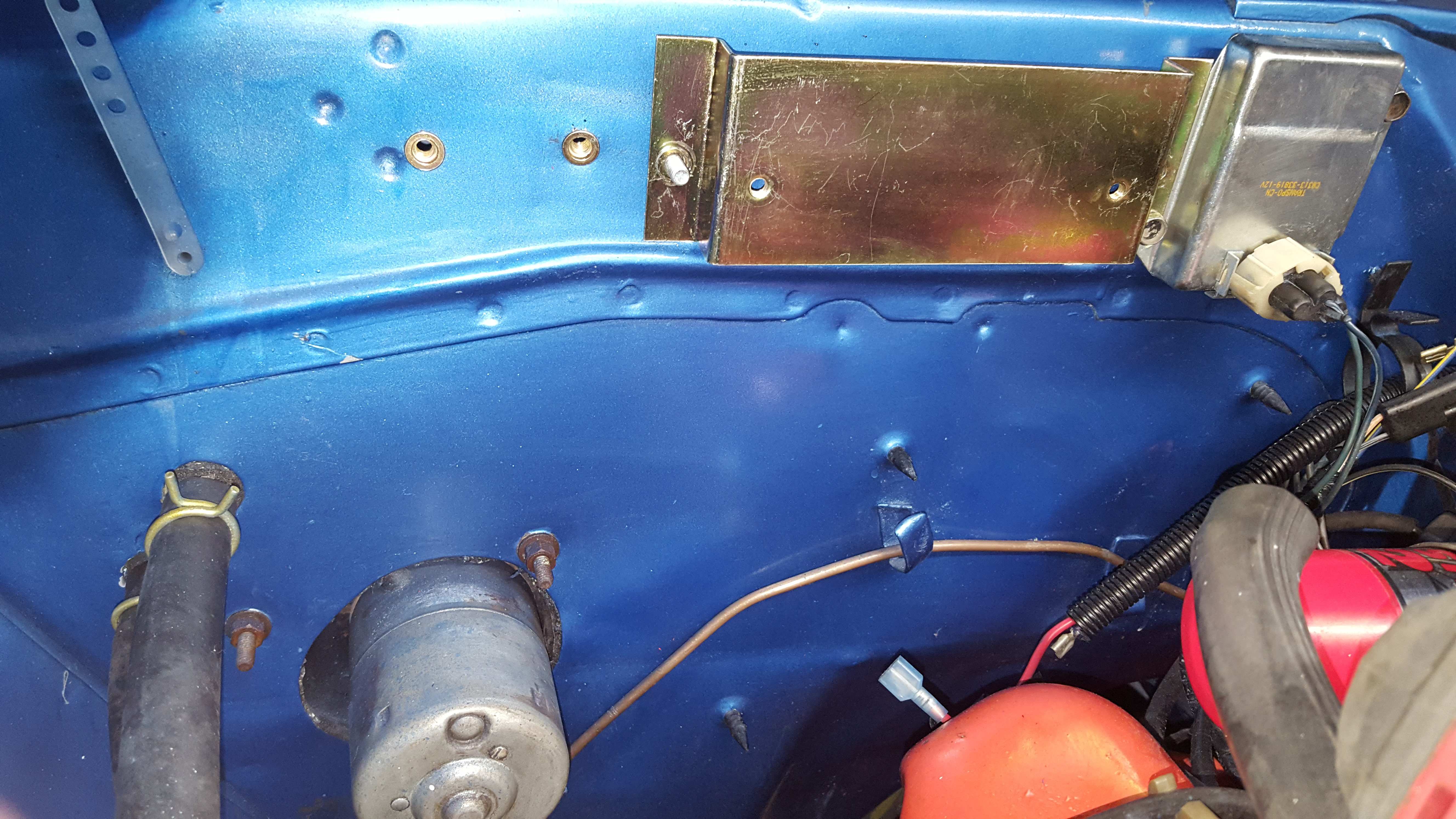

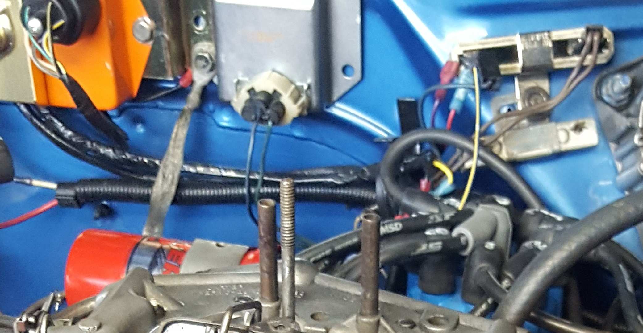

See the ECU from Mancini below. I know they will stand behind their products. Get the standoff plate too and mount it on the firewall like the 72-74 E-Bodies. Won't be hidden, but won't give you problems either!
If you really want to hide the ECU, I suggest either in the glove box (although it's cardboard) or somewhere hidden under the dash. Make sure the ECU body has a good ground!
