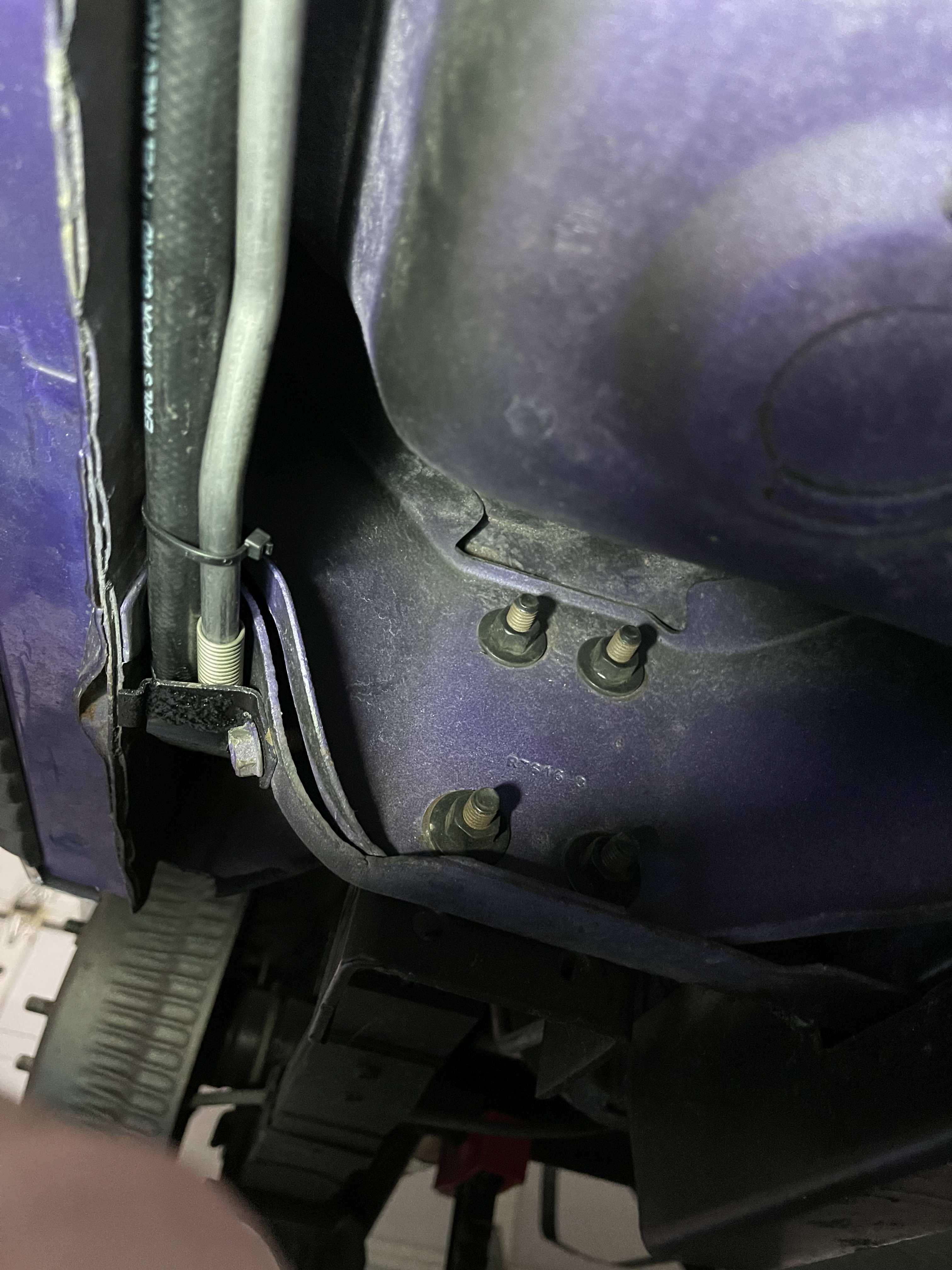

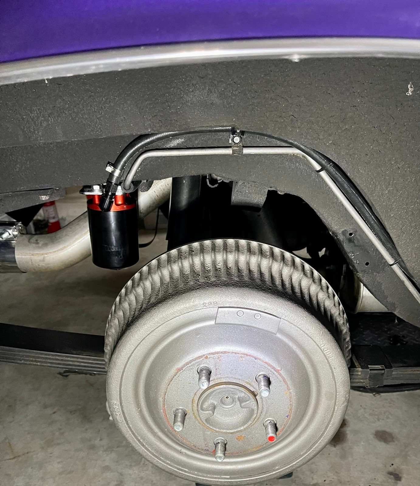

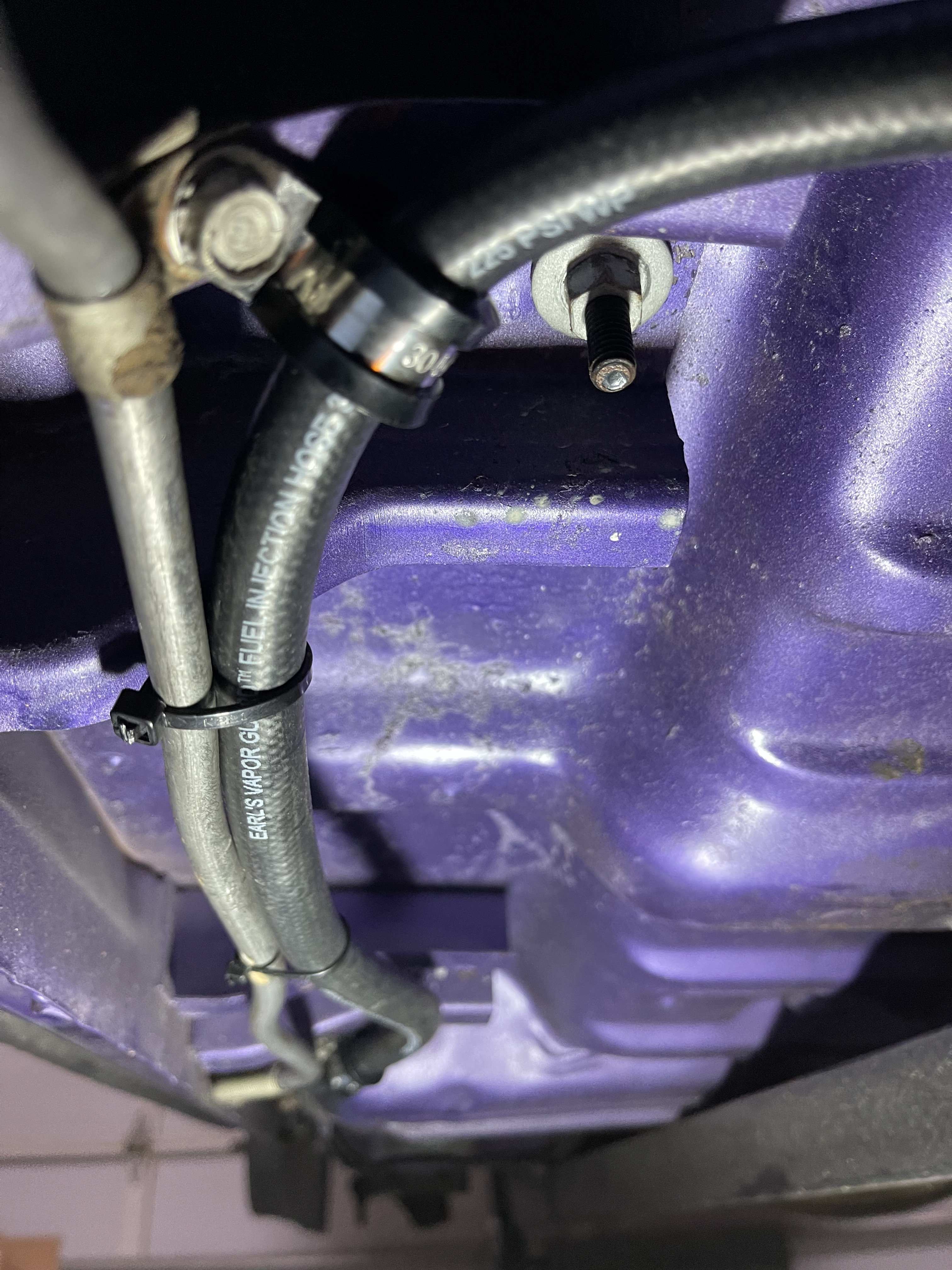

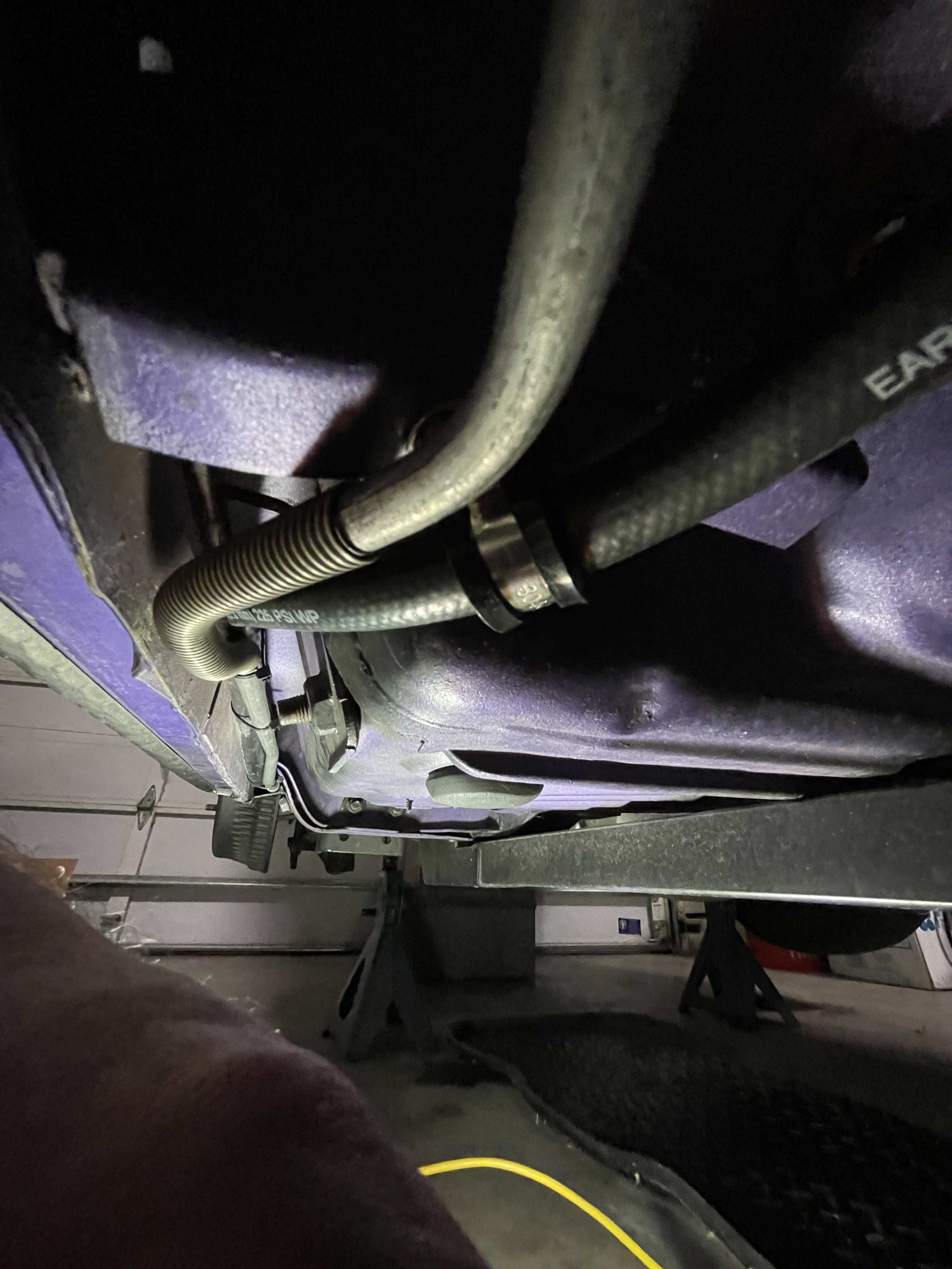

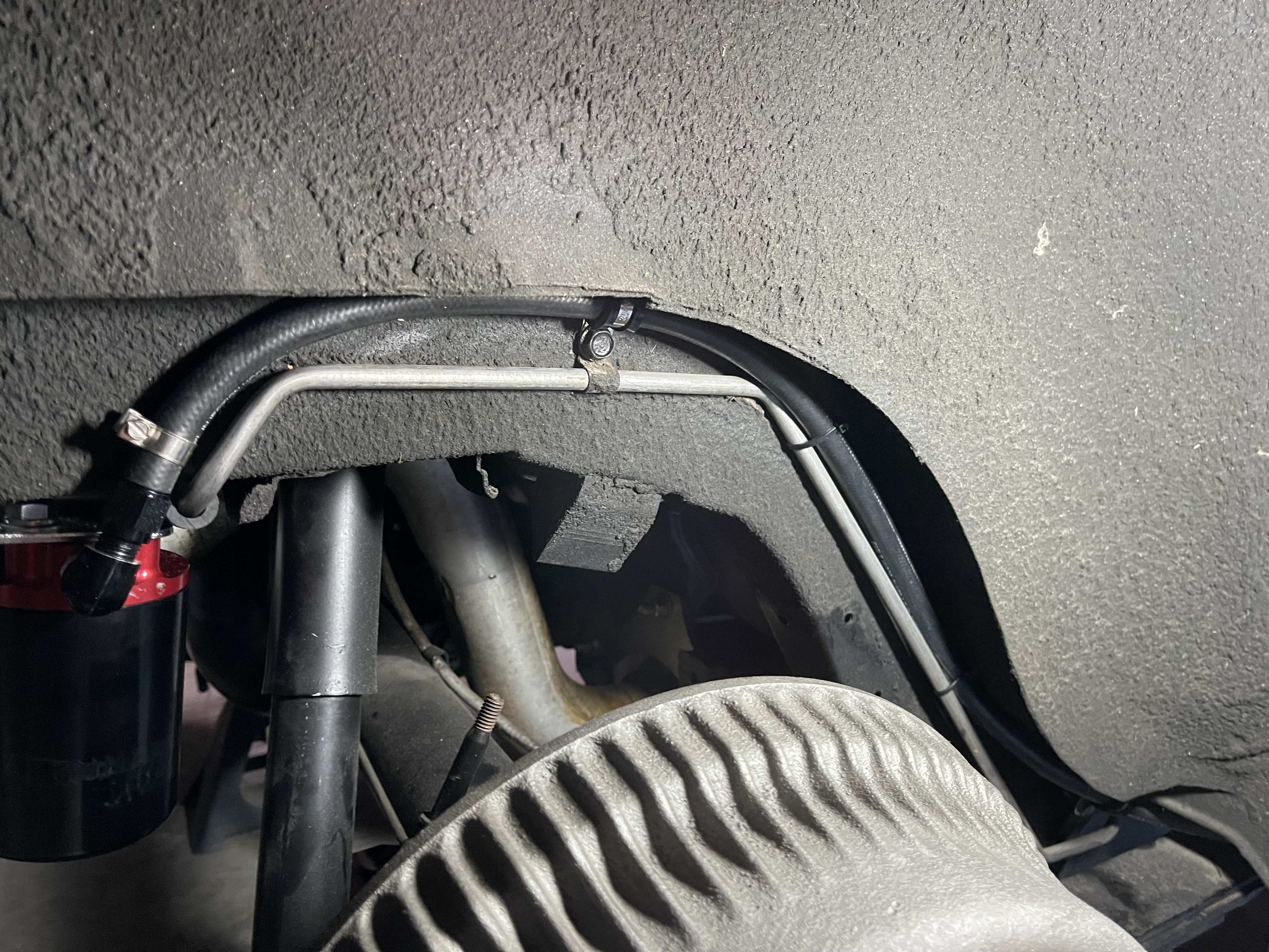

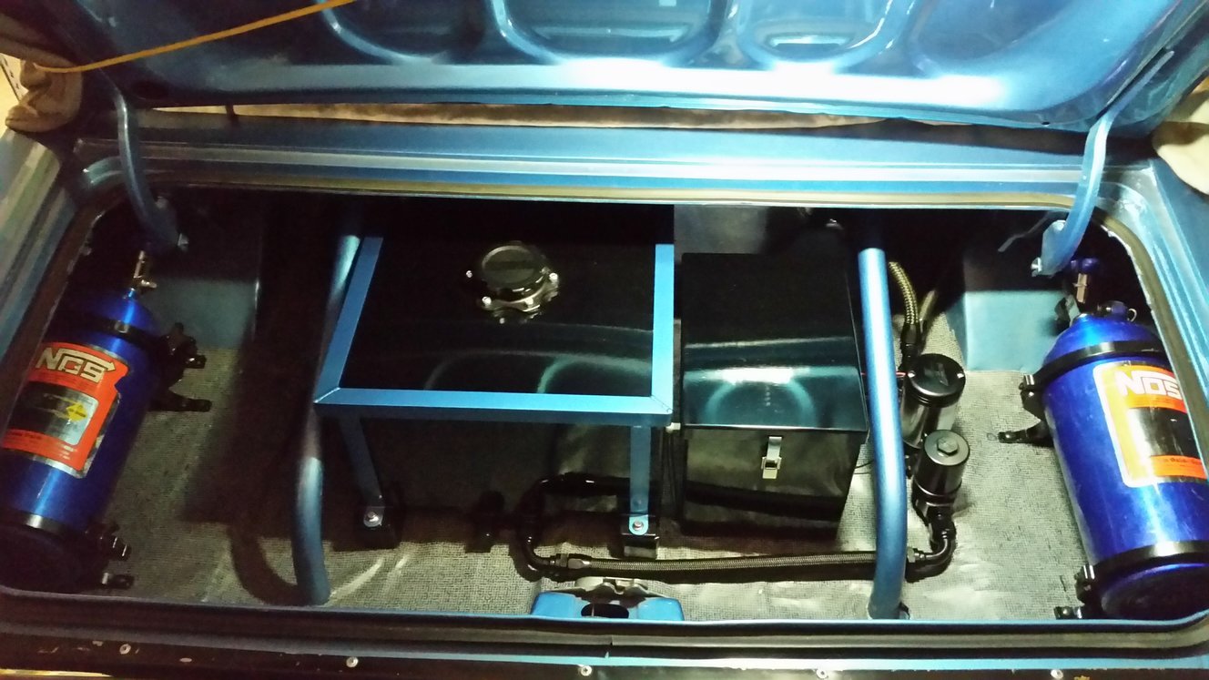

A few photos of the EFI rubber fuel supply line (3/8" ID) routing alongside the factory steel 3/8" OD line repurposed as the return line.

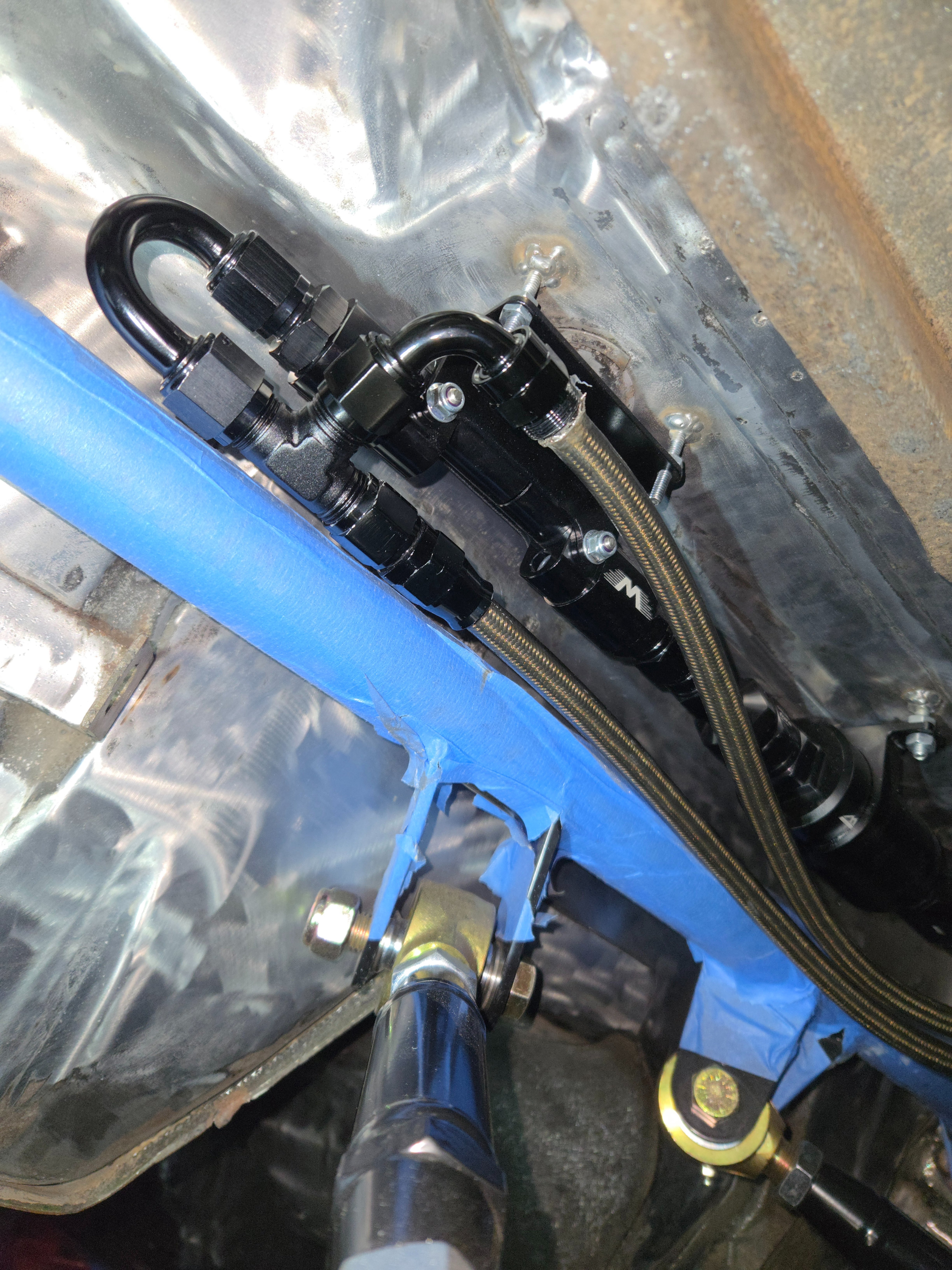

Any reason I shouldn't use a tee over a wye? Dual pumps feeding into one line. I have a wye, but routing looks much cleaner and easier this way. The PTFE isnt as forgiving as regular rubber hose.
Fore Innovations makes a Y that has female -12 ORB ports with the duals running parallel. You would buy the fittings that adapt -12 ORB to -8 (in your case).
What's your plan to drive the dual fuel pumps? Can't see it in the pictures, but do you have a regulator as well?
Yeah, I Have fore fittings already, they make nice stuff.
My plan for the pumps is to run PWM. Tapped performance makes a nice wye harness so I can run two factory fuel pump control modules. When running a pwm setup, no external regulator is needed. With the right connectors on the pumps, it should be a plug and play set up.
I'm also running an over pressure safety kit as well from protouringstore.com This will bleed off any built up fuel pressure cause by heat preventing hot start issues. I had Rick's tanks drill and extra hole for the jet in the fuel pump Hat.

Awesome - looks like you know what you're doing. I said regulator, but I meant it for use in the over pressure safety sense. Looks like we have basically the same build. I'm doing a Redeye with Tremec Magnum in a 70 Cuda.
I have -12 braided line run along the outside of my frame connectors with no issues from the fuel pump to my fuel log.
