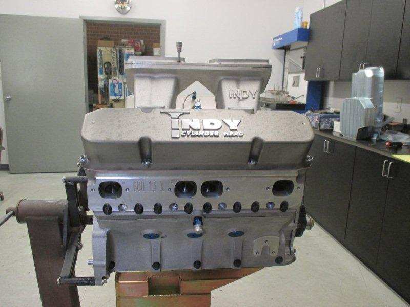

Maybe I'm lazy, but if I wanted Max Wedge flow, I'd just buy a pair of Indy or 270 TrickFlow heads and their intake and call it a day. Seems like a lot of work for something that will probably flow more than the "stock" head, but less than a "max wedge" type head. You could sale the two sets you have to help offset the cost of Indy or 270 Trick flow Heads.
