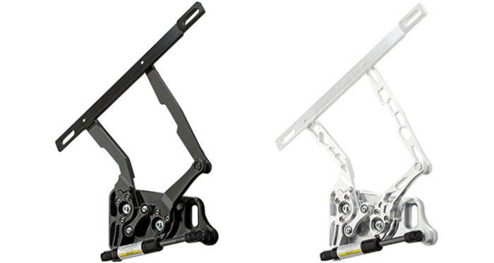

    Is anyone using gas struts to support your hood open? I've got a fiberglass AAR hood and the stock springs are too strong. I know that there are special springs for the fiberglass hoods but I thought it would be an opportunity to use a gas strut instead.

    They look like really good quality items and will make hood adjustment a lot easier without the slop normally in the standard hinges.

    Yowza. Love my car, but I don't love it that much yet. If I do this in the near future, it will have to be a cobbled system if that is the only aftermarket available. Looks like the A-body can be done relatively easy using modified stock parts. I'm going to have to see what it would take to modify the hinge. Making new hinges isn't out of the question either, but that is probably more work than I want to get into.

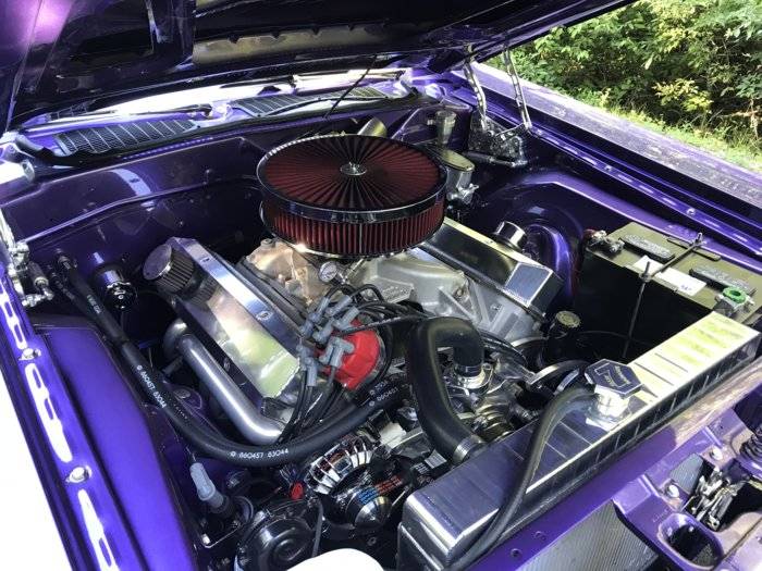

    CD79A04D-2AA0-4304-BAA8-5008DB15B64A.jpeg here they are on my car

    They certainly are nice, but with where my car is at the moment would be lipstick on a pig. Was really wanting them for the functionality aspect and hopefully less stress on the hood.
