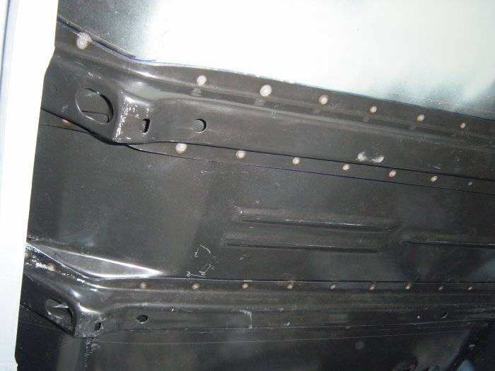

Apr 9, 2017 #1 T topbanna70 Active Member Joined Aug 16, 2015 Messages 35 Reaction score 2 Does anyone know the measurements of where to weld on these braces that the fuel tank straps clip and bolt into to support and hold the tank up?
Apr 9, 2017 #2 Adam Well-Known Member Joined Dec 25, 2012 Messages 1,695 Reaction score 760 Location Washington The centers of my gas tank straps are about 9 1/4 inches apart. If you look at the bottom of the trunk pan you will see kind of where they go... just mock it up with your gas tank to make sure it all fits.
Apr 9, 2017 #3 T topbanna70 Active Member Joined Aug 16, 2015 Messages 35 Reaction score 2 Thank you Adam for the info
