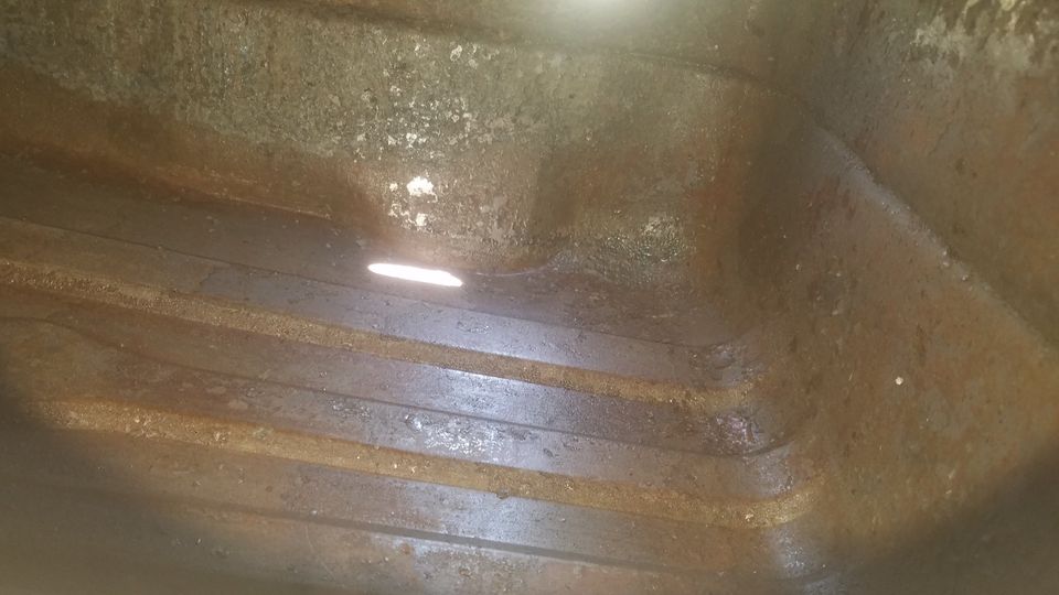

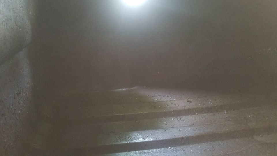

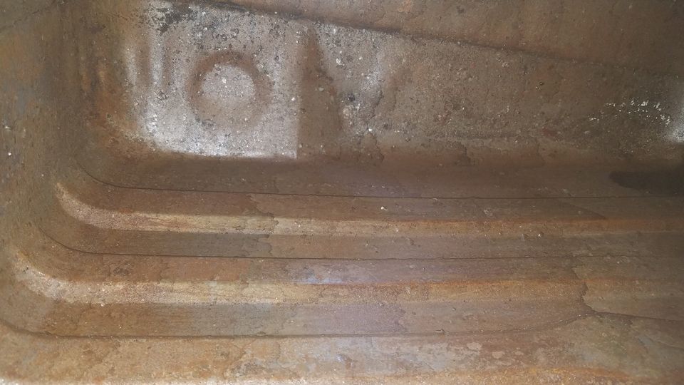

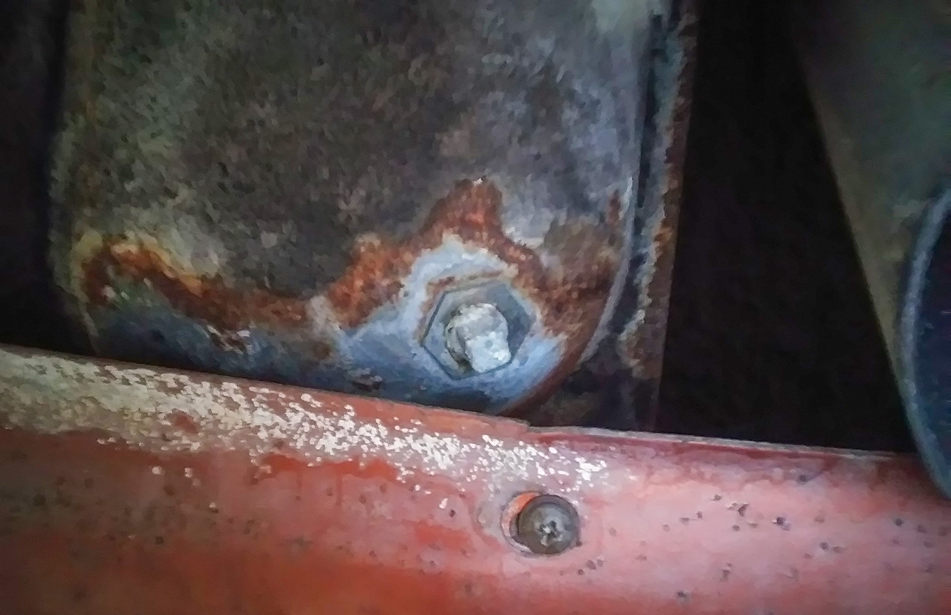

Looked it over with a boroscope with an articulating head. Its a little crusty and I'd be inclined to use a company that specializes in gas tank renewal to keep the drain option.
Was initially surprised it was there, but do seem to recall tank drains were somewhat around back then..
I'm determined to keep it..

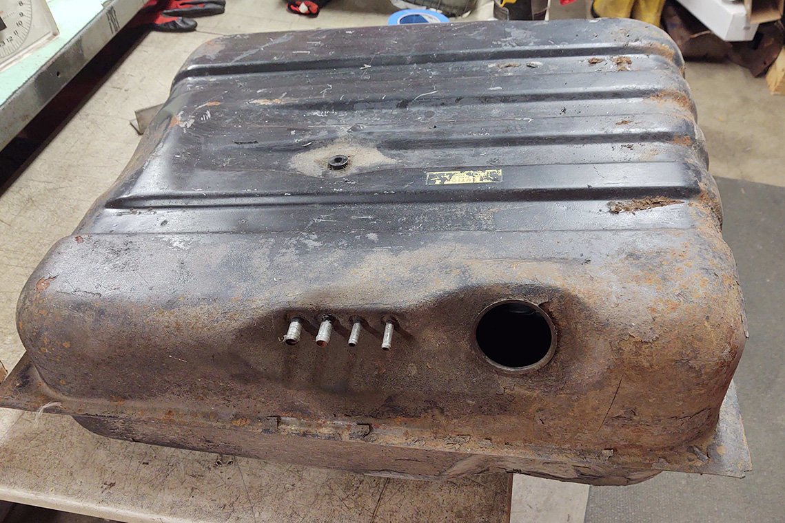

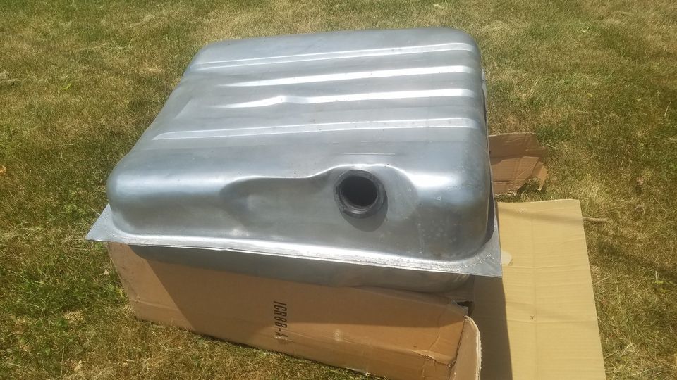

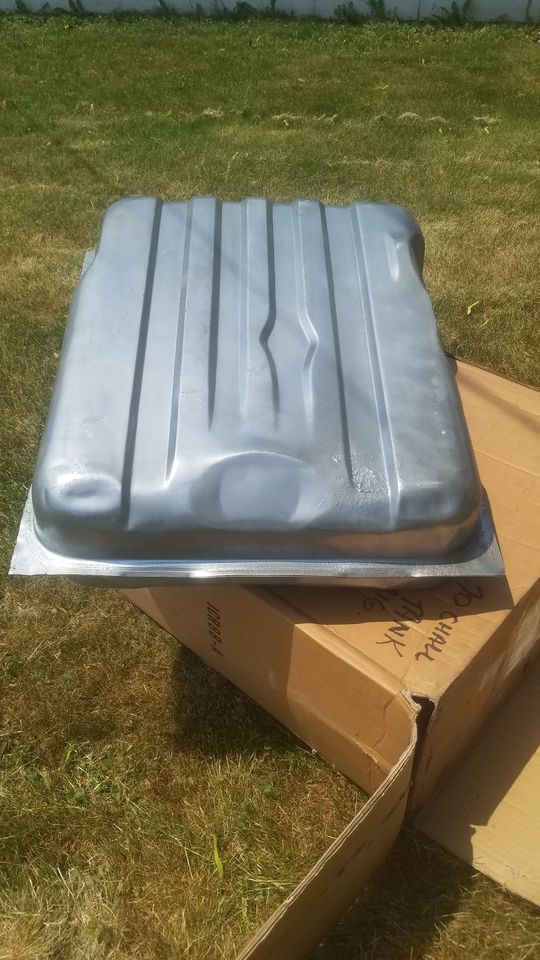

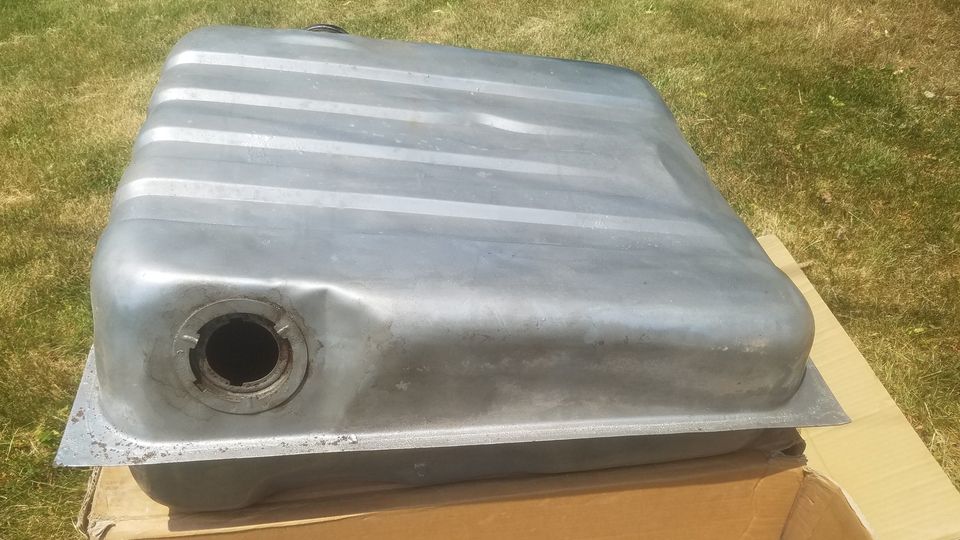

Pulled this image from a thread right below mine. Claimed an original from a 70 Challenger. Looks like it has a drain in the center..

The 1970 Challenger did not have a fuel tank drain plug from the factory. Chrysler products had not used drain plugs since the late 1950s. The drain plug in the pictured tank was added.

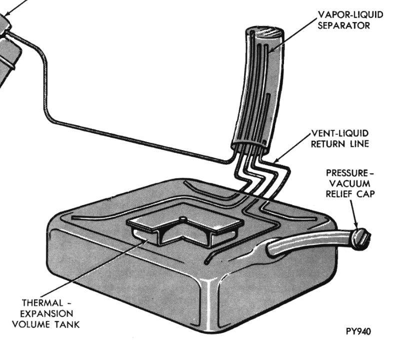

The tank shown in this image is a 1970 (California) or 1971 Challenger tank configured for the Evaporative Control System (ECS). ECS was part of Chrysler's Vapor Saver System which was a step in the evolution of their Cleaner Air System (CAS).

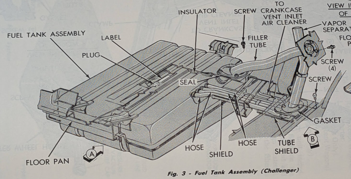

The four tubes on the side are the vent tubes, to collect vapors, which lead to the vapor separator. The tank is shown with the top up. The plug in the top is a part of the internal thermal expansion tank as shown in the following images. It is a way to drain the inner tank if the main tank is removed, not a main tank drain plug, which is drained through the filler tube opening with the tank removed.
The following image shows the tank label:
