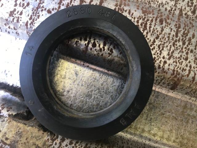

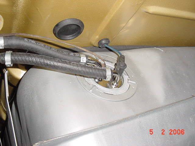

Pic of my original sending unit, gas tank grommet and what the 72 Challenger sending unit looks like after replacement;

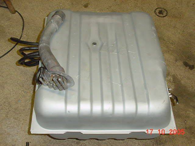

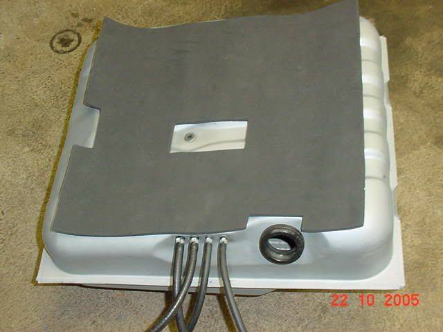

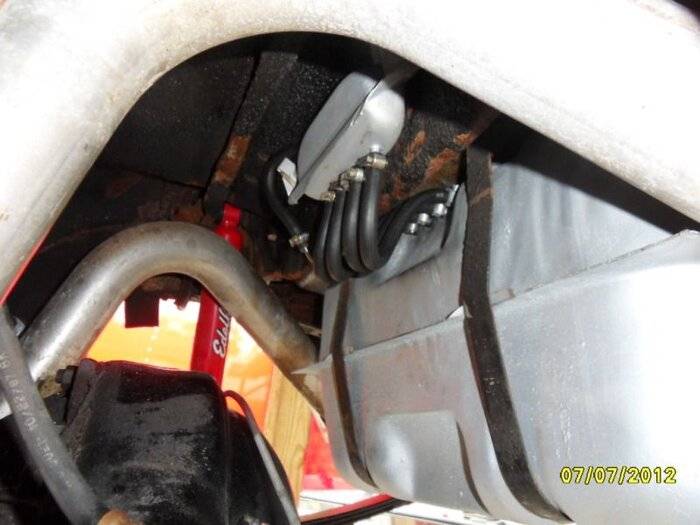

Some last thoughts; new gas tank pad is also a good step; here is a pick of a 72 Challenger tank and vent lines, Not sure if your car is an early 72 or a late 72. Some early 72's still used the late 71 vent tube set up. Later, a small vapor separator was added to the rear shock cross member. The junction box is the 4 vent lines going in the bottom with a vent tube going out the top and up to the Charcoal Canister in the engine compartment. (pic below)

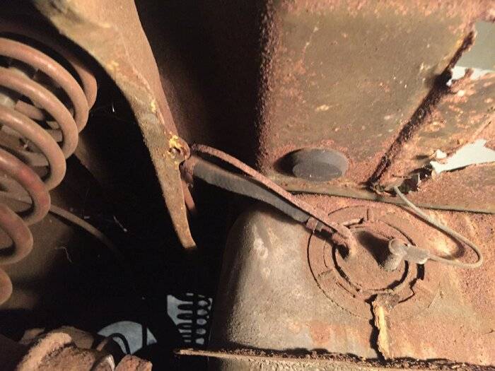

Appreciate the response @340! Few questions, that I may understand better once Im working on this issue.
1. Is this a front vent or a side vented tank? Confusing from the installed pics of new tank vs the un installed pics of tank. Looks like your sending unit is in the rear so Im thinking you have a front vented.
2. What is the long steel tube with the 4/5 smaller barb fittings sitting on the the uninstalled tank in 1st pic of 2nd reply?
3. Would it make sense to remove the rear bumper? Could it be done without this bumper removed as I feel we may open a can of worms.
Car is old and know it will need work so I wanted to get it running, a small tune to see what else is needed before we tear it apart this Winter if need be. Gas tank is necessary as it was leaking from the bottom so all fuel is out of it.
Thanks again.
Filler neck slides in the passenger side , sending unit is on the drivers side , if you have 4 vent lines they come out the front above the differential
The large tube with the 4 “barbed fittings“ is your fuel filler tube on the passenger quarter to the tank. Your car is a relatively early 71 October build, it might not have the vapor separator on the shock cross member toward the front of the tank. I would get under there to see what you have? You can get at the tank bolts without removing the bumper or valance; though it makes the job a little easier, IMO
As Chrysler said, filler tube on passenger side, sending unit on the driver side. Vents lines are on the right side of the tank.
