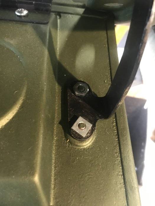

Glove box door arm nuts?
scottylack
Sep 11, 2009
88
8
What nuts attach this arm to the glove box. I’ve been able to find nothing that works. Or is it a pension nut?
scottylack
Sep 11, 2009
88
8
Where would I get these acorn nuts? And do you know what size they would be?
HooToTheCore
Apr 4, 2016
194
78
Charlottesville, VA
They are supposed to be black acorn shaped nuts, but they are the cheesy kind (hollow sheet metal) that strip the threads on your door studs and will not tighten. A real PITA.
rklein71
Feb 27, 2015
1,236
597
Amarillo Texas
Maybe you could buy quality acorn nuts and paint them black.
scottylack
Sep 11, 2009
88
8
Thanks for the offers I found some decent ones that fit. Not doing 100 point restoration but I appreciate it
Steve340
Sep 19, 2016
1,054
446
New Zealand
Those nuts are 8-32 UNC for future reference.
The threads of the little stud can be damaged by the pressed steel speed nut.
scottylack
Sep 11, 2009
88
8
gotcha...yes, thats what I used. The regular nuts I used didnt work well, but the acorn nuts grabbed and held
