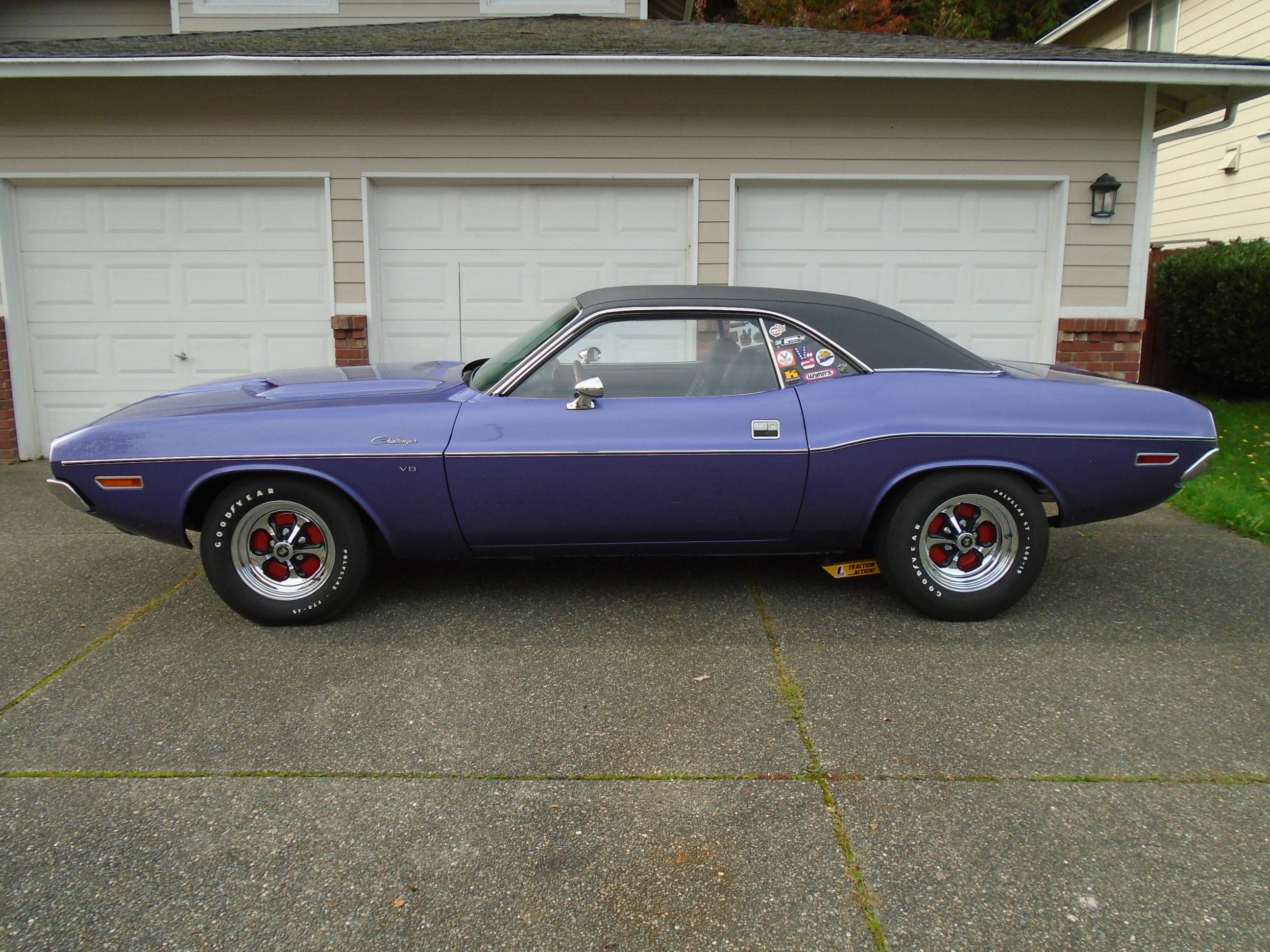

I definitely believe I’ll be going to the equivalent size of the G-60 in the rear and E-60 in the front. I just can’t fall in love with the Firestone wide oval, mainly cause it says “wide oval”. The poly glass looks sooo good. Maybe I’ll put a set of polyglas on my rallye wheels after I buy them and keep the T/A BFG on these mopar cop wheels, albeit with smaller sizes.
NUFF SAID...

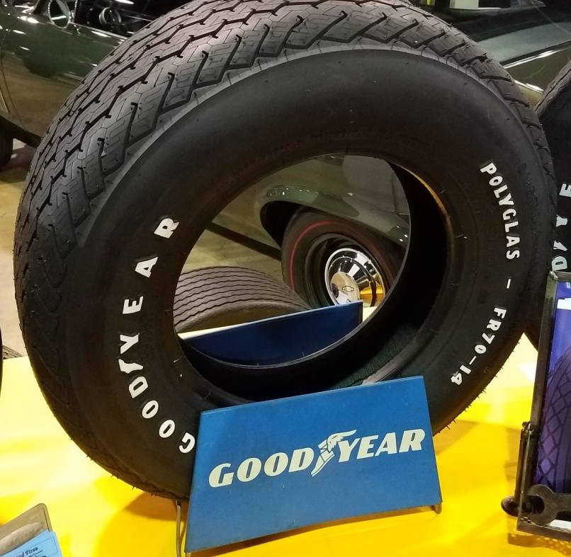

I’m interested in switching tires to the original look of Good Year raised letter F70-15 Polyglas from the current BF Goodrich radials. I don’t drive the car much other than Car shows and some occasional Sunday drive(s). I know the ride won’t be as good as the radial, but, the look is what I’m after. Any suggestions on where to purchase and any
specs ?
Thanks in advance for your help !

IMO no ,only if your car is a trailer queen & original .
Of course I am no fan of BFG either after all of the failures I have seen .

It was restored in 2012, original drive train, not a trailer queen. I saw there are radials that have the same Good Year raised letter but have F70R.

A small letter Good Year radial could be a good choice if it made well .
A friend has Good Year bias tires with no miles on them & they are coming apart just sitting there .

If your looking for professional advice you need to talk to Rusty 816-654-3400. He is a retailer for Kelsey tires who make the repop's but is a straight shooter and knows all the goings on concerning retro tires.
It seems like a no brainer to do with the 15" Poly-glass like Cooker did with the
Wide Oval. Kelsey tried with the 14" using a modern tread design not the bias-ply look Cooker did
because Goodyear Corp. still has a say in what they put their name on according to him.
Like anything else, there needs to be ground swell of support for it to happen but if you
decide to go with them he can get you the best price.
