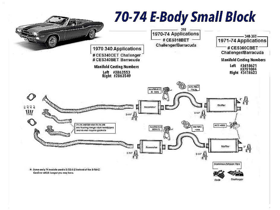

Hi, I'm wanting to do exactly what you did with your 318 exhaust. Please let me know what you did from the stock OEM manifold back. Size of pipe used, H or X cross overs, etc.

To start are the manifolds stock. That's what you have to match the head pipes to. You can do X , H pipe but not stock on the small block. It's a matter of preference. For dual exhaust the driver's side mounting bracket for resonator and muffler hangers will have to be installed. All depending if your installing a complete factory exhaust. L-R head pipe, resonators Driver side hanger mount, L -R hangers, over axle pipes mufflers and L- R trunk mount bracket and hangers. And of course clamps.

Thank you for info. Would Love to see how 74 Challenger’s dual system was designed.
