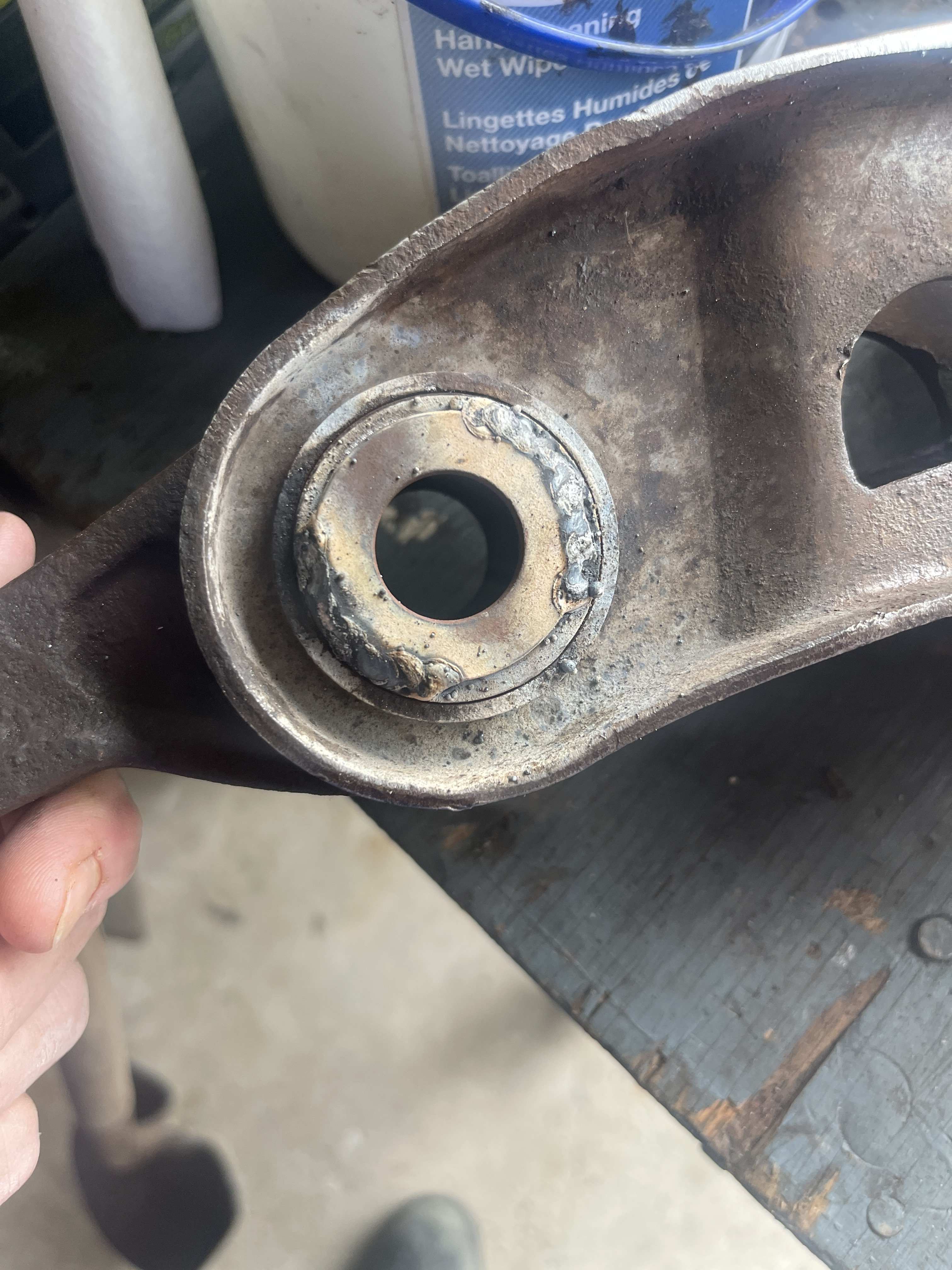

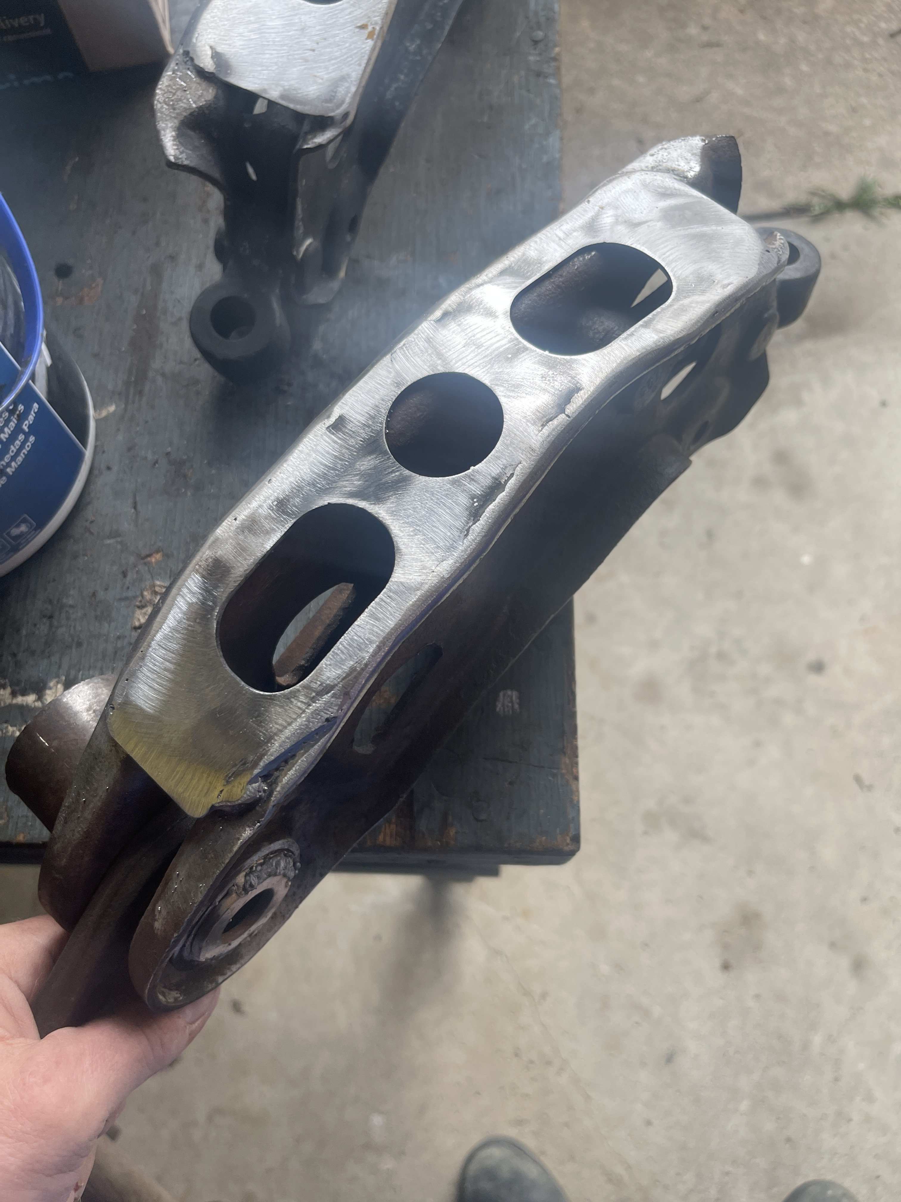

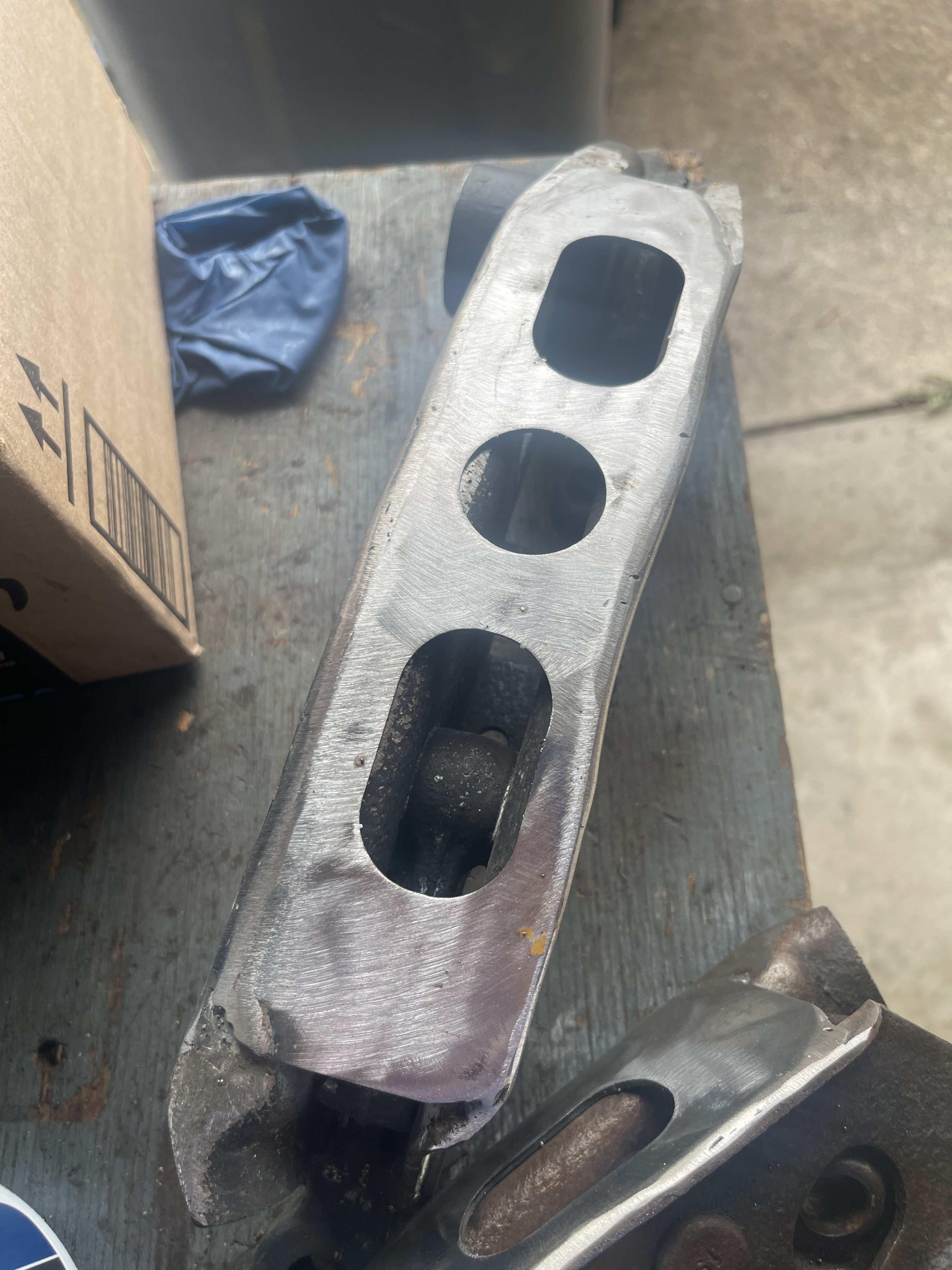

Got LCA’s back from welding.
Mar 27, 2025
17
10
Grand Island, NY
I received the LCA’s from welding on the plates, and they came out great!
I had him do the washer trick and will press out the bushing housing today

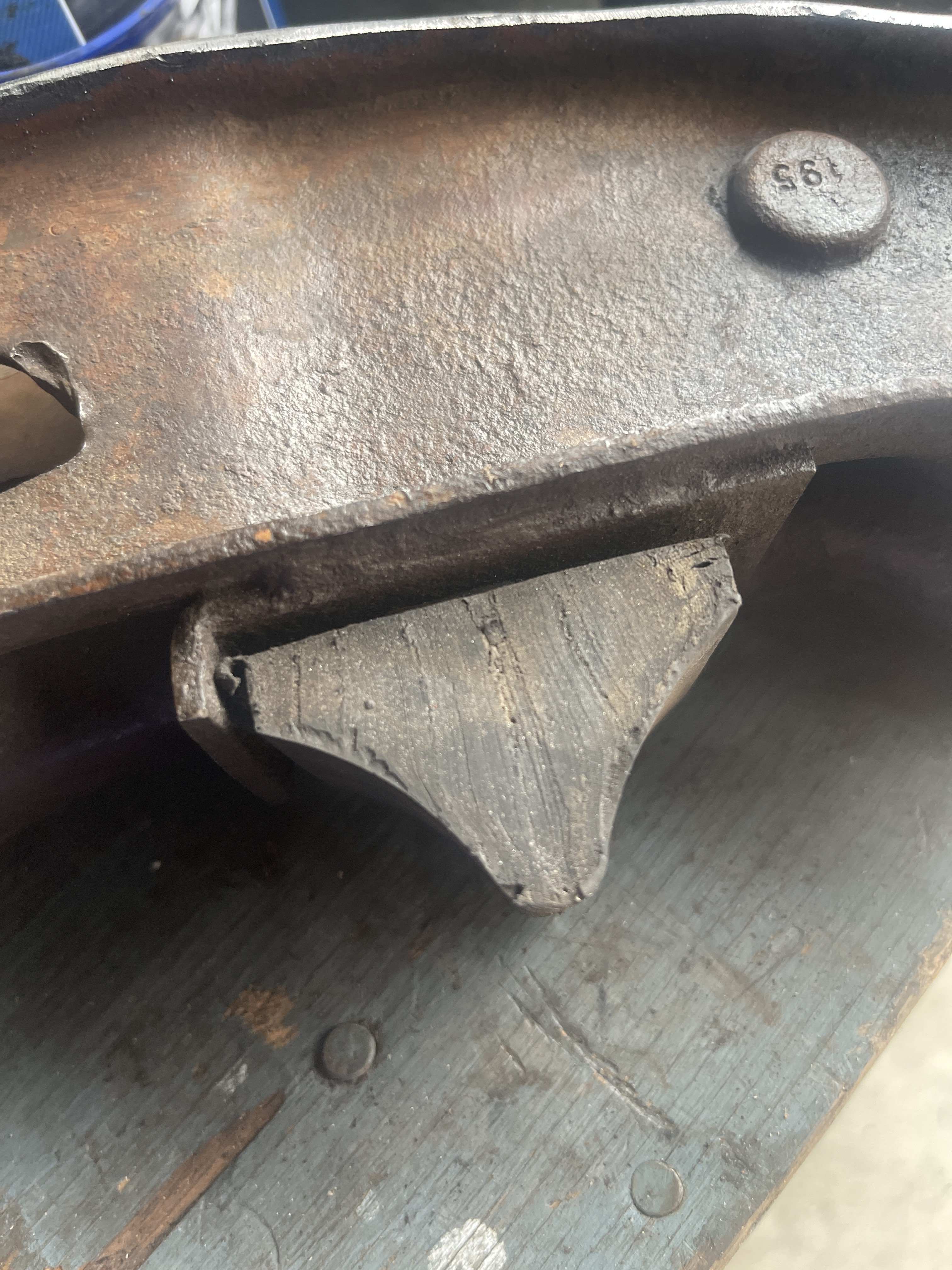

The rubber bumper is junk and a new one has been ordered.
