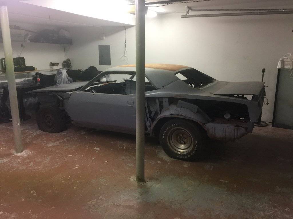

This is my 70 Cuda.
Nothing special about her other than the fact that she is mine and all mine.
This is the only car that i have ever wanted on earth and i was lucky enough to find her.
Rust Bucket?... Yes
New Everything?... Yes
Only thing SOLID on this car was the foundation, and that is why I acquired her.

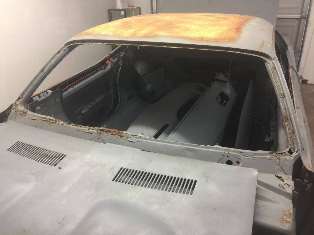

This is my first project that I'm undertaking:
Yes, I know its a lot, but I am not in a hurry, and I know I will get frustrated at times but I am determined to get her up and running under her own power. Most importantly my wife is a car girl, and is actually on board with me on this one, (so long as I promise to do one for her once I'm finish with mine:)) and I have all of you V.O.E (Veteran's Of Ebodies) to look for with the guidance, advice, motivation, and at times "intestinal fortitude (balls;)) that I may sometimes need to continue this journey.
I am currently collecting parts, I have not started the process of the rebuild just yet, I'm still trying to gather all the info, materials and anything else needed to undertake this project. If anyone can refer me to another thread that has done a car in this condition then I would greatly appreciate a link or anything and everything useful pertaining to this kind of restoration. I don't know much about any of this but I am a good listener, and a great learner when I put my mind to it, and I promise, that my mind is on this. So please don't shun me if I ask lots and lots of questions pertaining to random things. I'm honestly just trying to learn things as I go or i'm looking for guidance, or I just don't know.

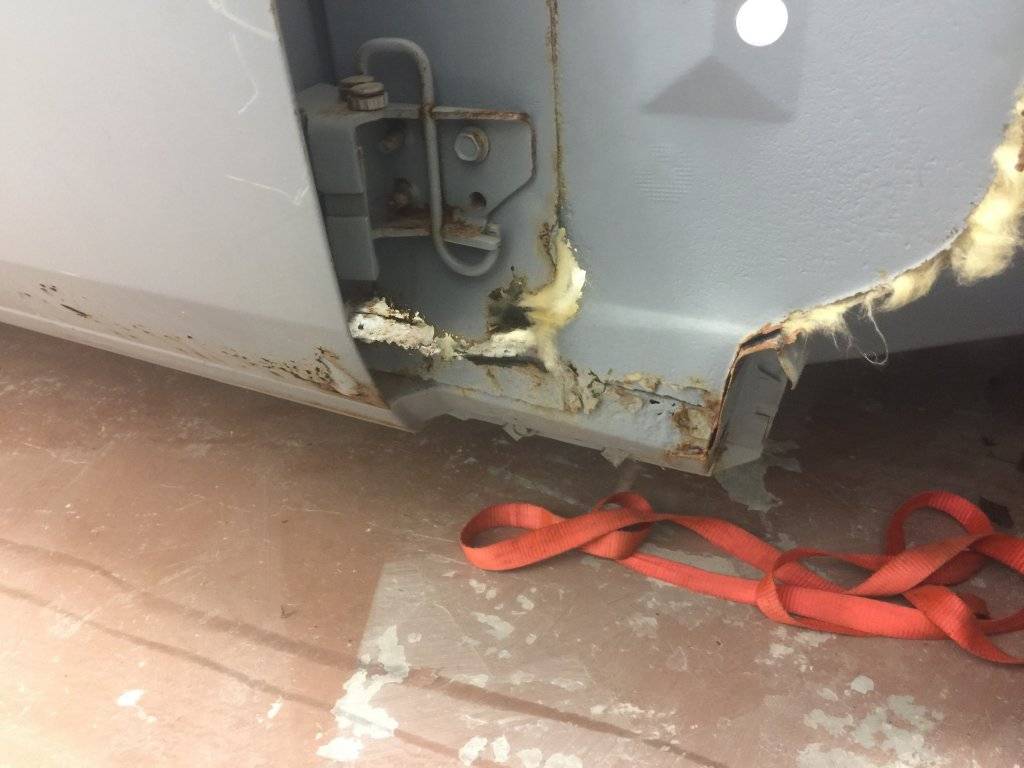

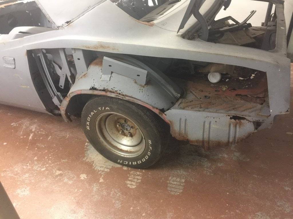

Welcome aboard Darryl! former 11B myself. I am assuming a lot here, but it looks like you will need to do some panel replacement; not that hard but can get tedious. 1. get a good drill and American made spot weld cutter like these: Spot Weld Cutter Drill Bits 3) 5/16 Inch Cobalt Made MadeInTheUSA.com. Chinese ones are cheaper, look good, but will not last, trust me.
2. You will need a little mig welder like a Lincoln 140 or similar... don't worry if you do not know how to weld, easy set up, and a little practice will take care of that.
3. Get a good 4 1/2 in angle grinder... Harbor Freight is good only for consumables like 40 grit flap discs, for dressing welds.
4. I have had good results with AMD replacement panels. All brands of panels will need something, IMO.
5. Form a plan like front to back, take pictures, measurements, and do one side at a time...

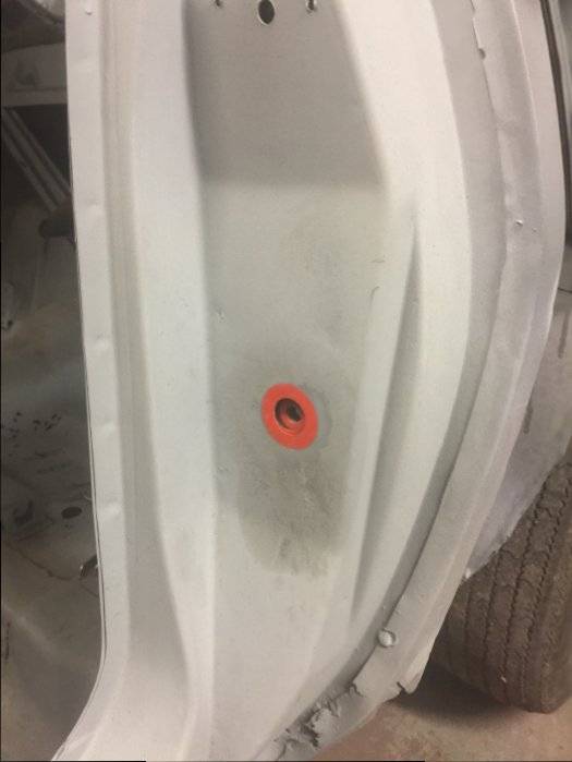

hi guys, I'm in the process of stripping down and labeling bolts and parts that i can salvage. Came to the door area and pulled the bolt. Was just wondering if anyone could identify this color. Seems to be the original color of the car, and I'm growing fond of it as I see it more and more around the car. Thanks for any input in advance.
DetMatt1
May 13, 2009
8,090
2,221
Metro Detroit
Looks like EV2 Tor-Red or EK2 Vitamin C. No fender tag or build sheet with this car?
Cu8D3A
Nov 7, 2016
15
I wish.. but Unfortunately no only the vin tag. Any idea where I can look that info up and or get replacements if that is even possible? I would like a to know the complete breakdown of my vehicle.
DetMatt1
May 13, 2009
8,090
2,221
Metro Detroit
Unfortunately not, once those get separated from a car they almost never find there way back. There are a couple of people that collect found build sheets and make them available to the owners of the cars. Galen Govier is one of them and he actually published his list of build sheets in the Mopar Collectors Guide years ago. I think there's also a build sheet lost and found on the Hamtramk Historical site.
