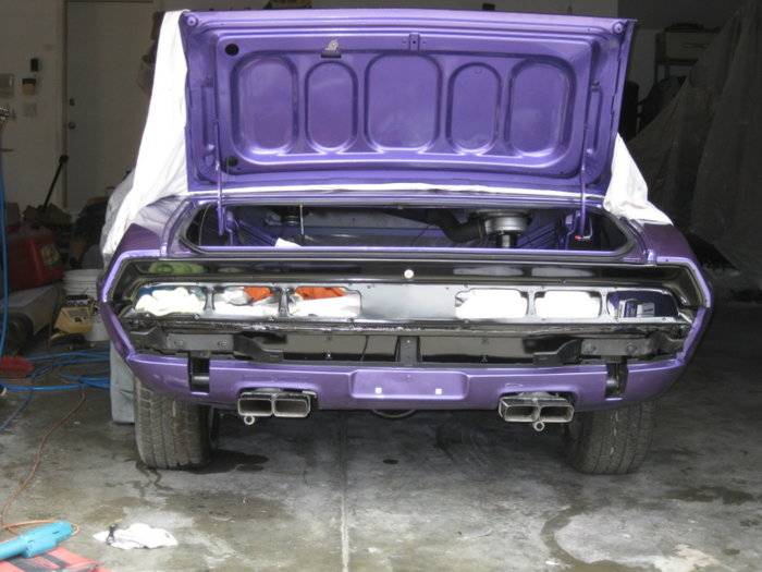

Does anyone have a picture of where the rear license plate wire and grommet pass through the trunk floor? I am installing new wire harnesses and I just realized that there is no hole in the new trunk floor. Thanks.

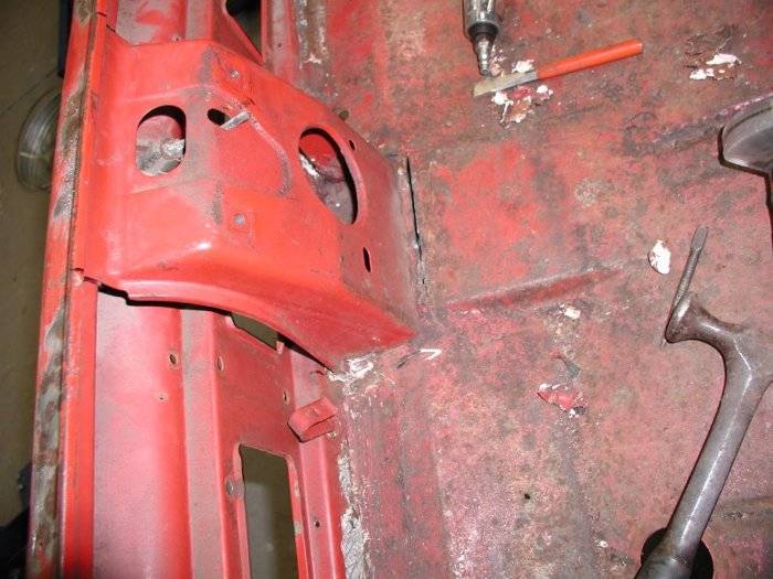

It goes thru the approx 2 inch wide flat of the floor just left (driver’s side) of the trunk lock support bracket. A little inboard of the taillight opening..
The hole is just visible to the left of the bracket in this pic.
