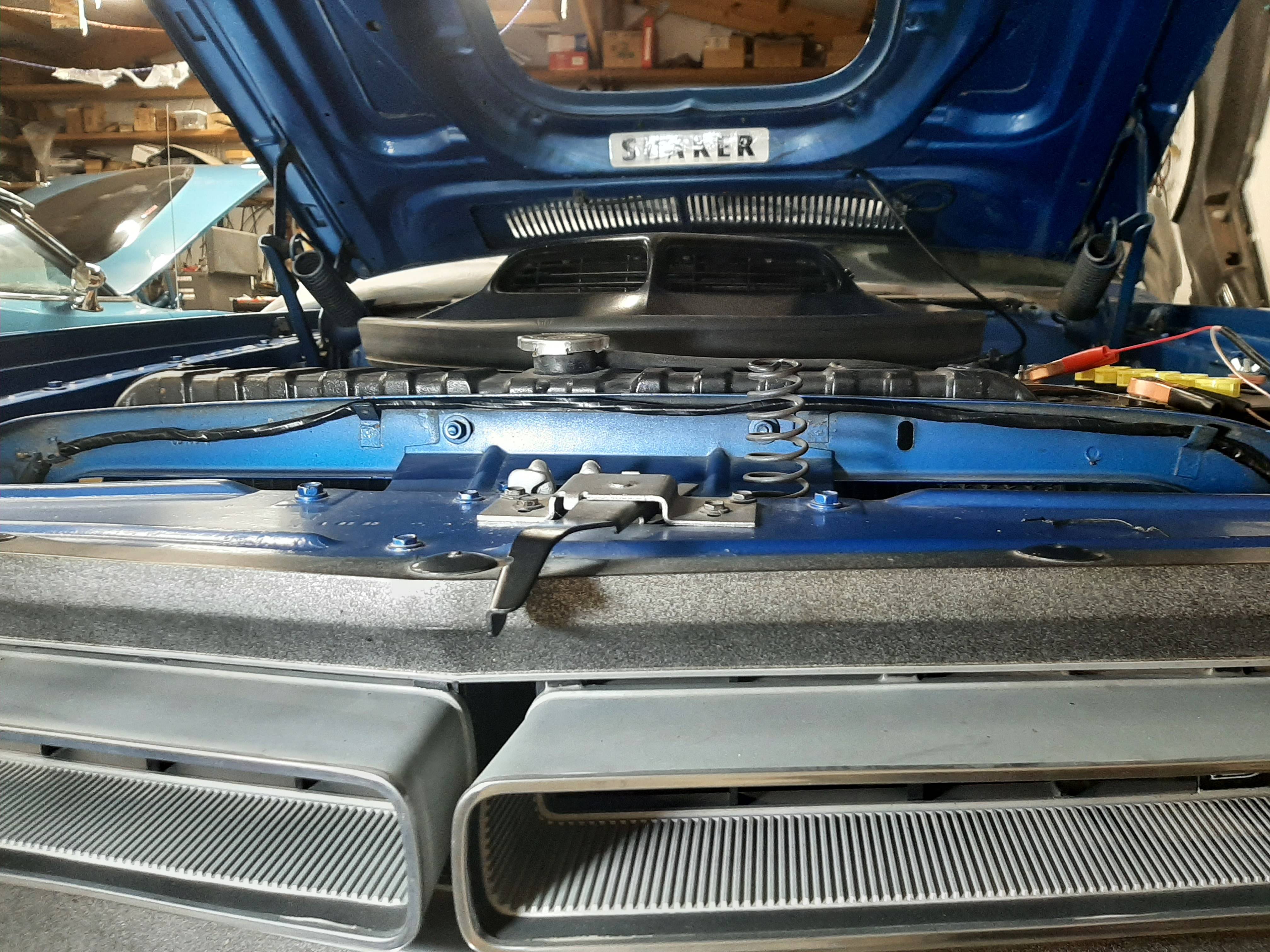

I need 2 things for the head light wiring:
1) The routing across the core support
2) Fasteners for the attachment to the core support (wherever that is)
Thanks.
PS Also best wiper assembly (I have the arms)
Adam
Dec 25, 2012
1,694
758
Washington
I believe the headlight harness is routed across the front of the core support, just below the top flat part. If you look in the channel you should see some bendable tabs that hold the harness in the channel.

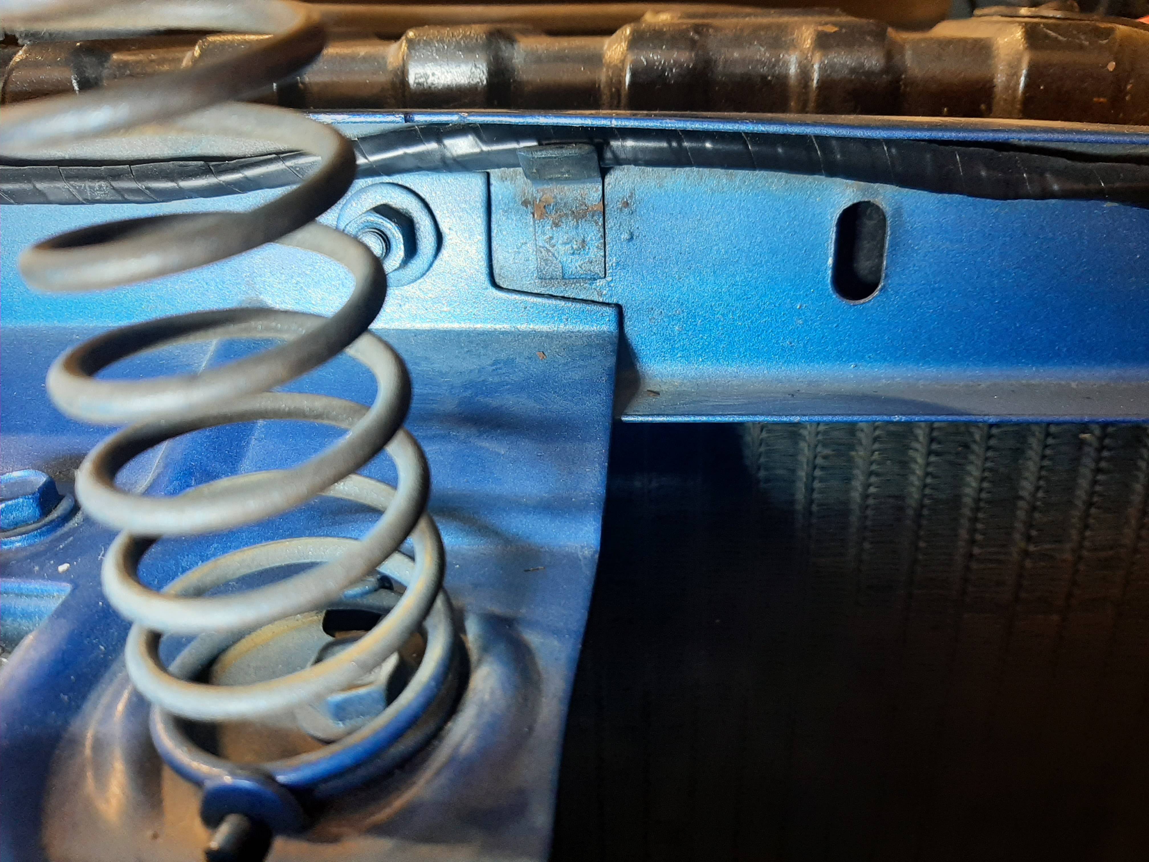

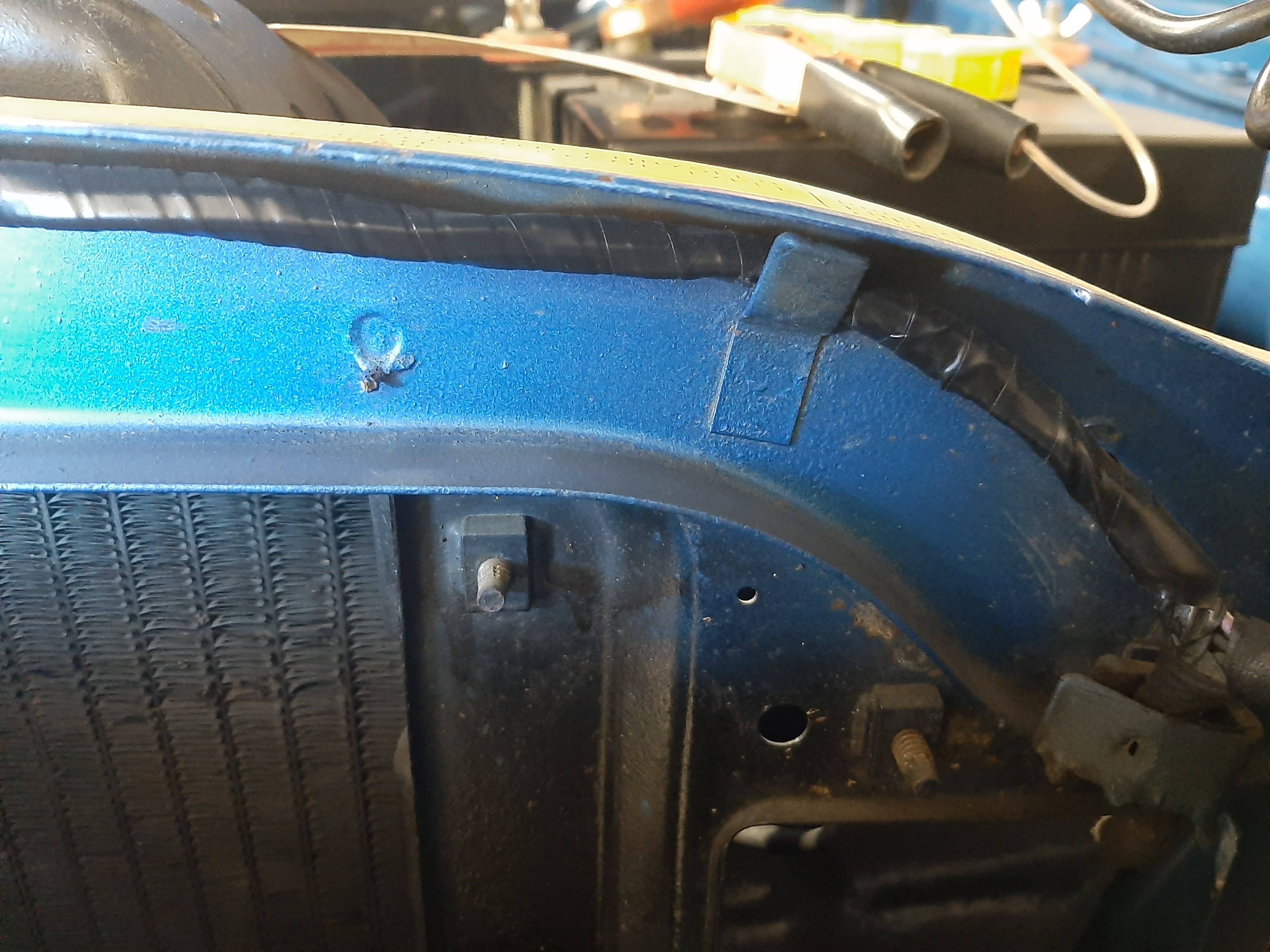

Here's the clips attached to core support. There's 4 of them.
Terry W.

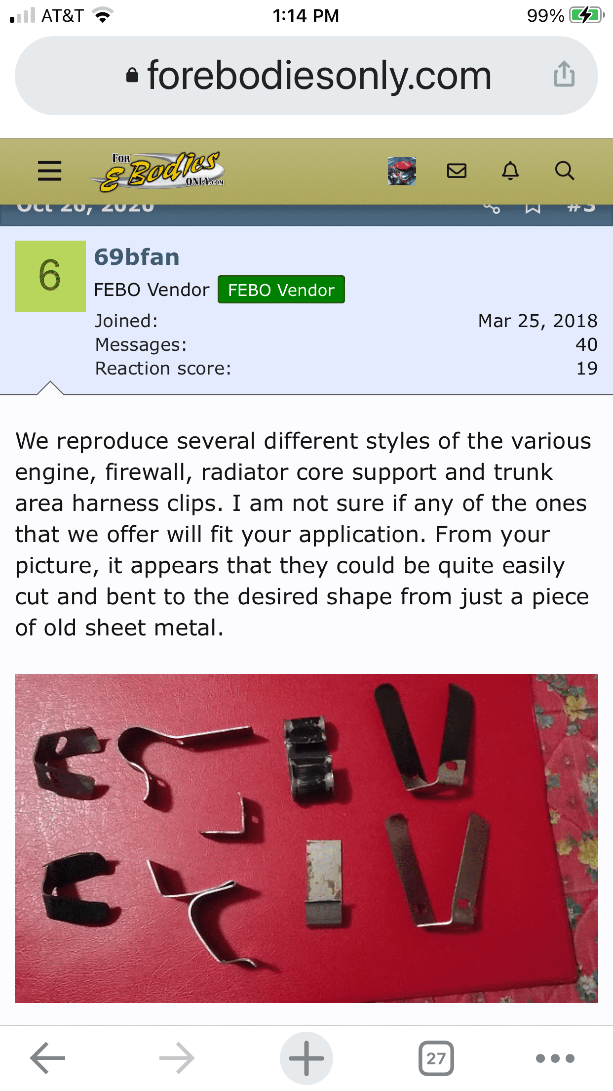

bare as a babies butt ..... not sure why they were removed, thanks for the confirmations though...
fasjac
Dec 27, 2019
2,473
1,242
Arkansas
Check out 69bfan, they/he may still be a vendor here that can can get some for you. If you haven’t already. You’ll have to do some touch up after installation. Good luck to you.
