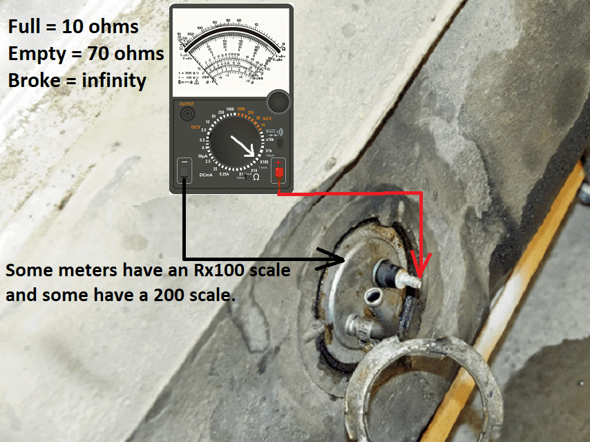

Since that worked the problem is the sending unit. You could measure the resistance from the terminal you took the blue wire off to ground. You’ll probably read 70 ohms if the internal sliding connector didn’t fall off (that happened to one of mine). Or the float could have developed a hole, filled with gas and is sitting on the bottom. Measure the resistance and let me know what you get.

was that about a ground strap? made one
will try ohms

not well versed on an ohm
meter..hooked blk meter wire to ground and no reading at blue wire with red probe. ignition on, battery connected....or hook blk wire to ground on instrument cluster

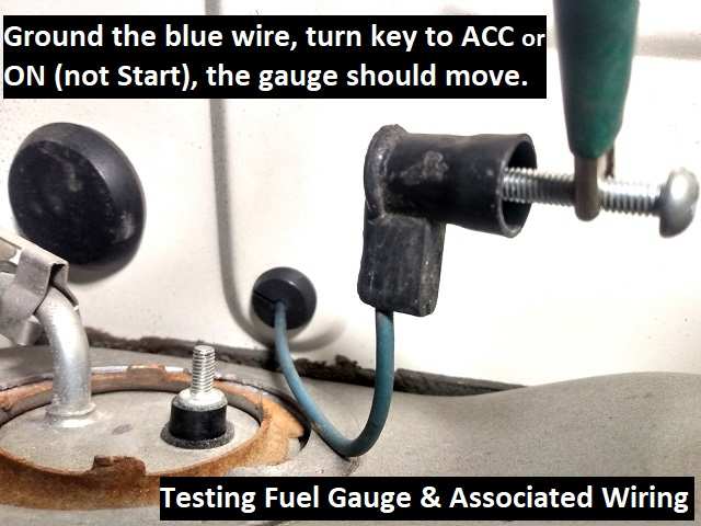

Pull the blue wire off, we're just checking the sending unit resistance, no need to do anything with the ignition. Maybe this will help. Make sure the leads make good connections.

Just to clarify, did you perform the test in the picture? Make sure car's battery is connected (mines not in the winter). I always put a machine screw, that's the same size as the senders terminal, into the connector because often the alligator clips don't reach inside far enough.

I want to keep the troubleshooting to this one thread.
So, your sending unit’s resistance is fine out of the tank.
1. I should have first asked if your oil & temp gauges work, do they?
2. Did you jumper the blue wire to ground and turn the key? If you did that test, did the gauge move?
3. Are you sure the float doesn’t have a pinhole in it?
3 to 4 gallons should be around 1/4 on the gauge. A bit lower if it’s an 18 gallon tank BUT ONLY if the float arm is correctly adjusted.

did static test. removed sending unit from tank.. wife watching gauge--moved float to full position--gauge responded to full---IT WORKS !!! problem solved. thanks for all the input members
