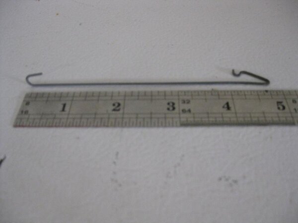

Nov 18, 2013 #1 T Tom Active Member Joined Oct 5, 2013 Messages 30 Reaction score 0 Location Kitchener ontario There are two wires that go on the rear headliner bow, does anyone know who sells these or have some dimensions so I can make them.

Nov 19, 2013 #2 Adam Well-Known Member Joined Dec 25, 2012 Messages 1,648 Reaction score 706 Location Washington I will post some better pictures and measurements this afternoon (Tues) unless somone beats me to it... in the meantime follow this link and look at pics 127,128,129... http://ImageEvent.com/adamell/wiperparts Last edited: Nov 19, 2013

Nov 19, 2013 #3 burdar Well-Known Member Joined Jul 10, 2009 Messages 521 Reaction score 30 Location IOWA I think RestoRick sells them.
Nov 22, 2013 #4 Adam Well-Known Member Joined Dec 25, 2012 Messages 1,648 Reaction score 706 Location Washington The wire is .050 thick spring steel. The pointy end is inserted into the roof support.
