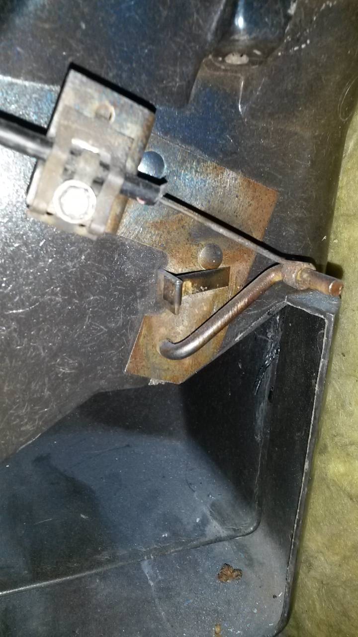

Ok I’m looking for a helper spring that goes on the arm that works the fresh air/ recirculate door. I can’t even find a picture of it. In the parks book it has a drawing but it’s not a good drawing at all. Does anyone have any pictures of the right side of their heater box or a picture of the spring that I’m talking about?

Is this what you are talking about. It's a spring tab.

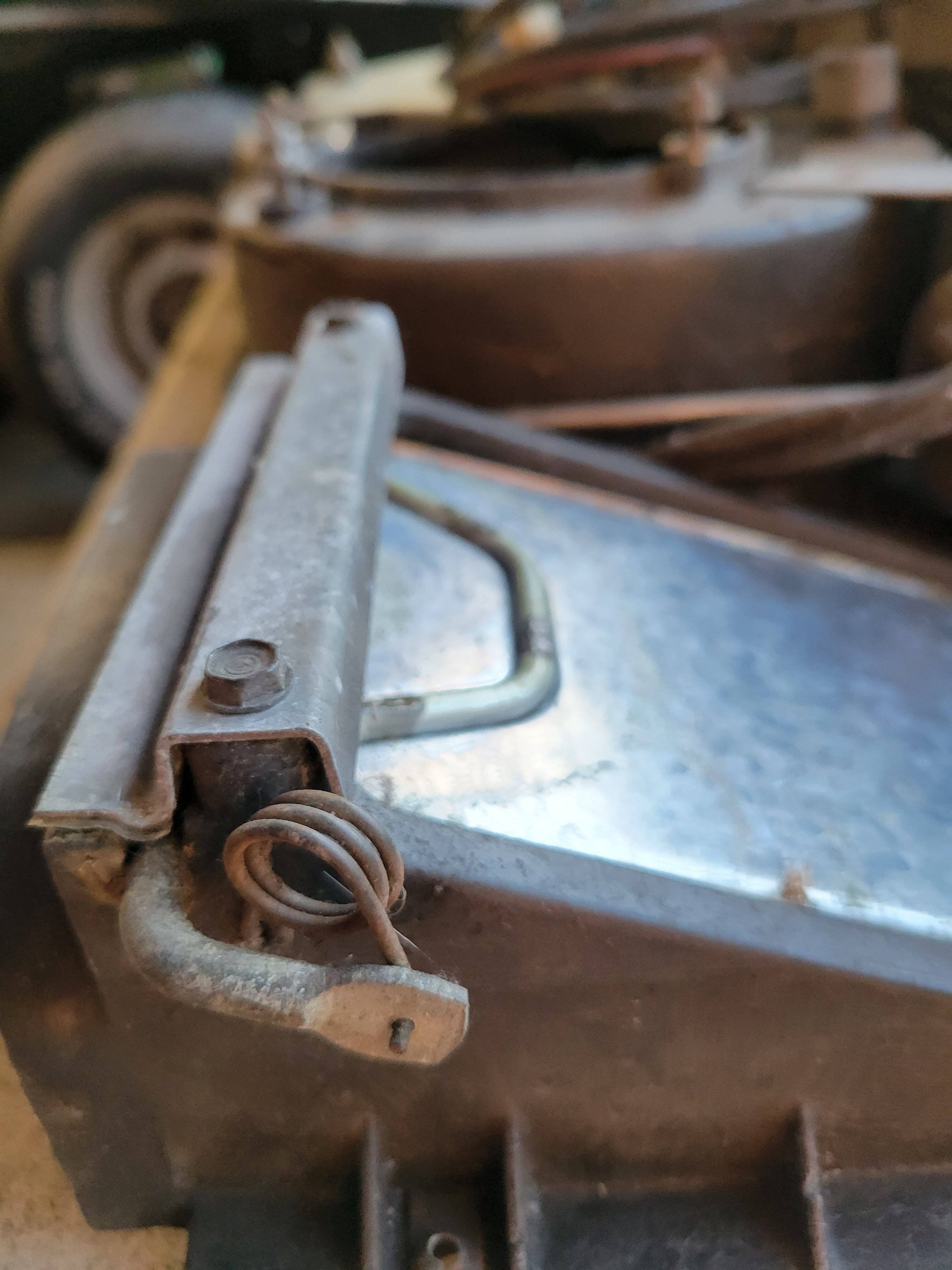

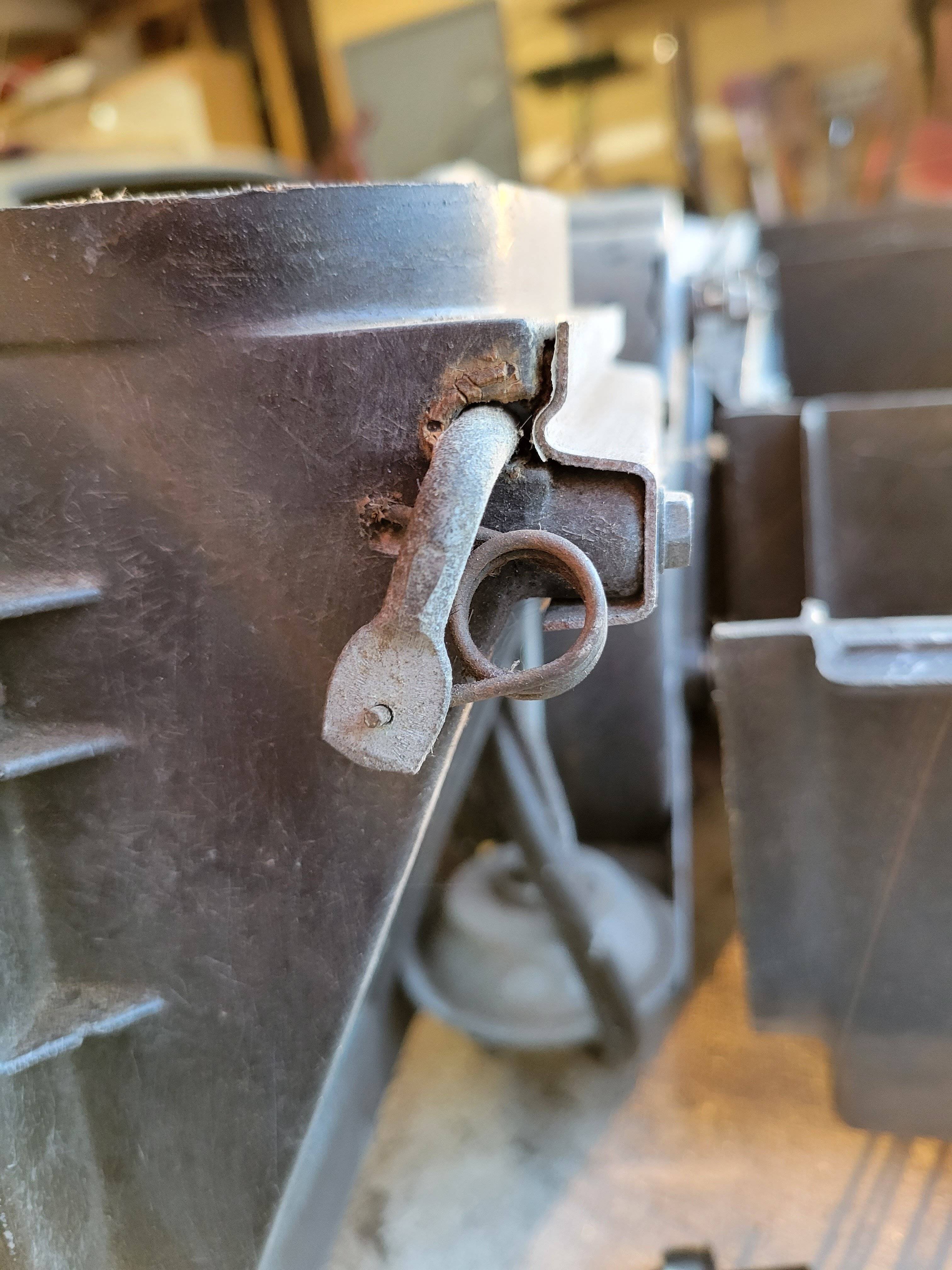

This what you mean?

Do you have that spring? The one on the picture on the right?
I do not have an extra spring, if that's what you mean. I bought my air box re-build kit from Detroit Muscle Technologies. I did a quick look at their website and did not see any springs listed. But if you call them, they may point you to someone that does. Good luck.
