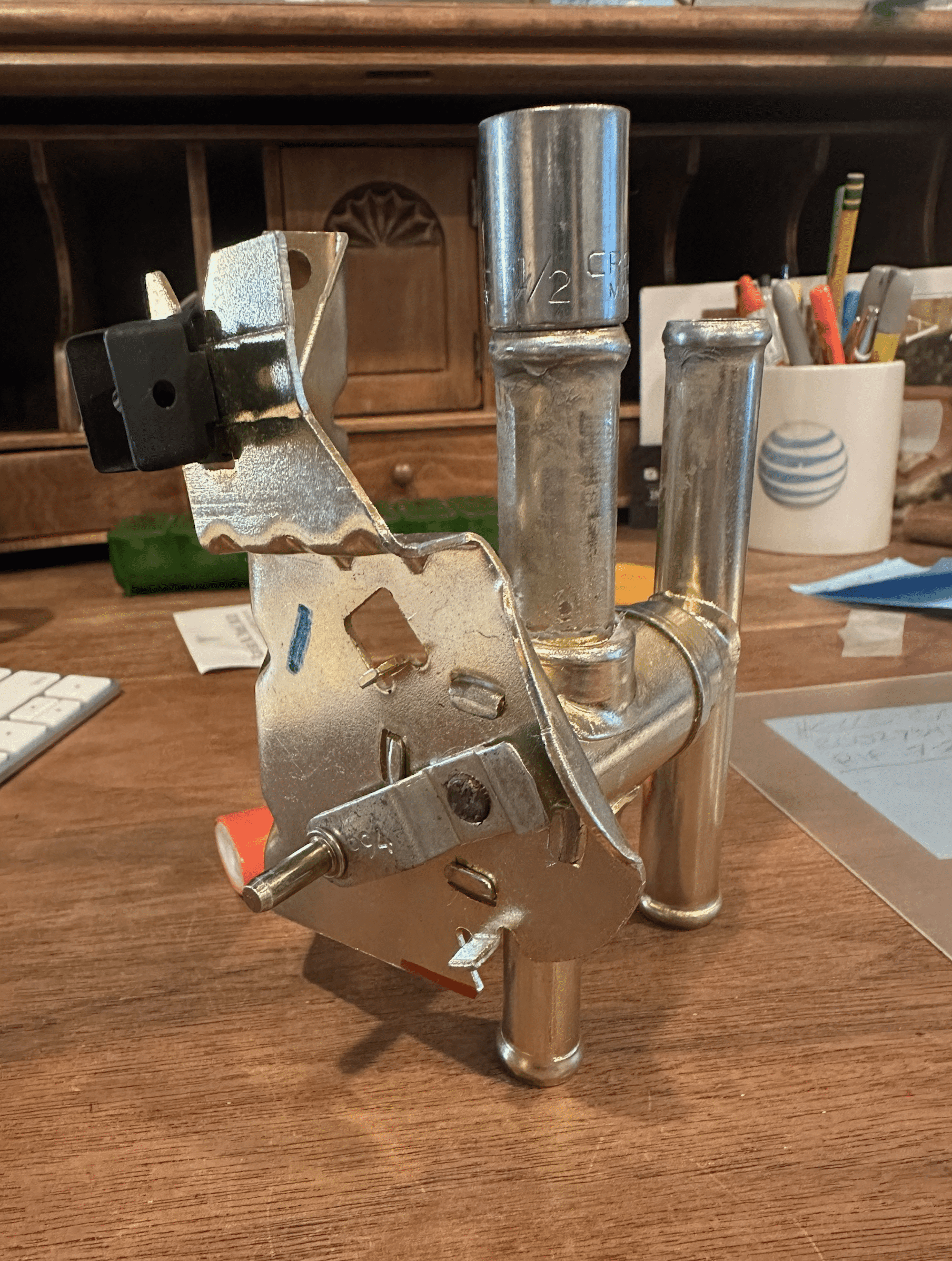

My '71 convertible was set up similar when I bought it. It had a solid plug inside the heater supply hose where it attached to the heater control valve. There were two clamps on the heater hose right next to each other, one of them clamped the hose to the control valve like you would expect, the second clamp right next to it went around the hose and clamped down on the steel plug. The car ran that way without any issues for a couple years until I replaced all the belts and hoses and discovered the mystery plug. Like you, I never use the heat. I'm not sure if the previous owner did this as a temporary, summertime thing, or if the heater core had leaked at some point. I suspect the latter.
It was essentially set up like the picture below (if you replace the socket with a solid piece of metal.)
The only obvious visible clue was the use of two hose clamps instead of one. You could do the same thing at the heater core or at the other end of the supply hose where it leaves the engine. I would use brass or stainless steel if you can.
FYI, I took the heater hoses and control valve off and just ran a bypass hose underneath the shaker baseplate. One of these years I may swap out the heater core and hook it all back up.
I've also seen cars with a small ball valve installed in the heater hose close to the engine, folks will open/close the valve as the seasons change.
