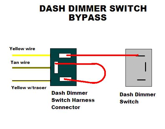

If you get to this point , this is what you do.
Dimmer switch bypass.

It's easer to check the lights. If you find that all the cluster lights have a good ground. The bypass is for testing the circuit. It might be the switch.
