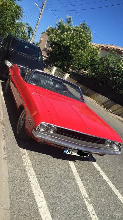

Hello,

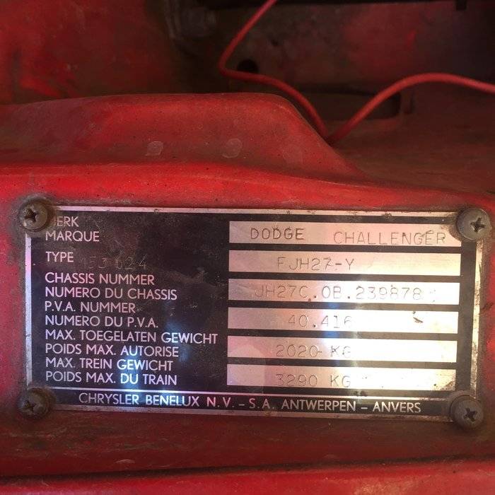

I am new Here.I own 1970 challenger convertible exported or building ? new to Chrysler Benelux/Antwerpen.
Could you guys provide me any information about this car? I know nothing about export e-bodies.
The car has no fender tags/buildsheets since new,only vin tag and Benelux tag.
It has power converible top,radio delete,power steering,power disc brakes,225 slant six,727,console as well as 8 3/4 rear end
Odd features are german HELLA headlights,clear blinkers,rear fog light and many german/french electrical parts inside engine bay.
I would really appreciate your help regarding information about export cuda's/challengers
Please see attached pictures of the car
Thanks !

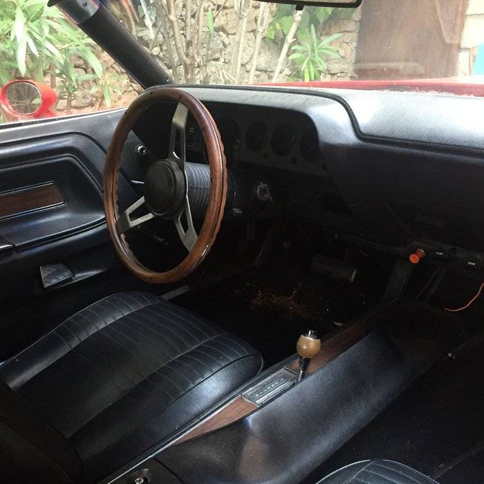

Hello!
Here you have;

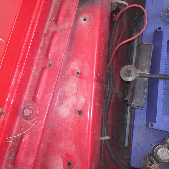

Those fender tag screw holes look like they have been used at some time, if it never had US style fender tags fitted there should be dimples there rather then used holes.

It does look like there were tags there at some point, is that the original double horn steering wheel or is that aftermarket?

I'm thinking it may have been built to US spec then modified when it arrived in Europe pre delivery maybe they removed the fender tags and fitted that other tag and made other changes to make it legal over there. I think some early British cars had mph speedos so maybe some parts of Europe were ok with that.
