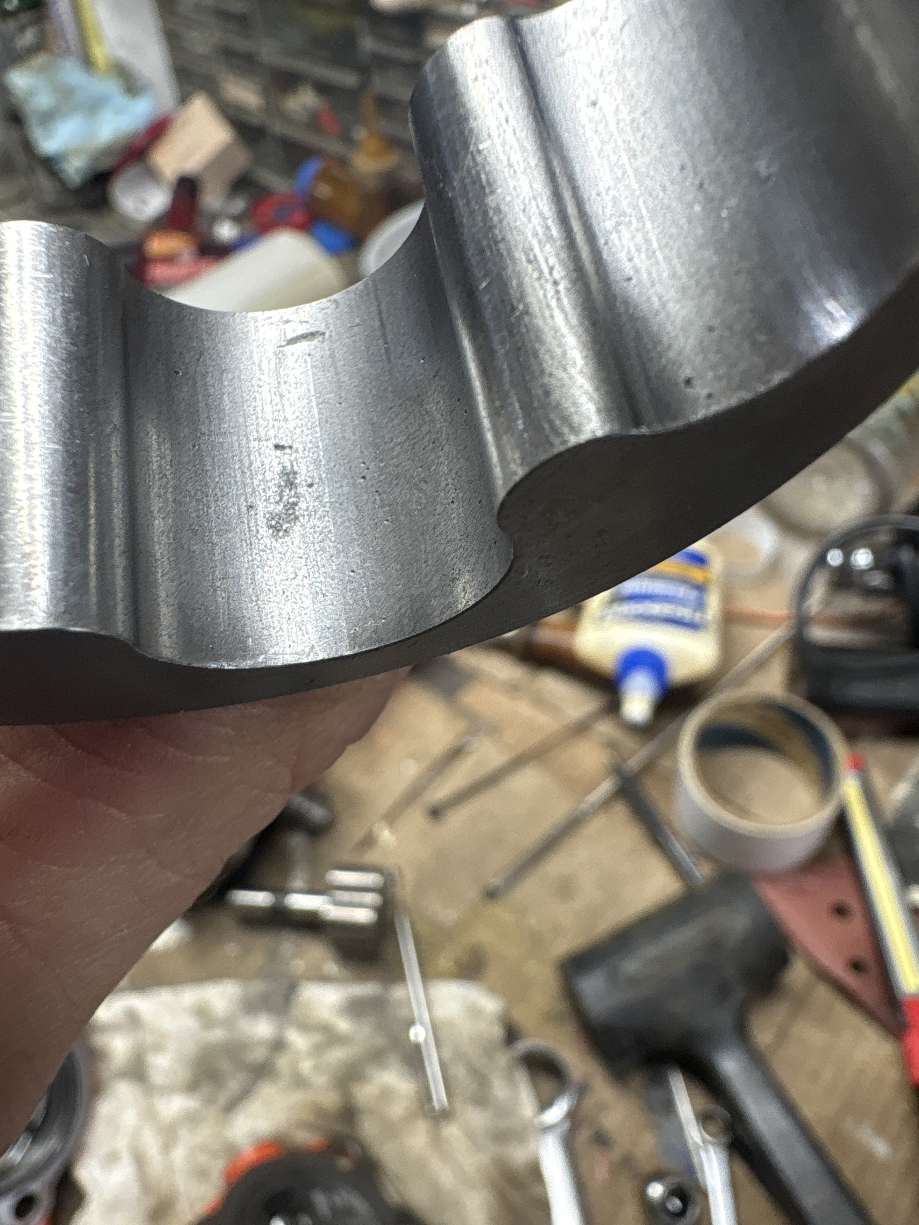

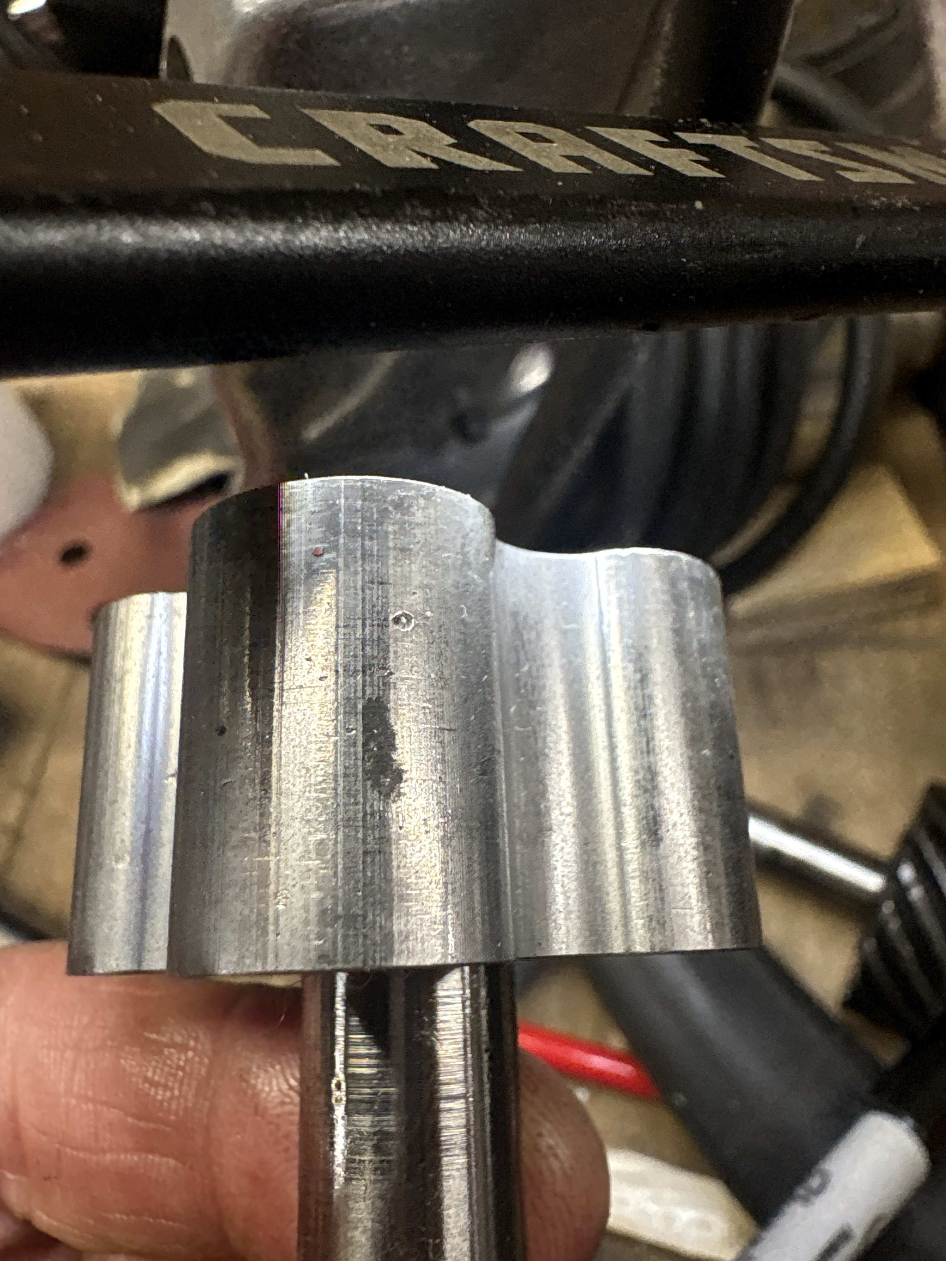

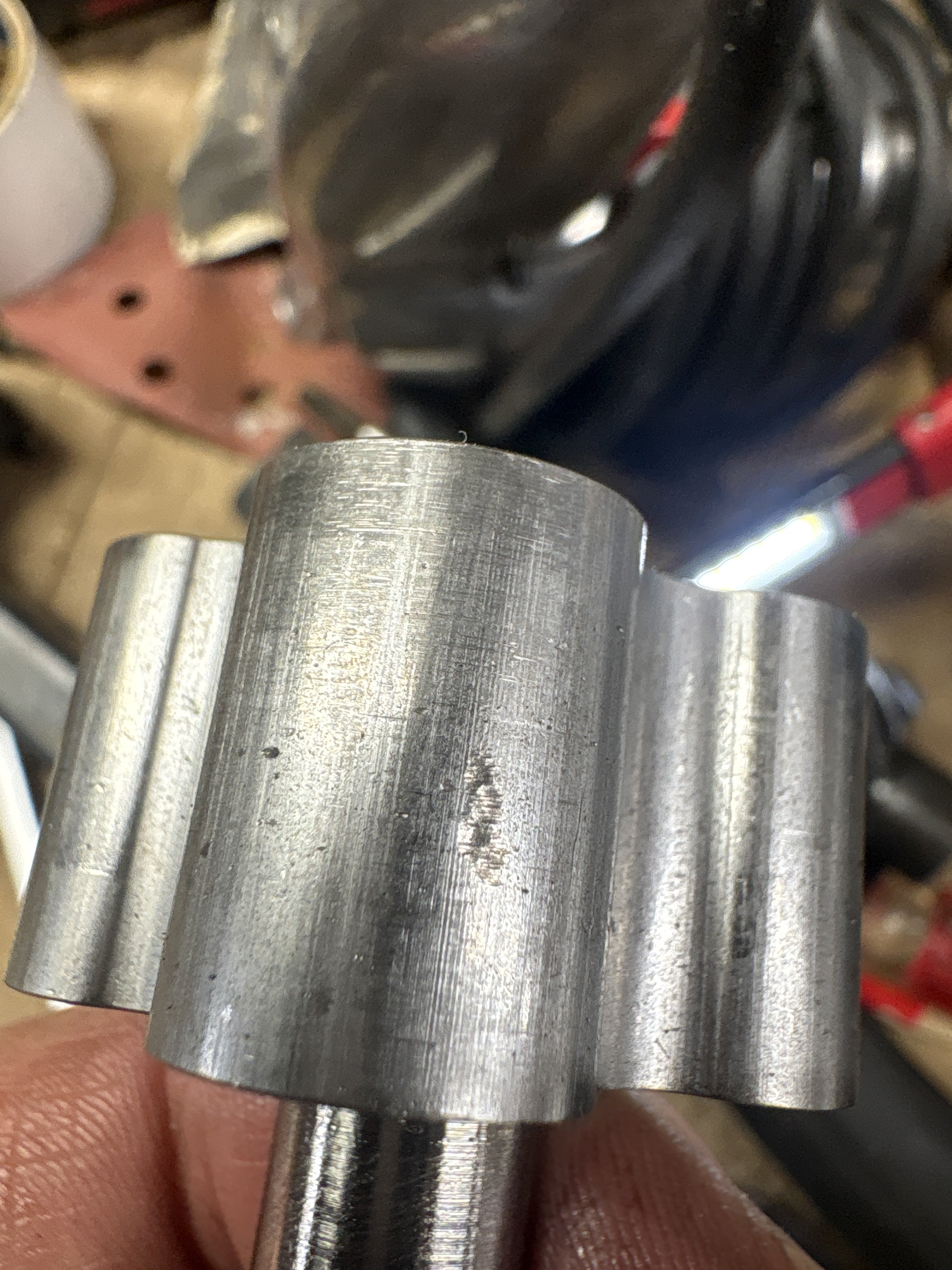

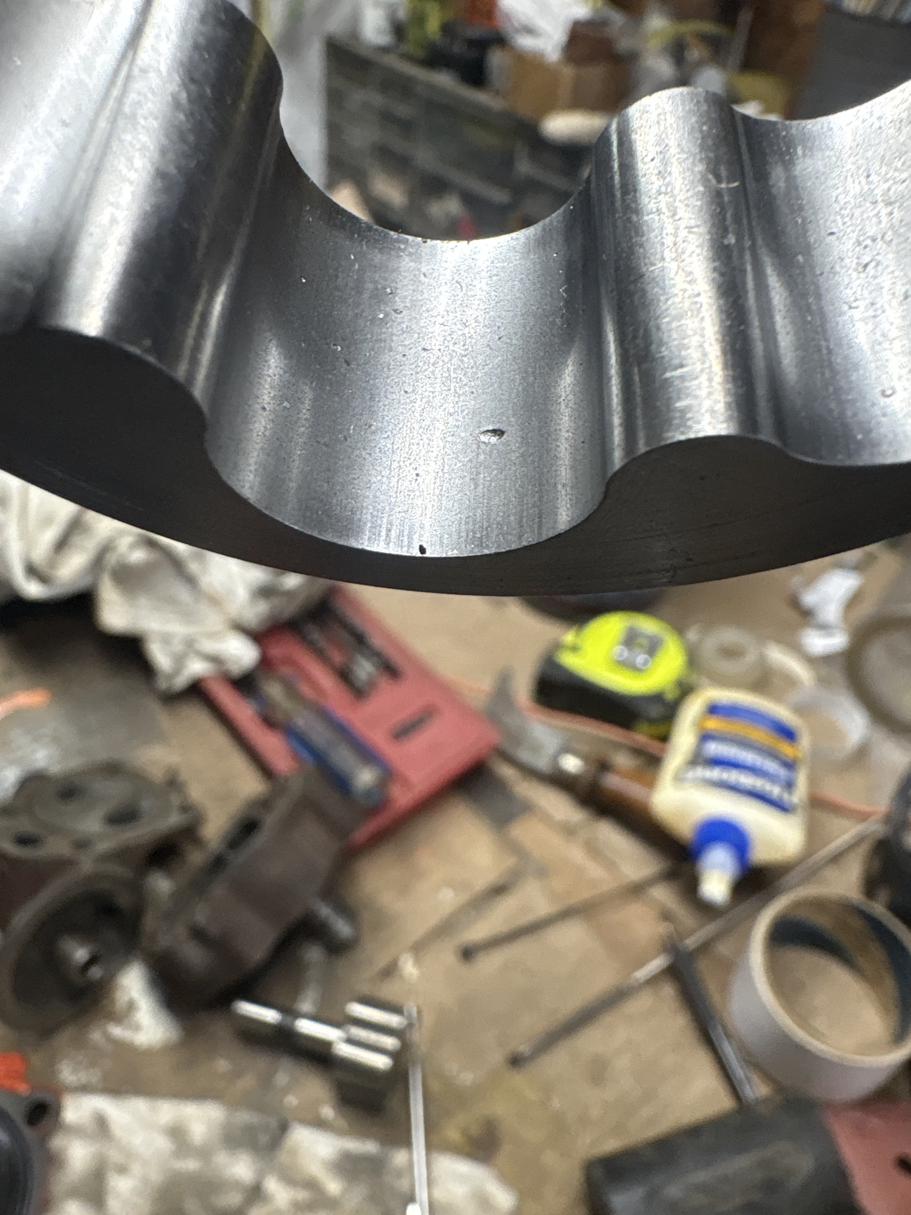

I have a low pressure issue that I have been dealing with for a while. It’s 383 magnum rebuilt and has less than 1000 miles on it. Had low oil pressure issues before rebuild and still have similar issue after rebuild. Currently has new stock m63 standard pressure pump. (Tried a high volume pump but made no difference). I have an oil pressure gauge and dash light connected. Has ok pressure when starting out but once the oil gets hot the pressure drops to 10psi or lower at idle or at a stop light. Recently the oil light started to flicker when I pulled up to my house, so I quickly put it in the garage and haven’t had the stomach to tackle the problem. I have a new after market dip stick (because the original one had the grab loop break off) I did make sure that the dipstick was the same length stowed as the original. 1)Thought maybe I didn’t have enough oil in the pan (oil starvation)even though the dip stick registered full. 2) have been running 10w30 Brad penn hddp oil since break in oil was changed. Just bought some straight 40 weight oil because I read somewhere that straight weight oil keeps its viscosity better when hot than the mixed weight oils? Just drained oil and it appears that I have 4-3/4 qts which either the oil left in the engine and oil filter should be about right for the 5 qts capacity the manual calls for(it’s a stock pan with windage tray)
Question: I removed the oil pump and took it apart. Very clean, no blockages anywhere BUT there are a few small nicks or depressions nothing larger than a pin head and most are in the center of the inner and outer rotor faces. Could these small nicks cause significant pressure loss? Any help suggests would be appreciated. Also let me know if you need further clarifying info.
