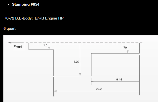

Sump is about an inch below the front crossmember.
If it helps, this is the 6 quart pan dimensions. Is this what you have?
If yes, IMO, just run 6-1/2 quarts, remark the stick and drive the wheels off it!:steering:
