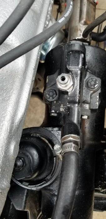

Post a picture of your steering box. You may be missing an adaptor fitting that screws in to the steering box.

Here is a picture of the steering box. This was originally a slant six with a Federal pump.

You do have the fitting. But you may need to swap it. The Federal pump I swapped on my car used a smaller pipe than the Saginaw pump.
I swapped the fitting in the steering box to a JIC hydraulic fitting and used the standard Saginaw hose.
Mega Parts list the standard looking fitting but not sure which size it is.

I tried to loosen the fitting on the steering box but it won't budge. The fittings on the hoses I tried fit, it's the routing of the hose I'm having a problem with. I may need to go to a army navy type of flexible hose. Thanks for your response.

NAPA, and other places, can make you a hose with the correct fittings, but it may not appear factory correct.

The problem I have, when I bought the engine it didn't have a PS pump. When I bought the pump it didn't have a high pressure hose. I looked at a number of hoses, nothing fit. The car is a 70, the engine is a 74. The 74 has a double male flare. I need a female flare on the steering box and a male flare on the pump side. The 70 hose has all kinds of bends on the pump side which makes it hard to install. Thanks.

The nipple on the box can be removed to use the later style hose. I think the small and big block 70 hoses have been combined into one part number for the type of fitting you have on the box now.
You might try searching for part numbers at Rock Auto, then cross reference with your local store or favorite online supplier.
One more super important question: What type of pump do you have? The Saginaw pump will be easiest to find hoses for.

I tried removing the the fitting on the steering box. I couldn't loosen it. I tried cross referencing on a number of sites. I have a Saginaw pump.
