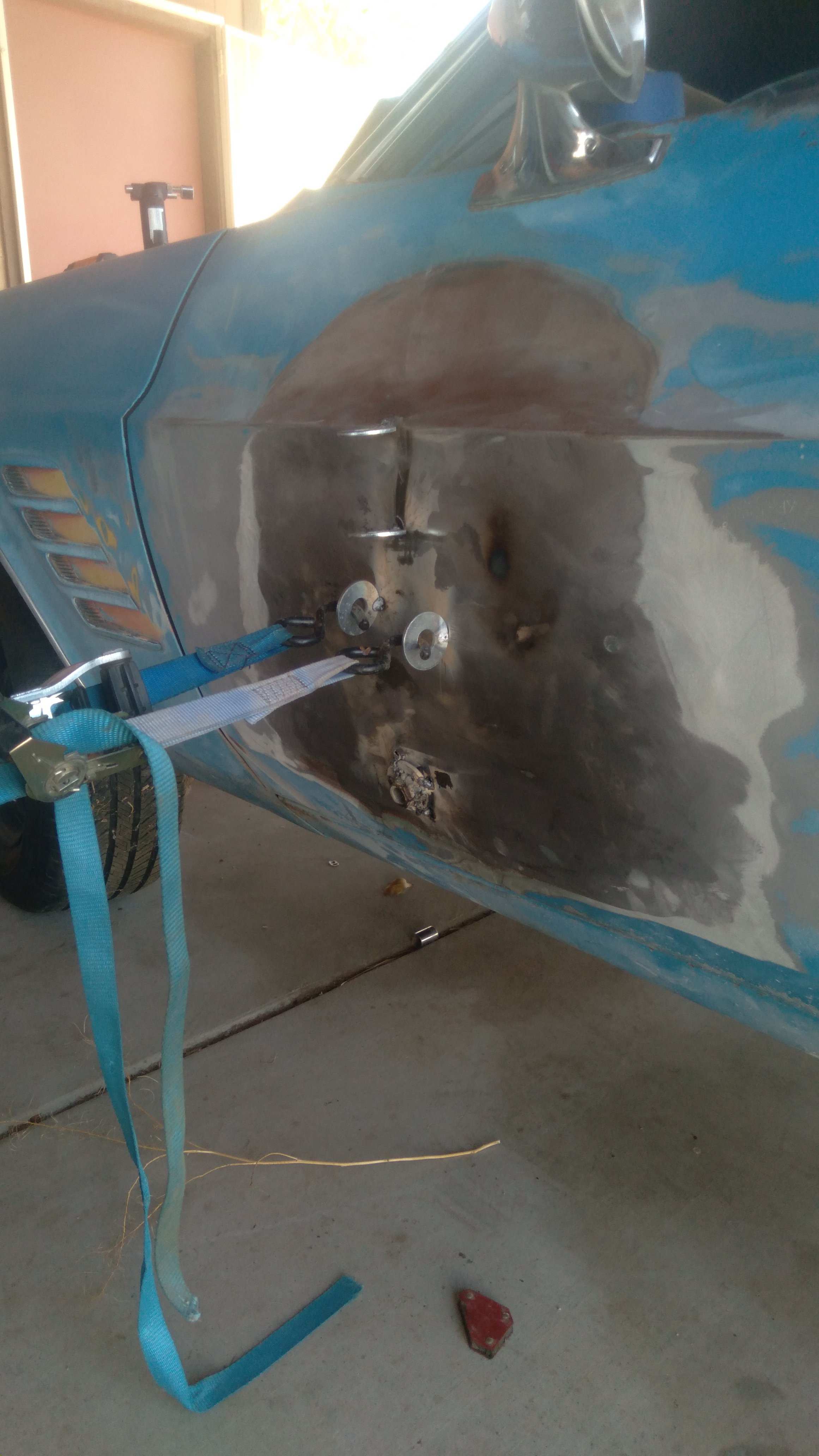

When you have a basketball size dent in your door, and none of the proper tools to fix it. But you do have a welder, washers and cargo straps. Let's roll

I would recommend a MacGyver reference over a Hillbilly/Redneck one, because your setup looks really good.
Under-pull, don't over-pull the dent. Keep us posted. :cool:

when you have a little tension on it when pulling tap down the high spots be carefull not to over pull

Actually for dents smaller than four inches that don't have sharp creases, I've had success with suction cups like used to carry glass!

The PDR guys use glue on dent puller attachments. Dude glued one to my truck door to pull a dent, and I about had a **** hemorrhage! 😲 He just laughed and told me he never gets tired of seeing the look on peoples faces when he hot glues it right onto the paint! It came right off and never hurt the paint!
