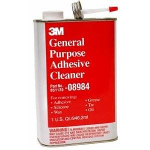

cool. i'd say 99% of the stripe is gone. what adhesive remover works best?
I like 3M's adhesive remover.
If you can't find that - but you should be able to, all the parts store should have it on their shelves - you can use a good wax and grease remover, too.
