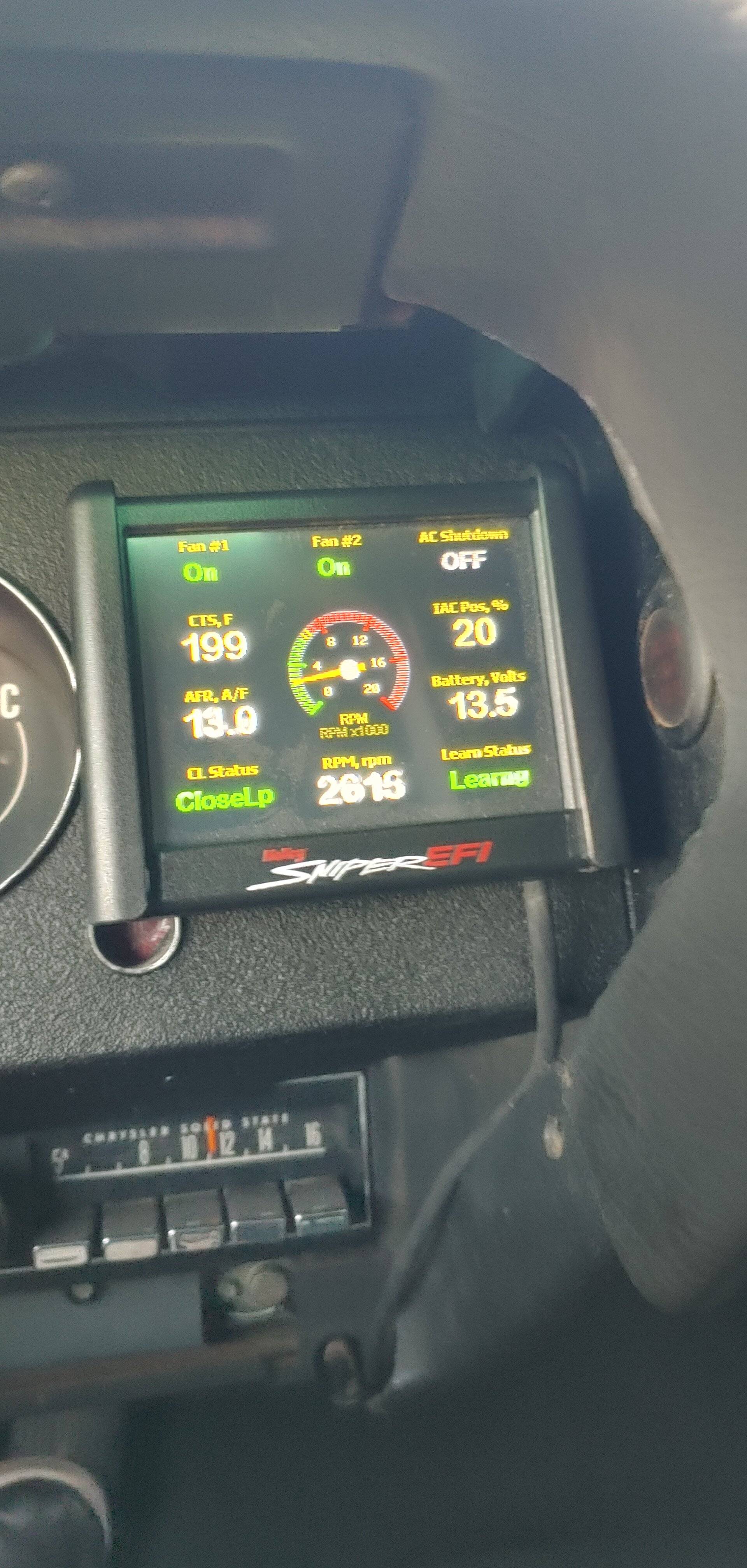

I have read mixed reviews on the Holley Sniper, but after having the system installed on the 440 in my 72, I love it. I had the matching electronic ignition system installed too. Incredibly smooth and amazing throttle response. I can't speak to the difficulty of the install, but the shop that did it had it done in about 4 hours. I had to get a dropped air cleaner base for clearance. A better sized top and filter are on order.. The only downside is the external inline fuel pump is very loud. Next upgrade will be a new tank with built in fuel pump. But if you are considering the Sniper, so far I'd totally recommend it.

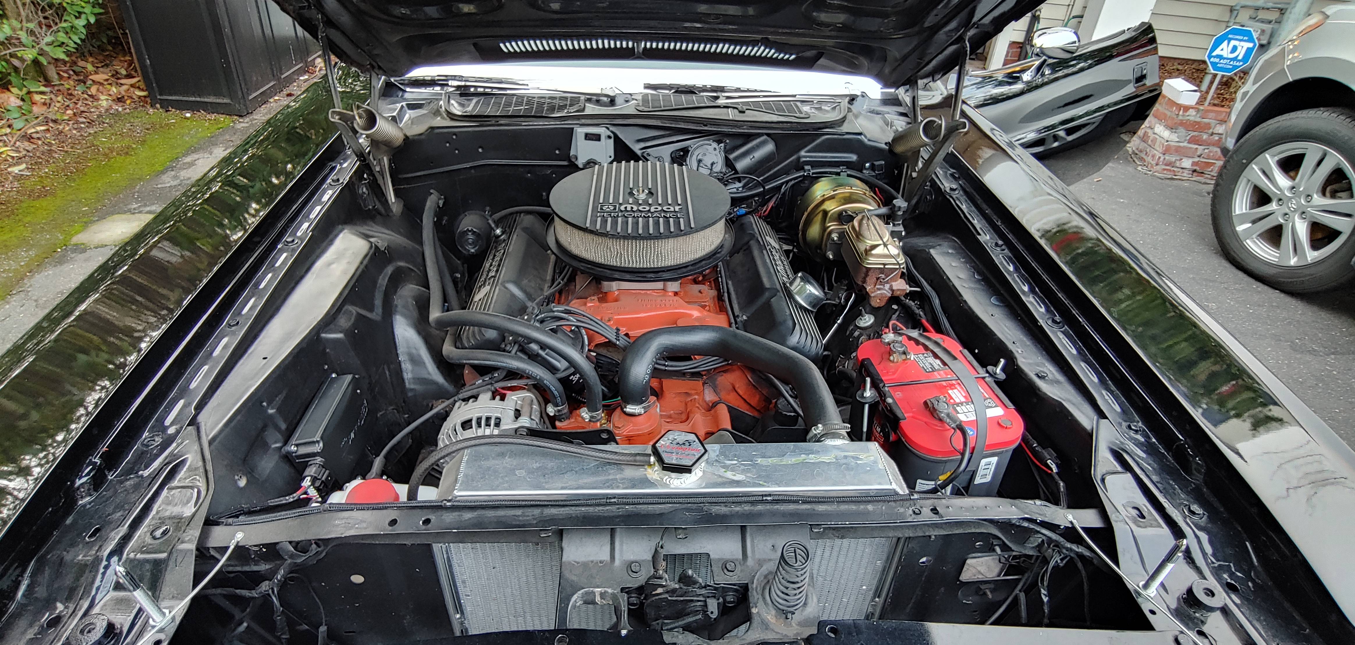

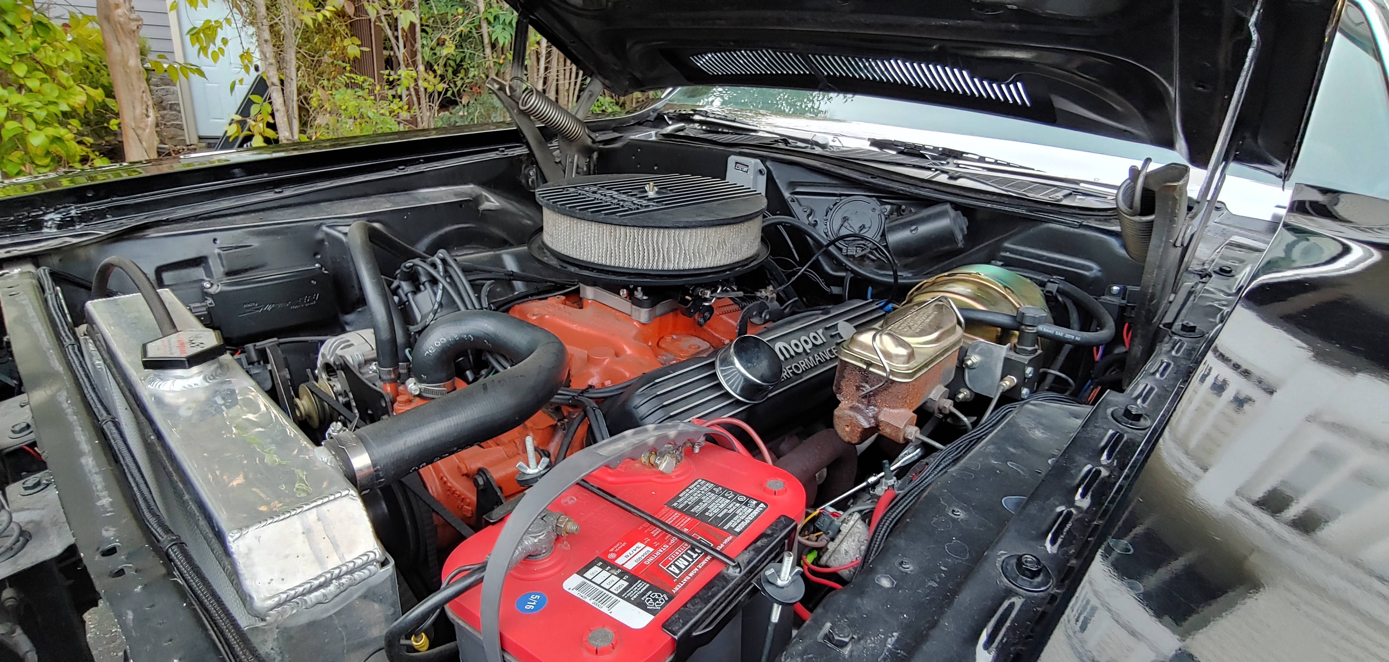

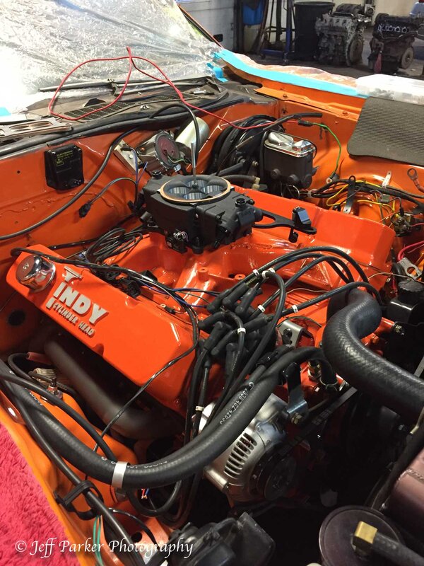

Just finished up my Sniper install on my 1970 Challenger. 500ci, Indy heads, Comp roller cam, Super Stealth, Tanks inc tank, Walbro pump, 5 speed , Dana 60. Install was pretty straight forward. Hardest part was fabricating and running the fuel lines like I wanted and getting the shaker stuff to fit! Started right up, runs great. I've only got couple hundred miles since install, so I know I need to do some lap top tuning, but that's half the fun! Installing a Terminator X on a customer's '69 GTO right now. If I had to do it again, I would choose the Terminator. If I can be of any assistance to any one else with their install, please ask. Jeff

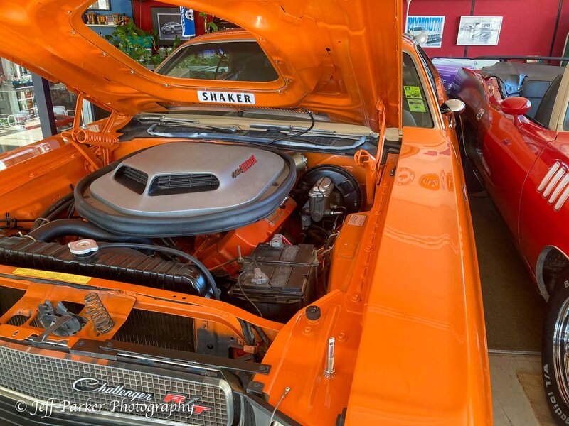

Hey MoparCarGuy, I buy all my fuel injection from Chris at EFI Pro. Great guy to deal with. Holley must have a back-log on orders. I've been waiting about 4 weeks for my customer vehicle parts. I had to do a lot of modification to my shaker base to get everything to fit. I have a lot of pictures of the modifications. I had to drop my base about 2" to get it to fit. Sure was worth it tho! Your build sounds just like mine. Let me know if you need anything! Jeff
