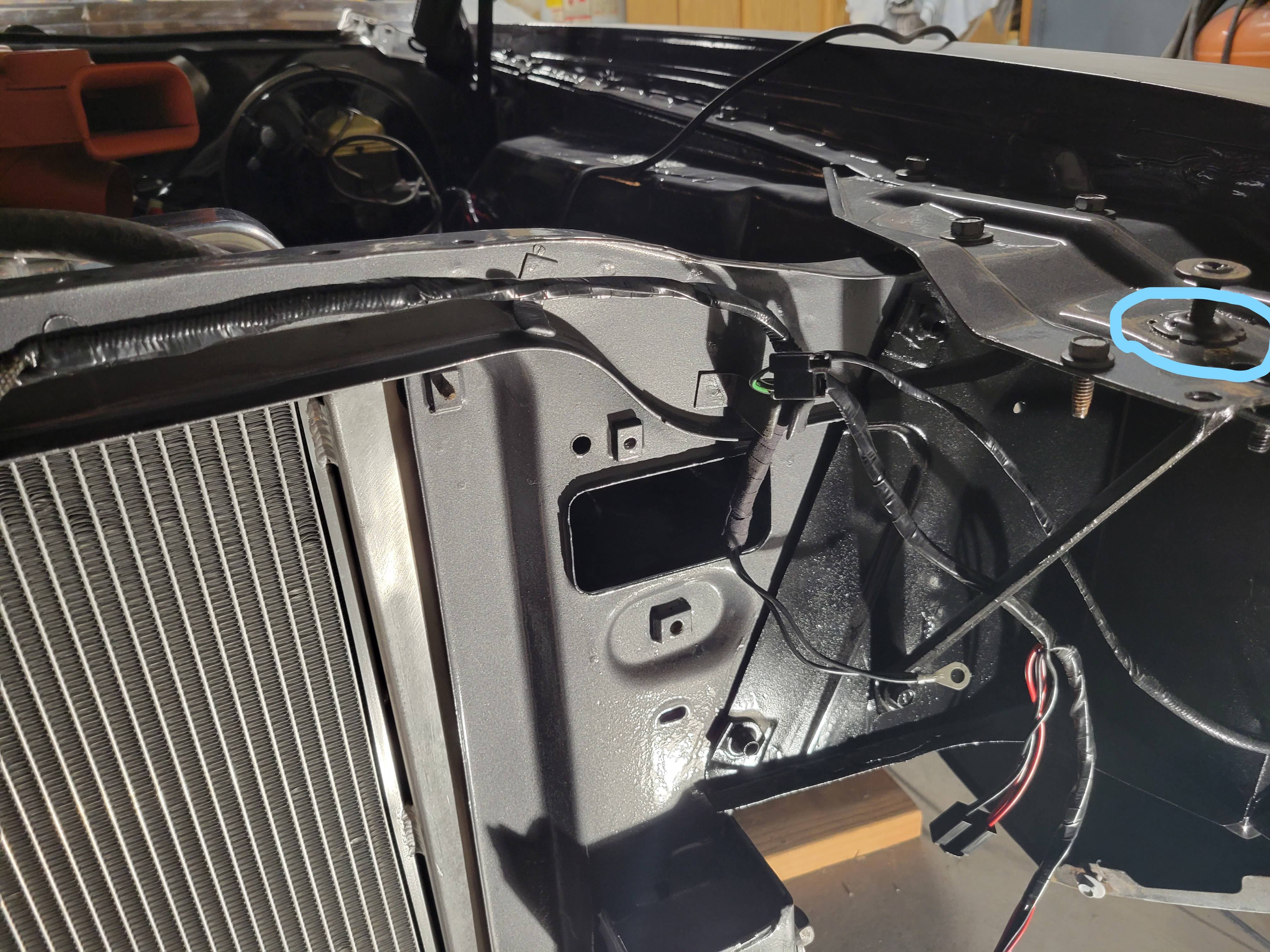

Does anyone know where to get the piece that captures the threaded stud for the hood bumper? And does the wiring go through this rectangular hole? See photo. thanks in advance.

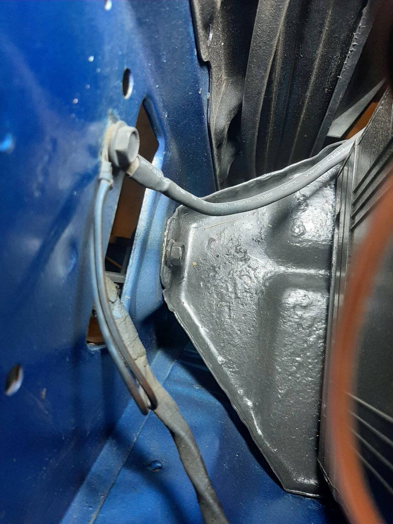

Yes, the wiring does come through the rectangular hole.
Terry W.
The top one is a for the ground for your headlight/front end wiring, the bottom I believe is also a chassis ground. Both get short 1/4-20 bolts from the engine side.
