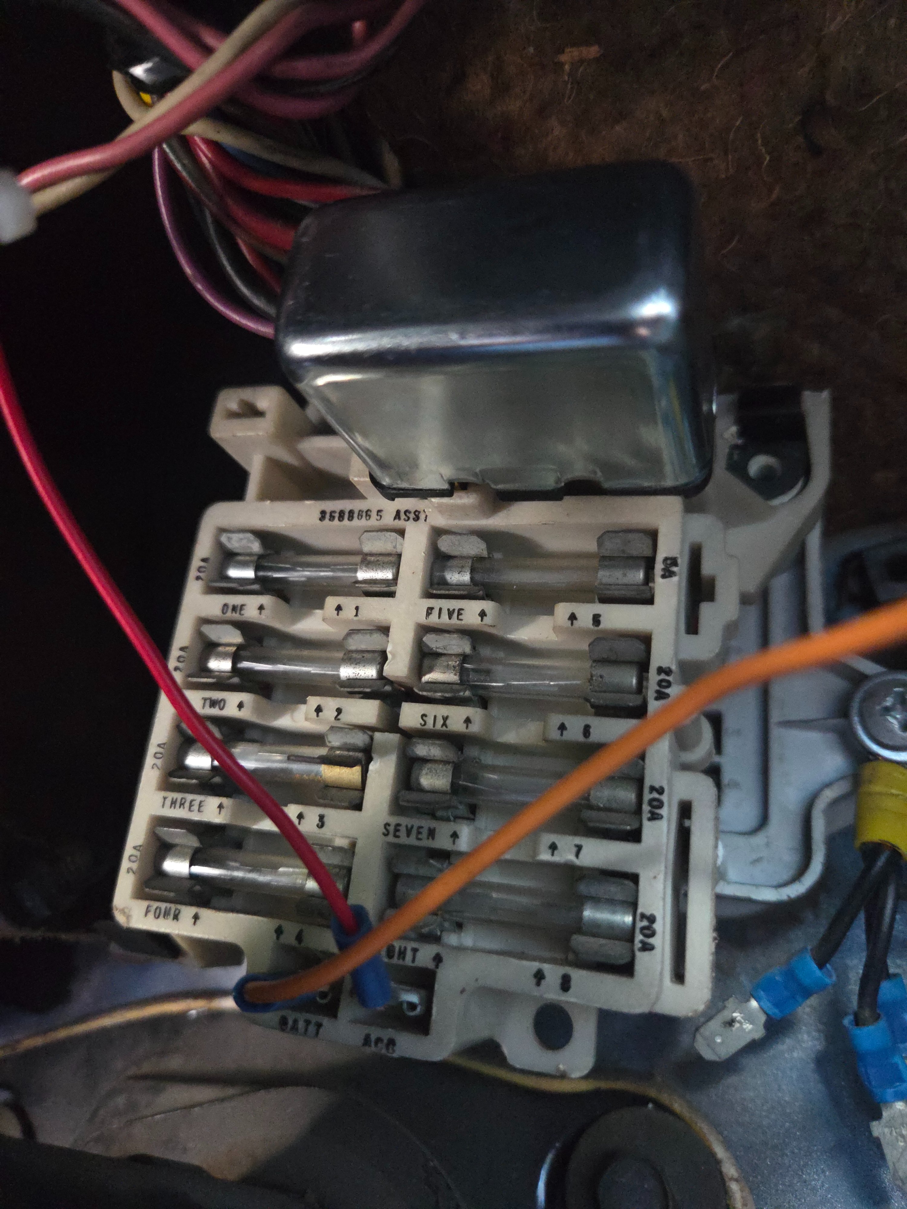

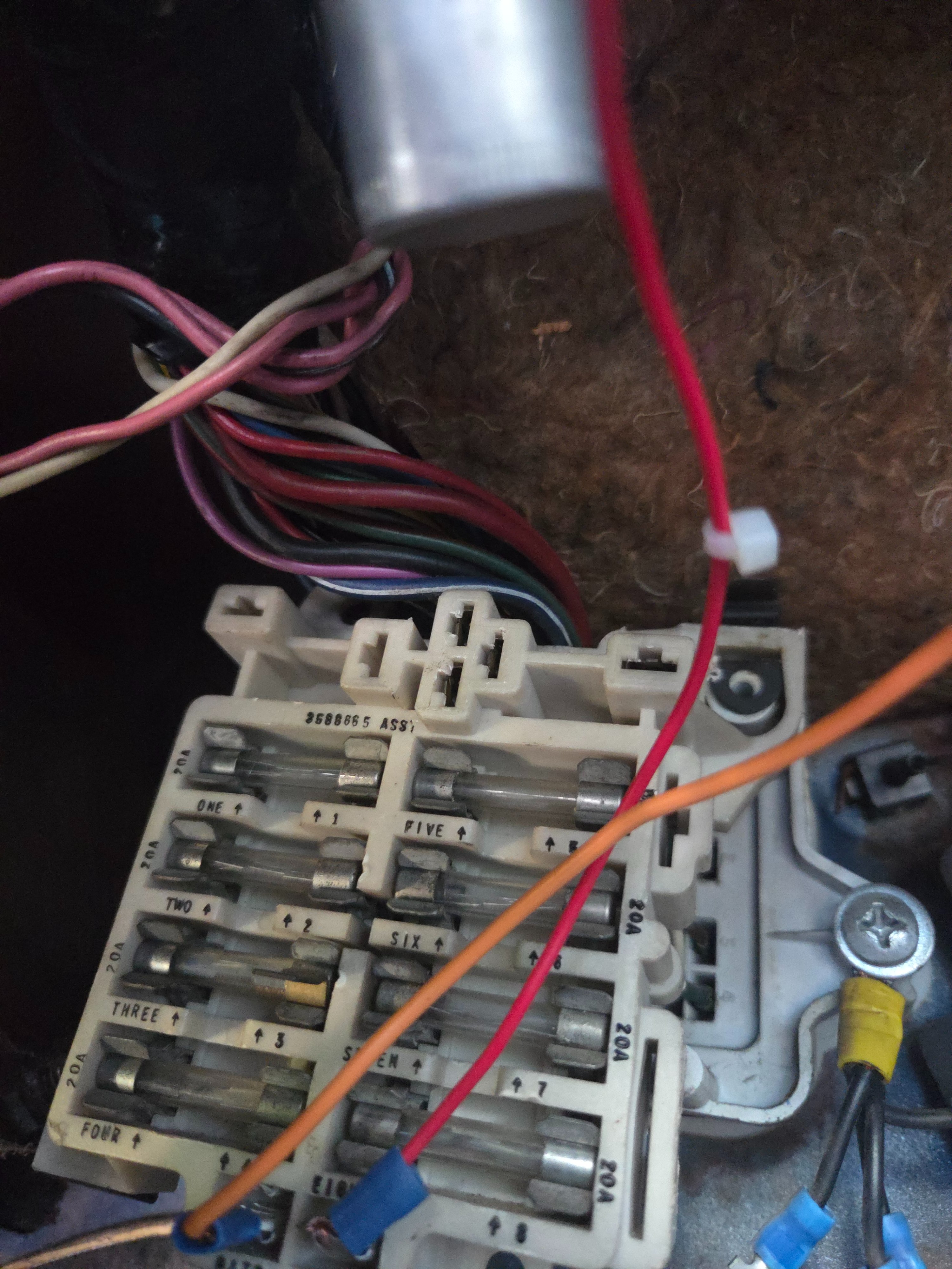

I cannot find the relay. Looked at my service book and it says its mounted to the fuse block. Mine is not there. I did find a 2 point relay for a flasher relay but nothing thats 3 point.

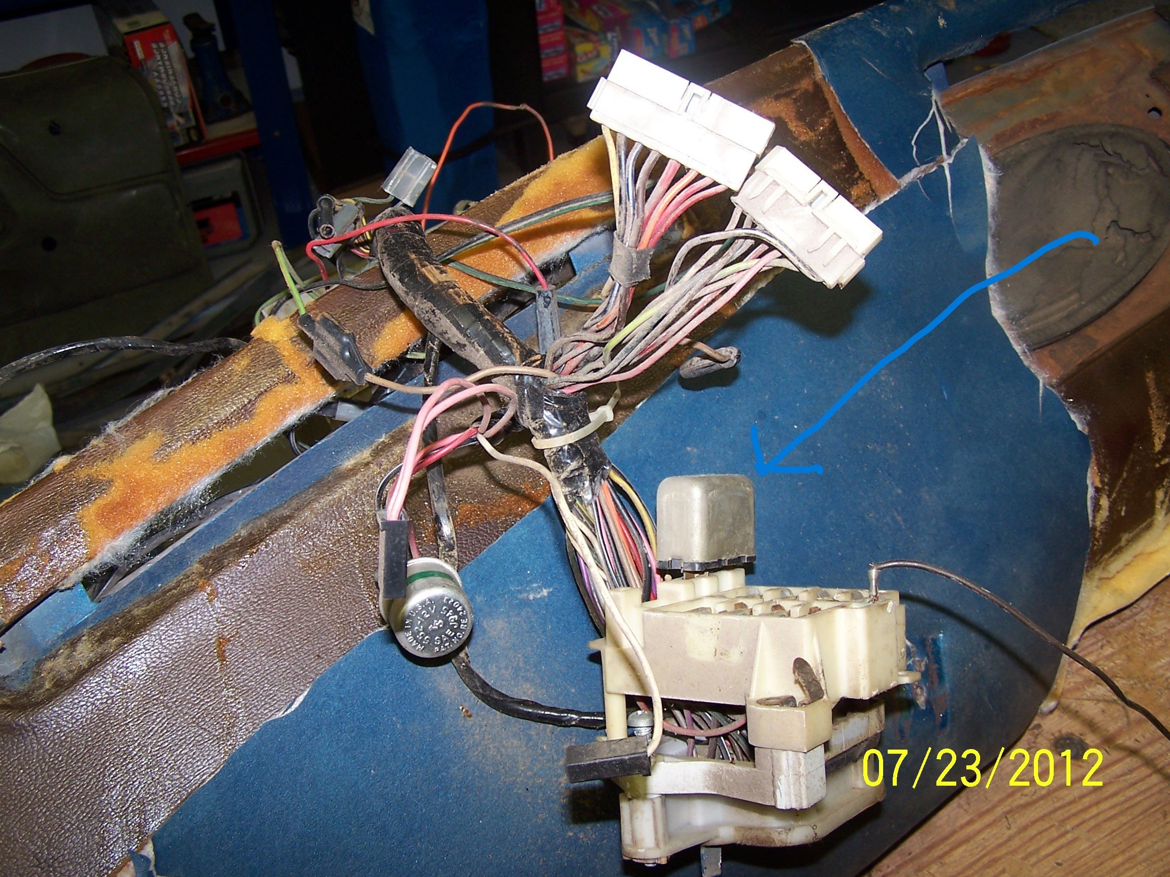

Here is a pic of the horn relay on a E body. The blue arrow is pointing to it. Is yours missing? Oops. Your pic beat me to it. It appears yours is missing.
