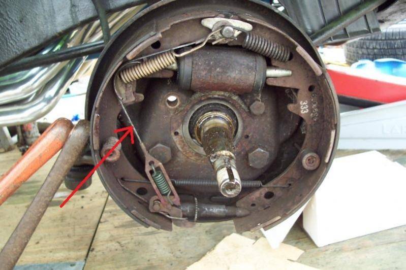

Ugh! just went out to mess with my brakes again and found this part broken (see arrow in pic) I don`t even know what to call it or it`s exact, function the car was still stopping fine but I could hear something rattling around in there. Hopefully I can find this at a local auto parts store. The pic doesn`t show it broken but the cable snapped and the piece at bottom end of cable with the spring is bent up in a "C" shape. I have put at least 500 hundred miles on these brakes I just noticed this noise the other day and found the cable snapped what could cause a failure like this? If I had 15" rims I wouldn`t even bother with the drums and the PST kit would be on it`s way! Does anyone know if you can get away with 14" rims with a PST power disc brake kit?
I get a constant squeak from the drivers side front drum, the pad looks like it`s wearing unevenly. Now I get this on the opposite side!

All the hardware is still available from a parts store. It's a good idea to change out all the springs during a shoe replacement. That cable is the automatic adjuster. When you hit the brakes in reverse, that cable adjusts the star wheel and keeps the brakes adjusted. Pull the star wheel apart and make sure it's not seized too.

Thanks everyone for the replys. Just to avoid confusion the pic I posted was a before pic of my brakes I had saved. I did rebuild all the components and front end before I put it on the road. I couldn`t agree more with Moparleo no matter how fast you go you are going to need to stop!
