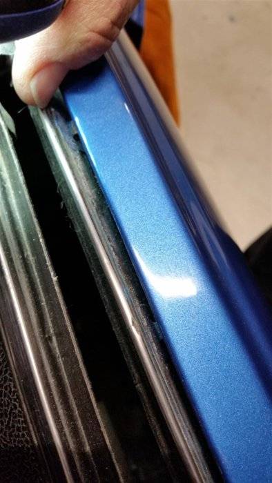

I believe the ones on your 70 Cuda are the clip in ones like my Challenger. Sometime in the 1971 model year, they switched to the screw in type. I've removed them by pulling up to get the clip out of the slot in the door. Window must be down and protected. Protect the top of the door from chipping/ scratching - I've used tape. I'll see if I can attach a photo. I would use needle nosed pliers to carefully pull out the old ones.
