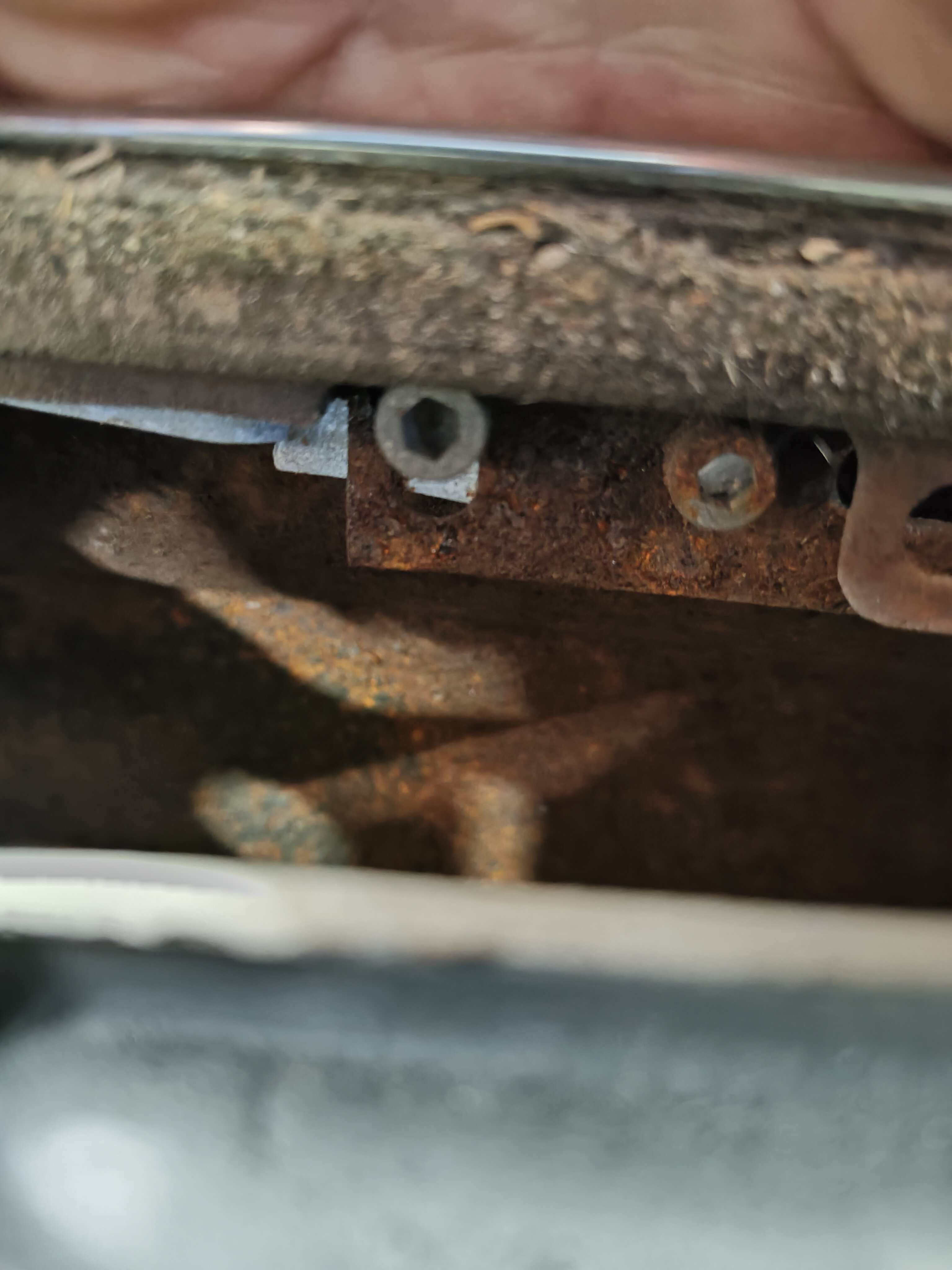

Another problem, I have the rear quarter glass lined up nice, but it goes up about 1/4" too far, I don't see any
upper bump stops anywhere. Is there an adjustment for this?
Thanks!
Jim
Xcudame
May 27, 2023
2,172
1,569
Southeast Arizona
You may be missing the stop held on by two socket head cap screws. See attached photo.
