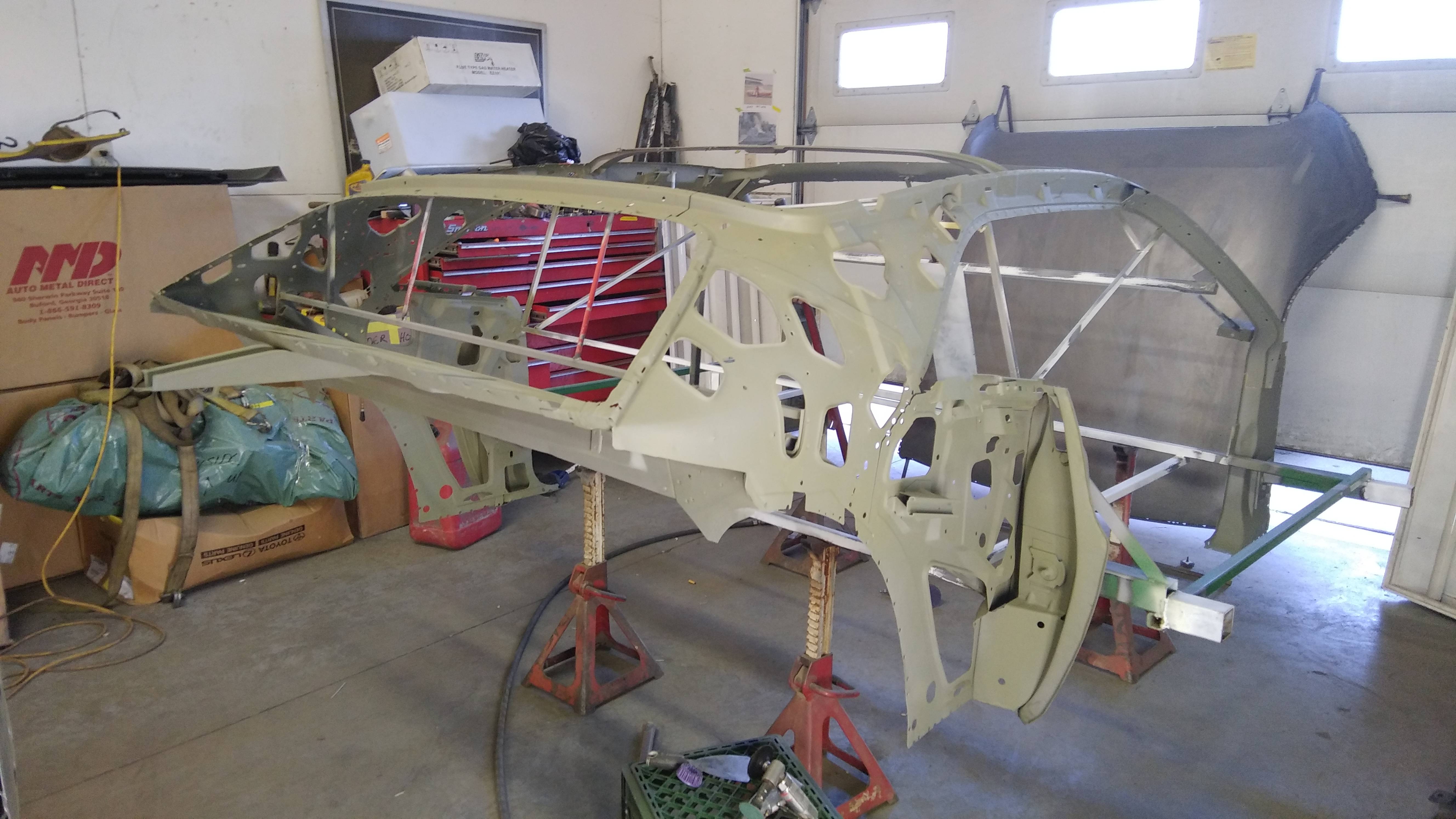

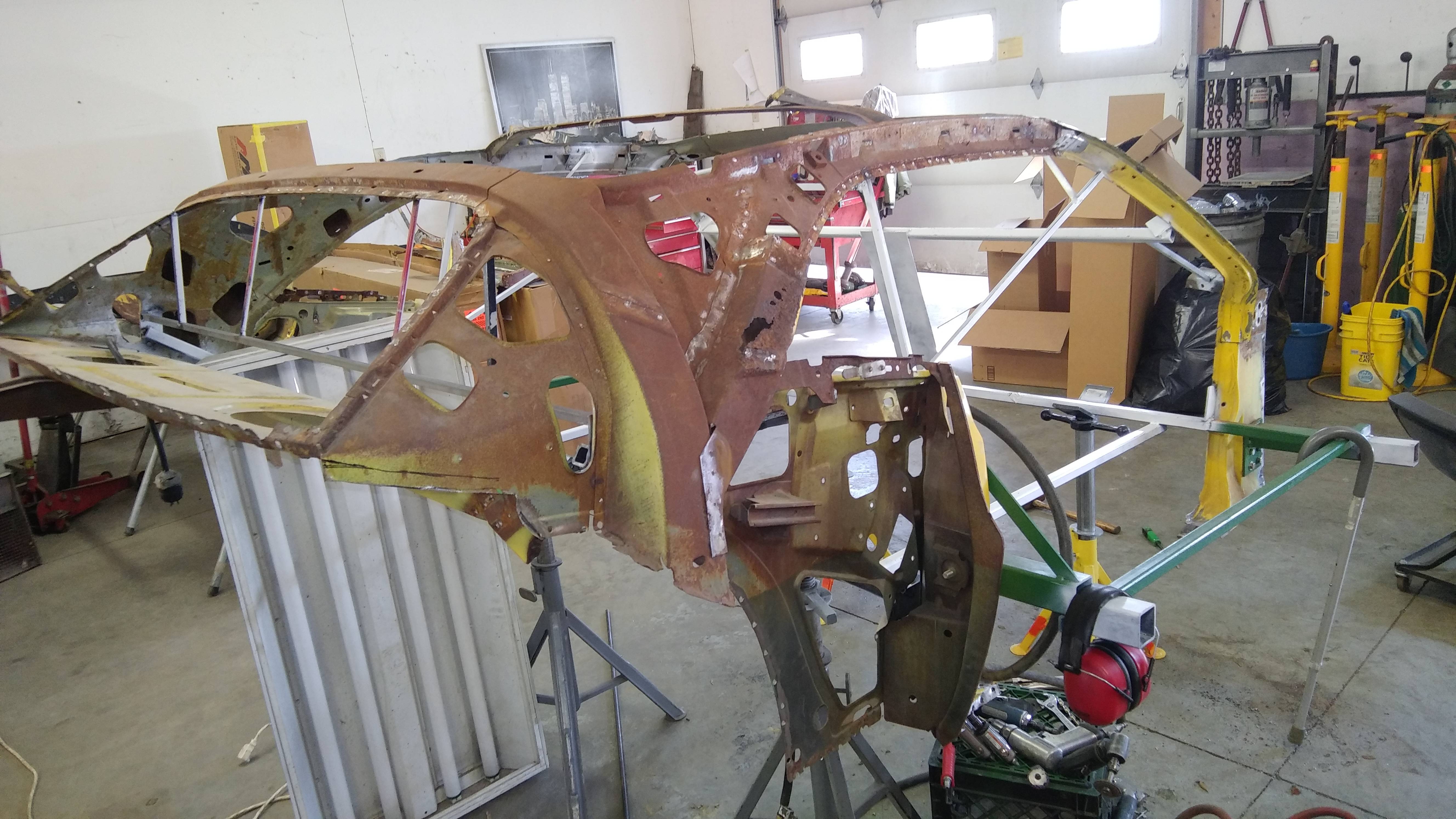

Props on your roof structure effort. That had to take some patience. Mine looks about like that but it's still attached to the rest of the car. Any chance I could get some pics and measurements on the position of the center cross bar? Mine was removed for the installation of a flip up sun roof back in the day. I found a replacement and would like to make sure it goes back where it should.

Well I looked at it before taking measurements and realize there is no need to. On the inside of the roof pillars roughly near center you will find a flat spot with three raised bumps this was for the factory workers to locate the part perfectly every time. One on the bottom and one on each side. you should also be able to find marks from the removal of the original part.
How hard was it to get the whole roof skin off and was it still usable or did you replace?

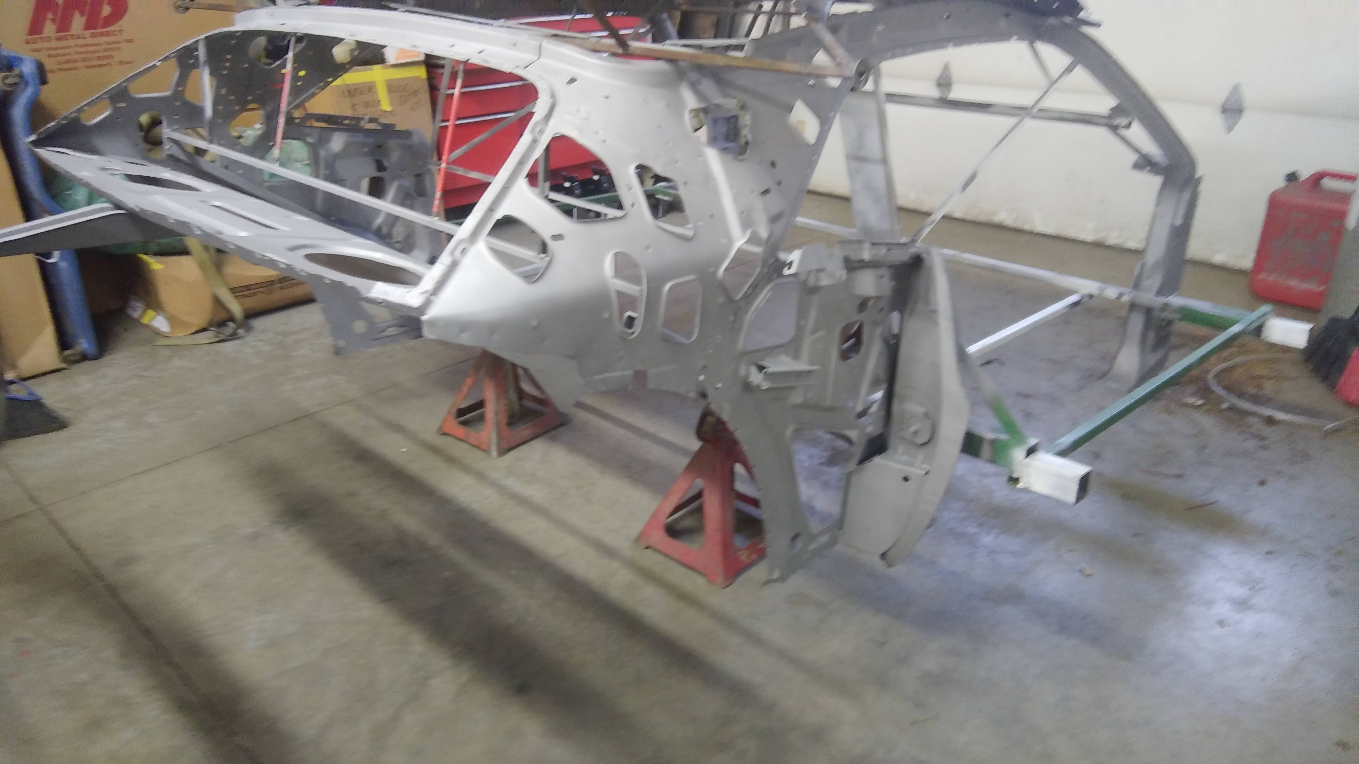

While my roof structure was exposed I cleaned, used Ospho, and painted it.

The roof skin was removed, repaired, and will be reused. it was very difficult there are about 125 spot welds that penetrate as many as three layers. in our case when the car was built the tips on the factory spot welder were already quiet worn and produced peanut shaped welds the resulting in the about three times the normal time it should have taken. I recommend reuse of the original roof when ever possible at least you know it fits you simply line it up with the old holes clamp it weld it and or glue it!
