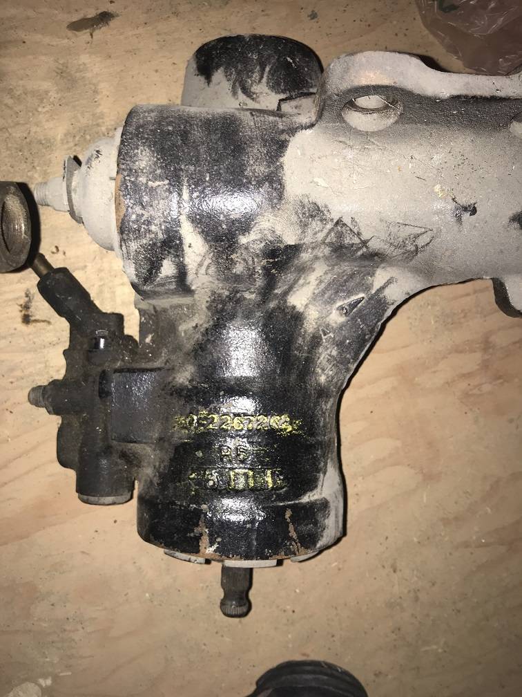

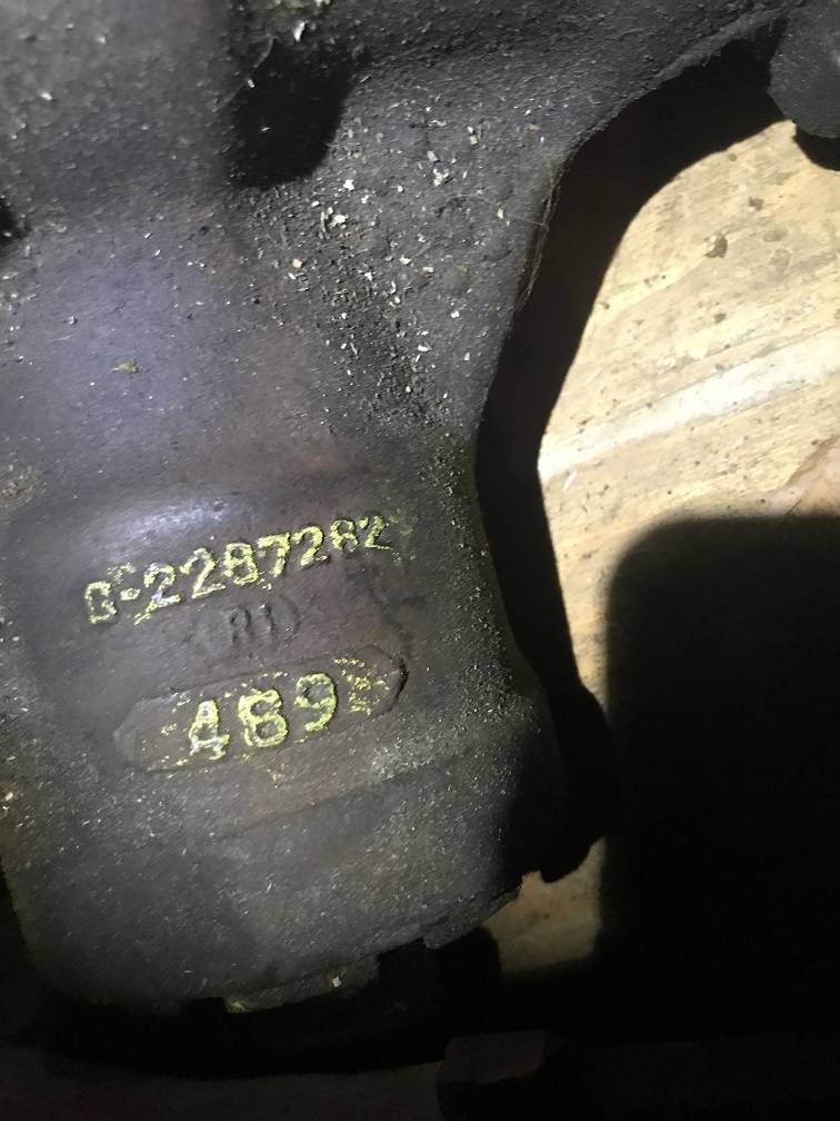

Nov 14, 2021 #1 R Roady 69 New Member Joined Feb 25, 2021 Messages 4 Reaction score 0 Location Buffalo NY I have three power steering boxes. They appear to be pretty much identical. I only need one for my Challenger project. Any ideas on which one of these would work? Thanks in advance.
Nov 14, 2021 #2 moparleo Well-Known Member Joined Oct 17, 2011 Messages 7,179 Reaction score 1,958 Location So. Cal. Riverside area Moreno Valley As long as the pitman arm diameter is the same, they will all work. Same part number for many years, B & E-body.
