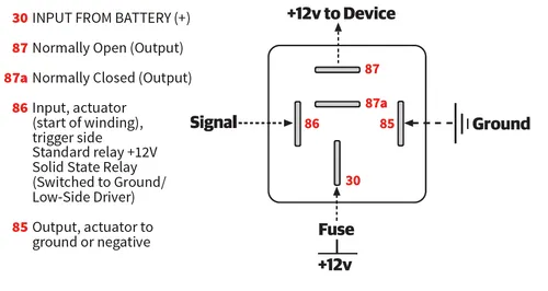

I am a simple mind I guess, but just for the worls of me cannot figure out the ingnition wiring for the IDIDIT tilt column. If anyone has used hte ignition relay please let me know how to wire it up in simple terms. The turn signals are straight forward, but the ignition side has me pulling my hair out.

I didit uses GM switch , , relays are simple 86/87 are low current power in & ground out , 30 / 85 are the high load power in & out to the start solinoid
