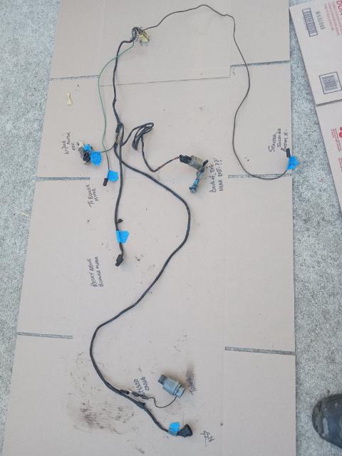

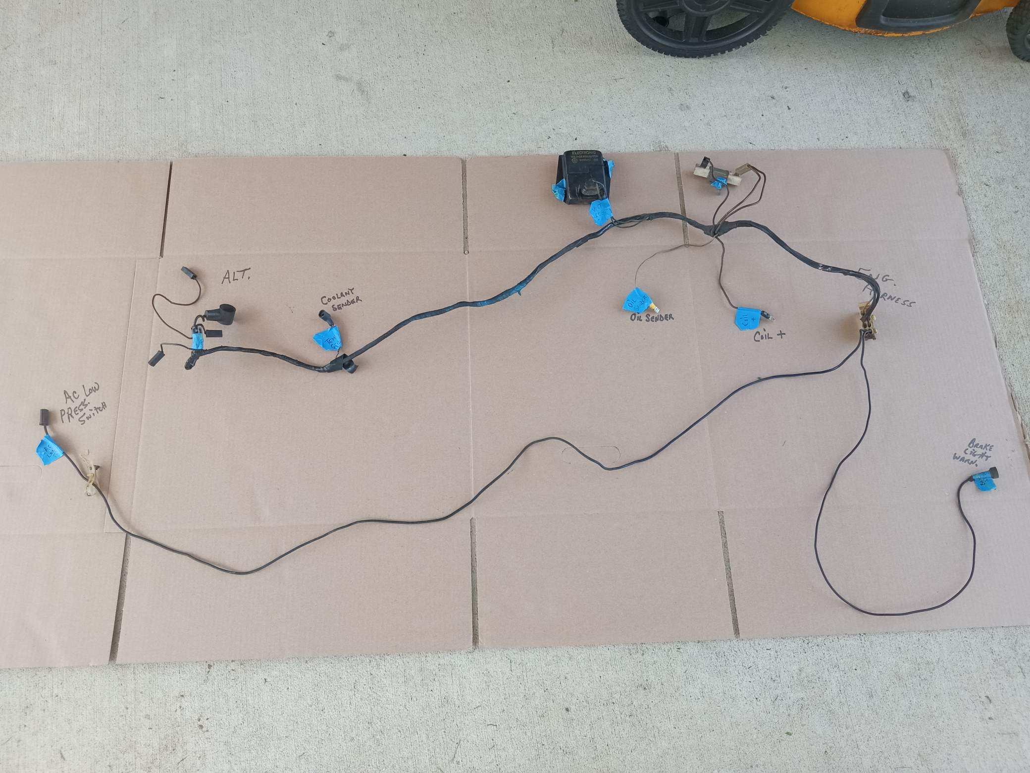

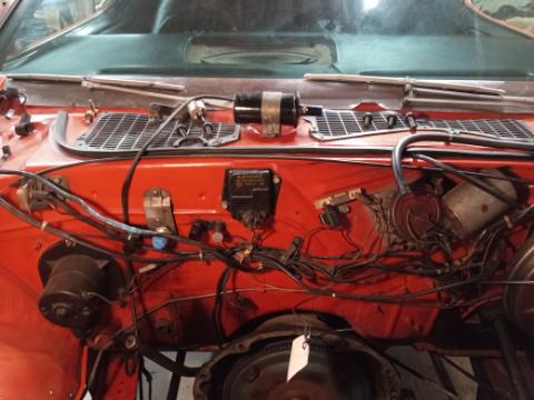

My engine is out so I`m cleaning things up in the engine compartment. Decided it might be a good idea to replace the wiring.
Got a couple new harnesses but they are different from mine.
Anyone out there familiar with engine bay wiring and the differences. Anyone have or seen harnesses like mine ? Are they normal ?
Car is a 72 Challenger Cali built 318 AT 904 PS /PB /AC.....has points ignition.
Pics of trans and engine harness......they`re laid out and labeled connectors. There`s also a strange relay thing above the blower motor.

The strange relay above the blower motor is the N95 NOX Exhaust Emissions Control. They started showing up in mid 71 and across the board in 72 and up. Your fender tag should have N95 stamped on it.

Yes, N95 is on the fender tag.

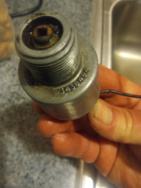

How about the round thing w/wire the speedo cable screws into then it screws on trans.....anyone know what that is ?
I just got the car about a year ago....it`s very clean and doesn`t appear to be hacked up.
It does have points distributor....I removed the points and installed a Pertronix module.
Wiring guy said my harnesses look different....trying to find out if others have similar harnesses.

That switch is also part of the NOX Exhaust Emissions Control. Once the car hits about 40 mph, it works in conjunction with the other piece on the dash and I think retards the timing. Basically emissions related "stuff".
