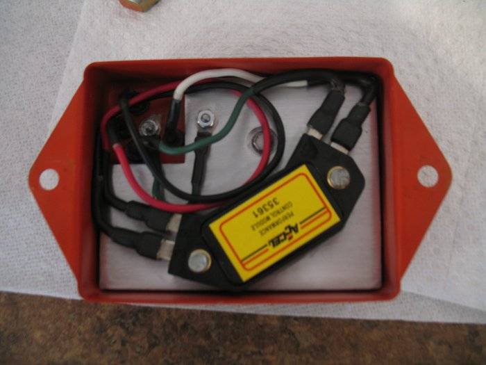

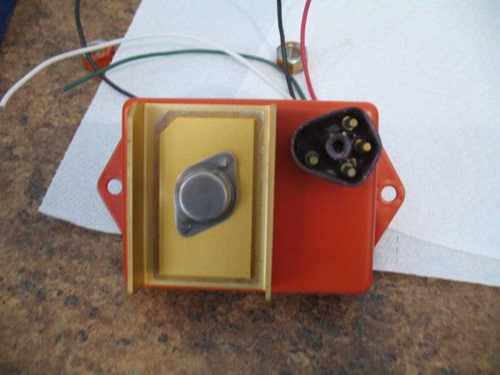

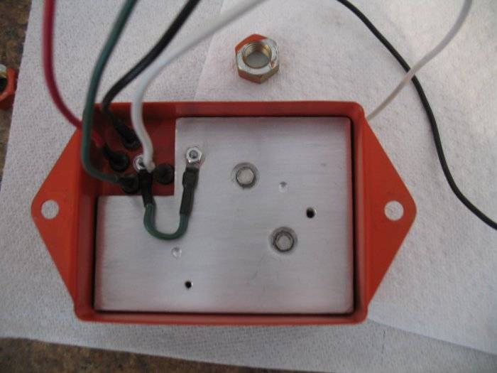

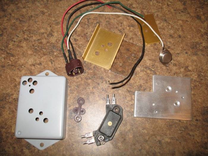

HI all
I have a few days off work so id thought I would try to build a new ignition module from an old mopar box and add a performance gm HEI module inside. Why you might ask, well there a few reasons. One I've heard that the new orange boxes are not very good, and the gm HEI can take more current and give a hotter spark, and I want to see if I can get it to work. Anyway I'm still having some issues with my car and I want to see if this will improve it. I will post more pics when I start to assemble I painted the box and will have it let it dry.

HI all
I have a few days off work so id thought I would try to build a new ignition module from an old mopar box and add a performance gm HEI module inside. Why you might ask, well there a few reasons. One I've heard that the new orange boxes are not very good, and the gm HEI can take more current and give a hotter spark, and I want to see if I can get it to work. Anyway I'm still having some issues with my car and I want to see if this will improve it. I will post more pics when I start to assemble I painted the box and will have it let it dry.View attachment 36285

I finished my little project. I will test it in the next week or so. If I can't get it to work I will probably try a chrome
box as well.
