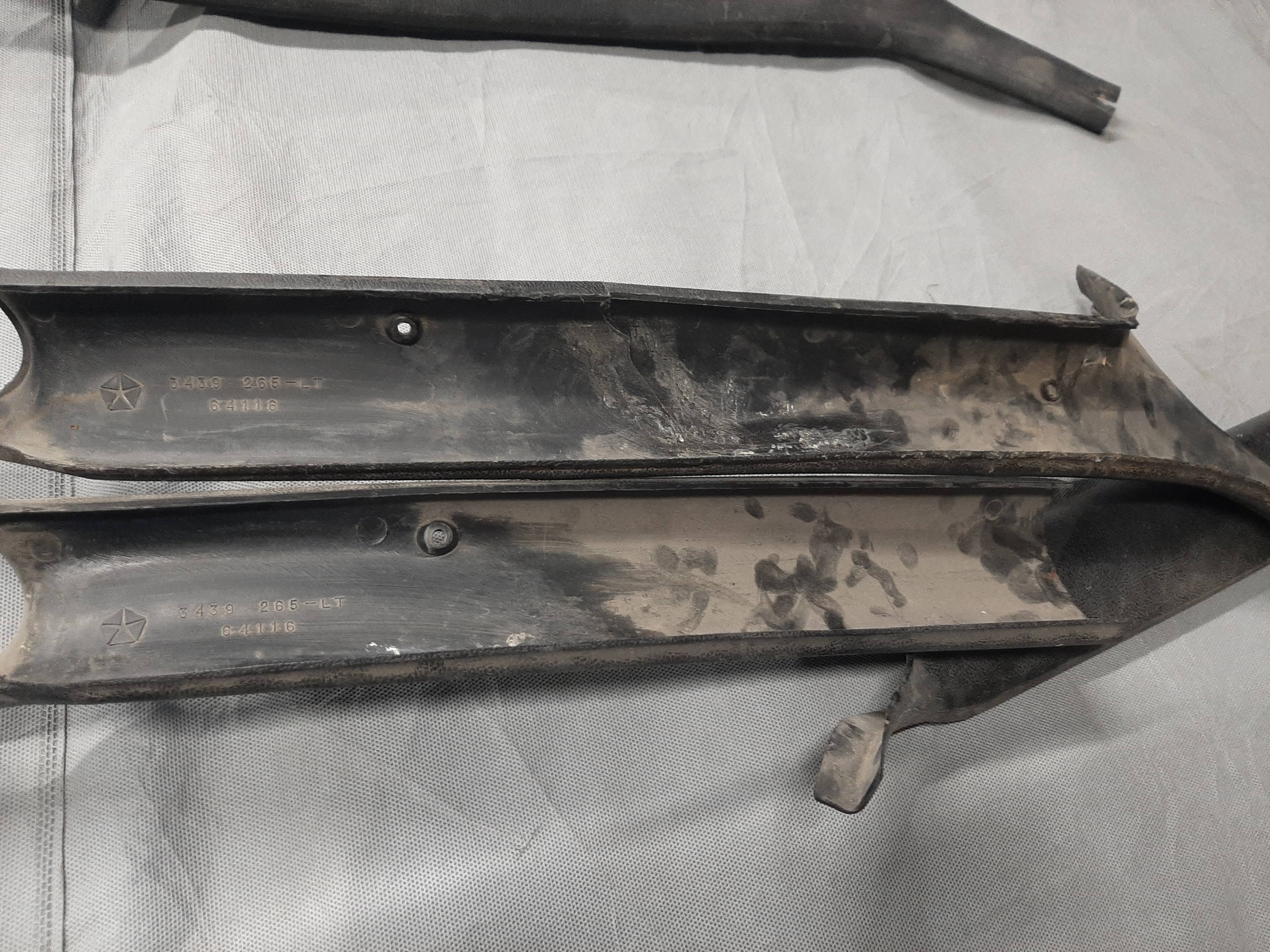

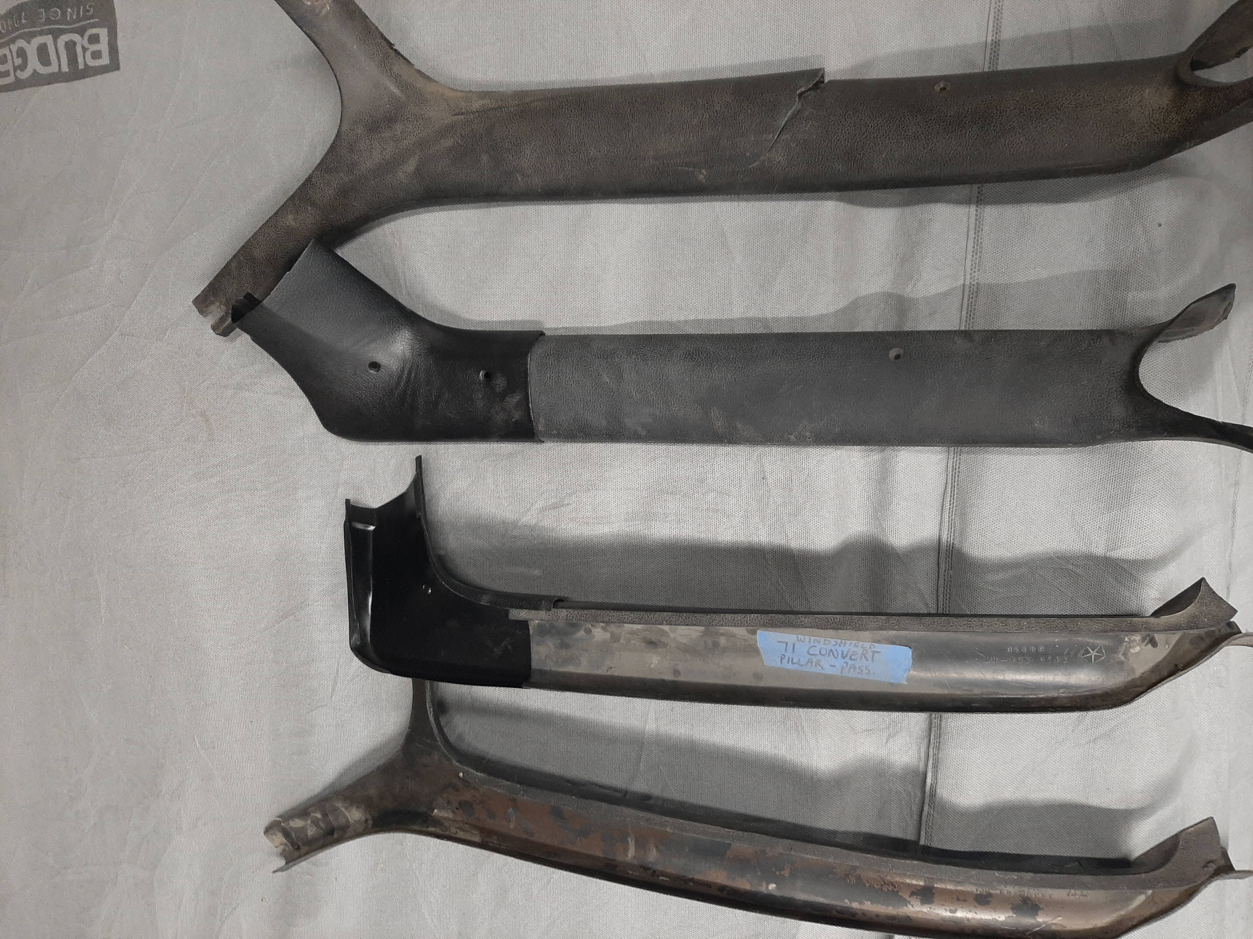

The only difference between the convertible and hardtop pieces is the length. Everything else is the same See photo. Cut a hardtop one to length.

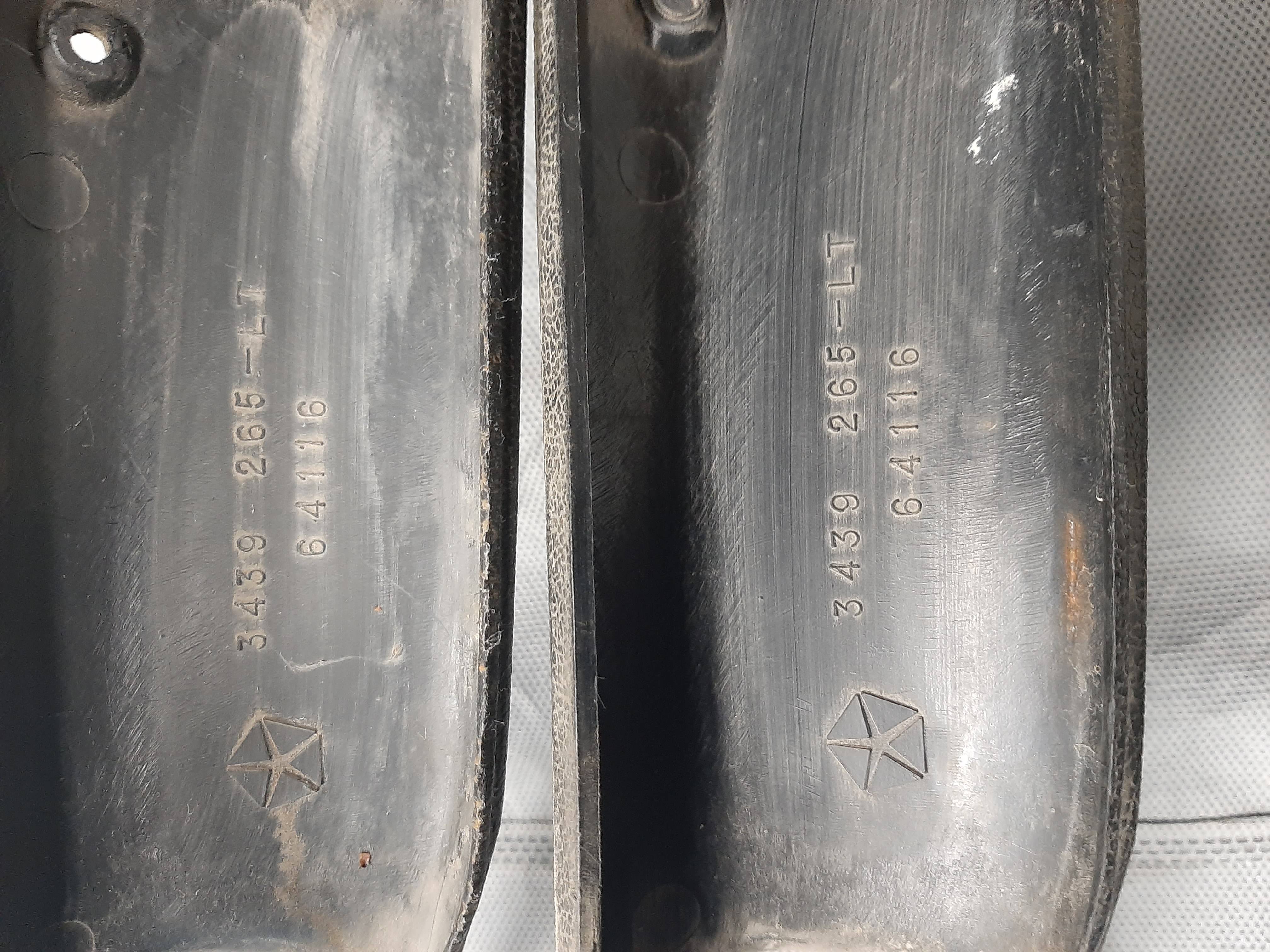

Terry, do the two you have pictured have part numbers? Years ago someone showed me a HT one & Conv. one and they both had the same part number. I'm pretty sure his 'vert one wasn't a cut HT one. Thanks in advance.

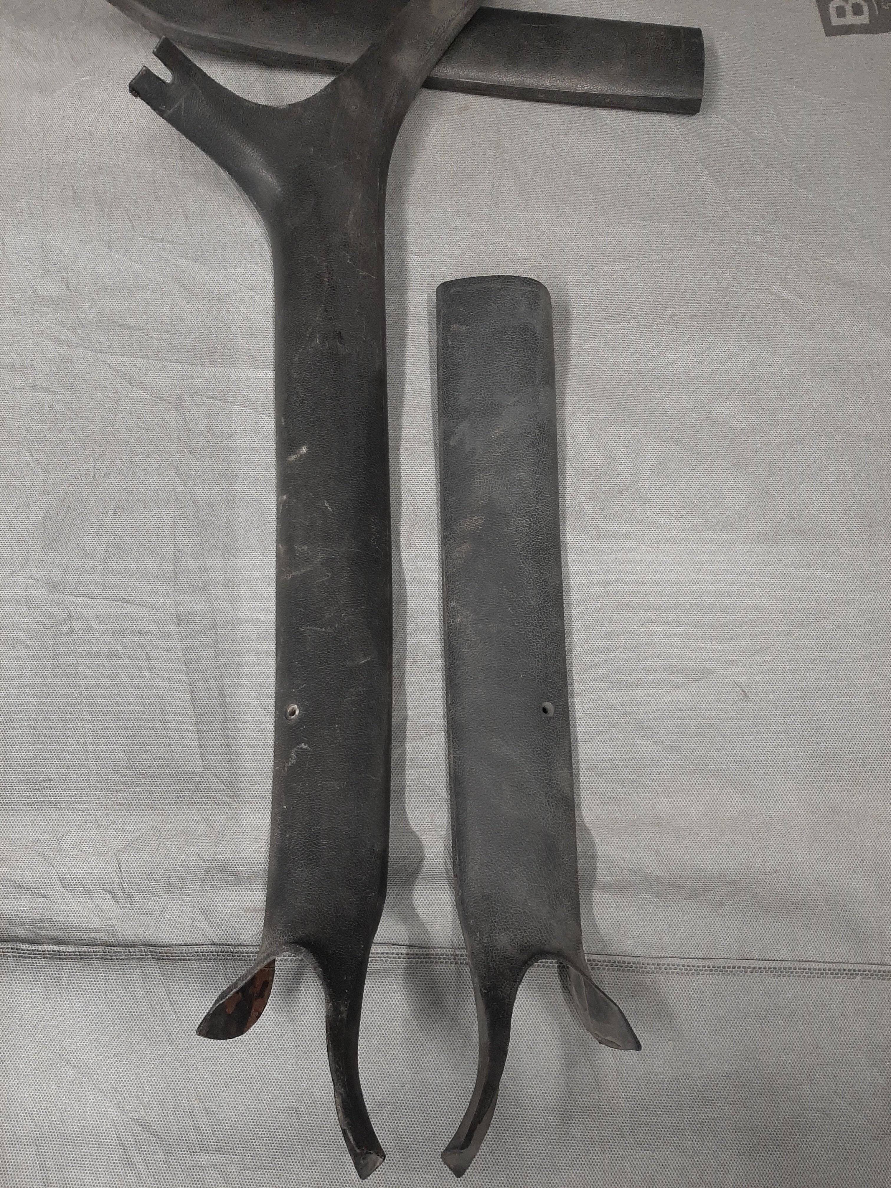

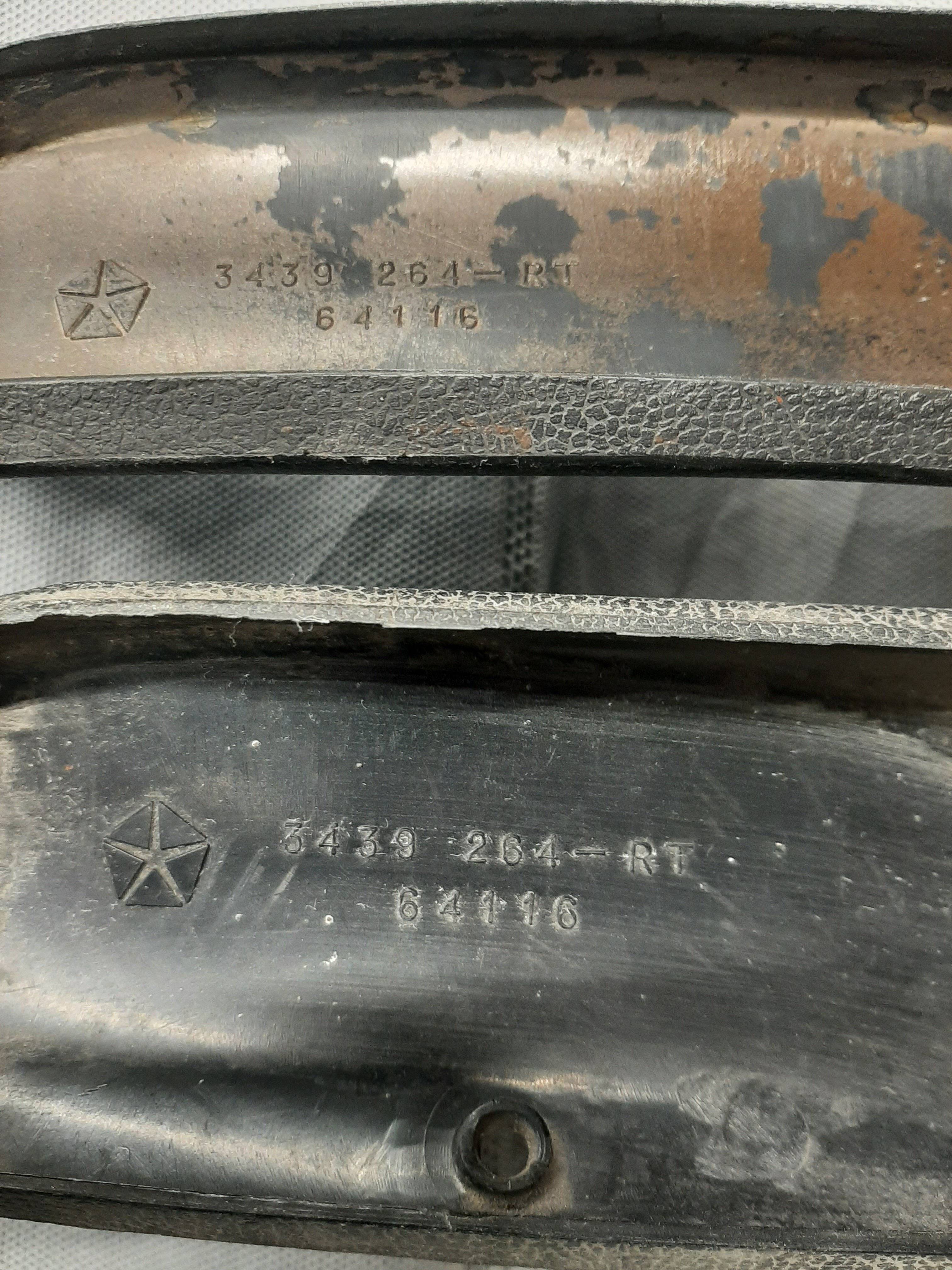

I sure do. The one with brown paint on it is hardtop. I compare the other side in the other photo. I can't verify if the repro hardtop ones are the same but originals are the same. When I measure them, they're the same. My spare metal convertible corners fit on both the convertible ones.

One last photo showing the metal corner trim covers on the plastic covers. It may be you would need to find a set of original hardtop pillar covers.

Ok thanks for help ad the pics. I know now I need to find a pillar with the same numbers. I'll start there.

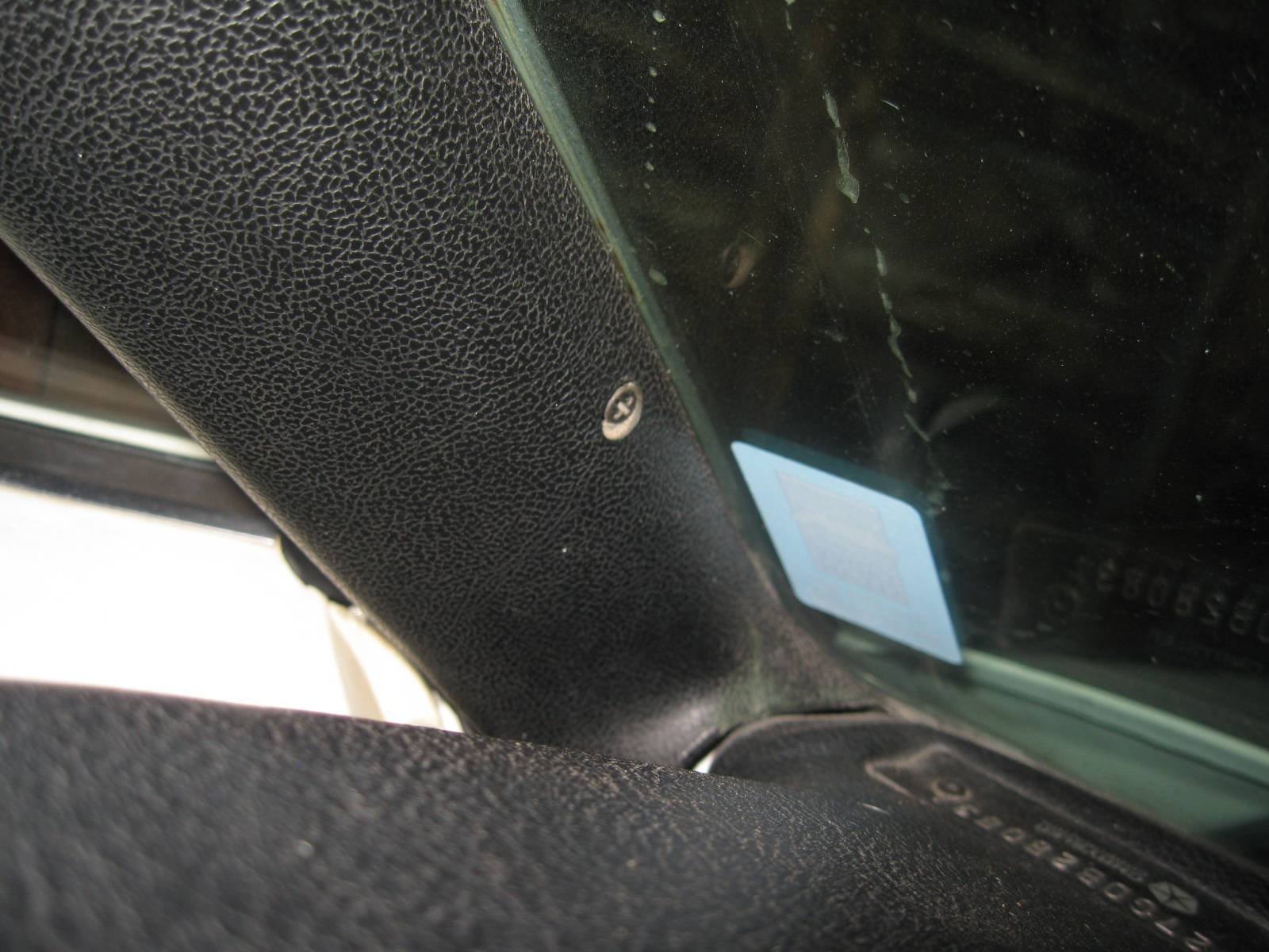

Also there's 2 different locations for the screw hole. The OEM ones on my convertible are lower down, closer to the dashpad.
