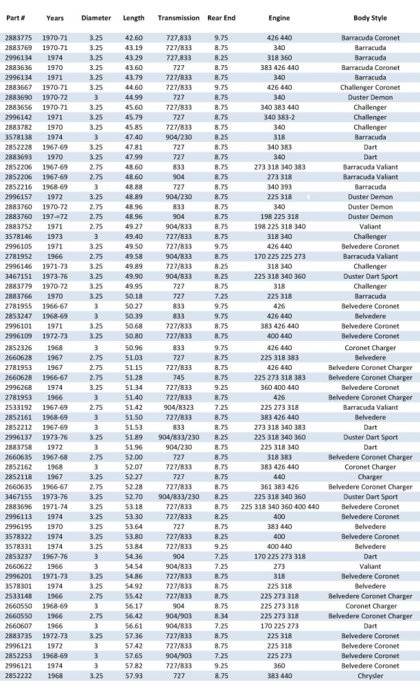

Looks like part # 2883656 45.60" long, 3.25" tube size Looks like there are no others that will fit. Get a new yoke and have one built.
