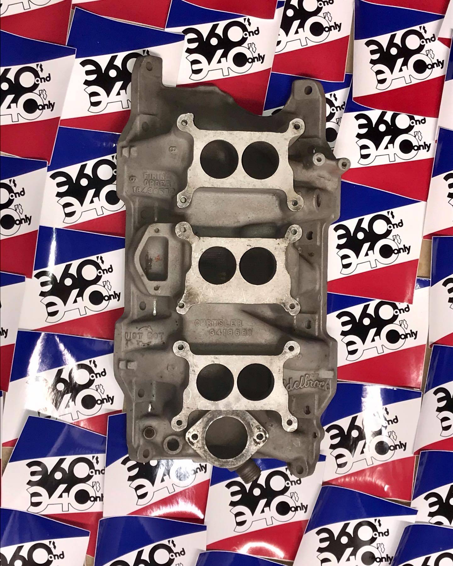

So far I have collected, for the 360 build, a 1972 block and mains, Com Cams double roller timing chain, timing cover, J heads that are at the machine shop for 1.94 intakes right now, original T/A / AAR 6 Pack intake, Eagle forged H-beam rods, and a few other small items.
Needs are stock stroke 360 crank, water pump, oil pump, pistons, cam, gaskets, bearings, distributor, headers, and Fi-Tech's Six Pack EFI. As you see there is still a ways to go on the parts collecting with the biggest item being the Fi-Tech EFI.
