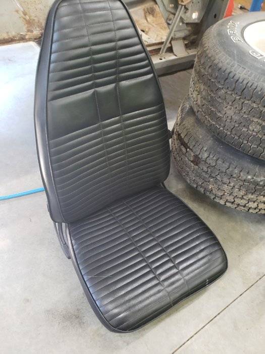

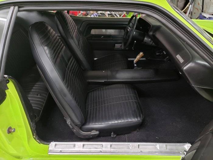

These were in my RR and I want to put that back to the correct bench seat, perfect for the Challenger:
And here they are installed:

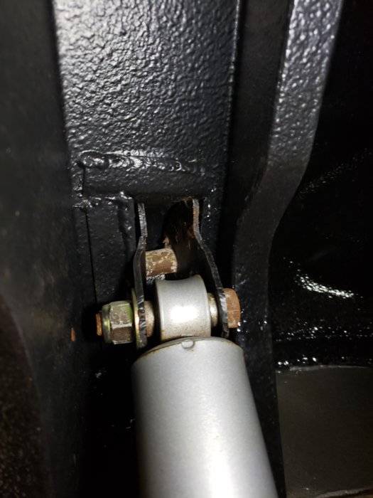

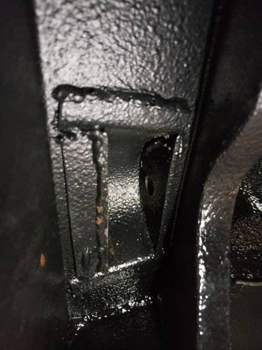

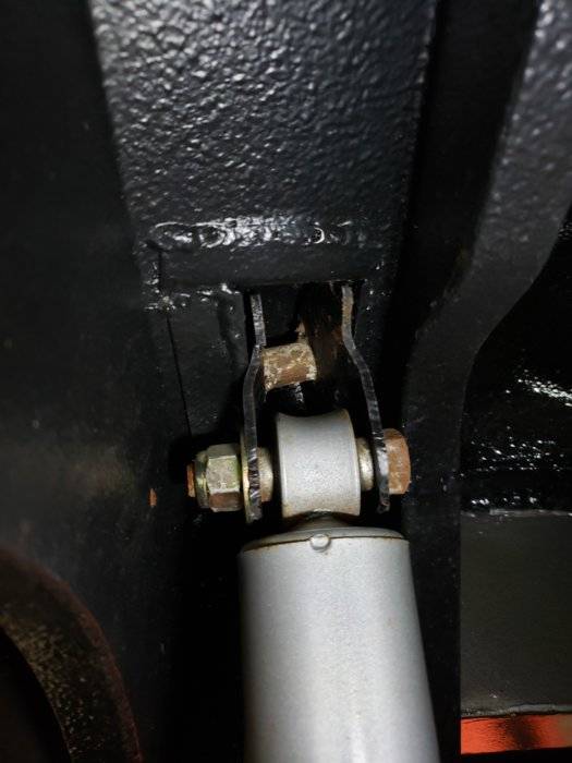

So I have half the car torn apart trying to find a clunking noise when I go over bumps that has been driving me crazy. I think I have found it. Here are some pics of the rear upper shock mount. Does this look right?
It looks to me like the previous owner reinforced the original mounts but then the shocks didnt fit so he added the extensions. Im fairly certain those are loose and clunking against the crossmember over bumps. Any suggestions how to fix this? I thought about welding the extensions in place to keep them from moving but I dont think he left enough room to get the bolt out if I ever needed to change the shocks. I guess I could rip it all out and put a new crossmember in but not really looking forward to that. Any suggestions would be appreciated.
WhiskeyRebel
Aug 30, 2019
30
17
Im going to pull these out and see if I can get them to fit by cutting down that sleeve for the bolt. Not sure that is the issue. Someone went to a lot of trouble when that seems like a pretty simple solution. I'll update when I get these out.

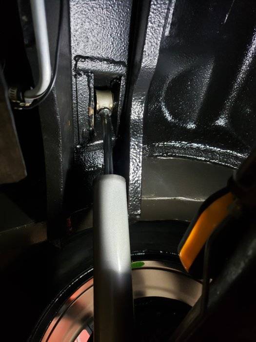

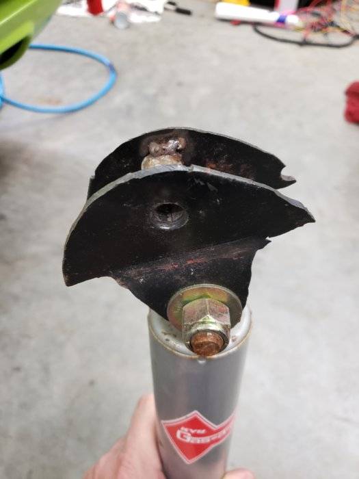

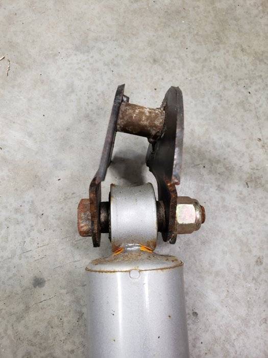

Finally got some time on the car tonight and here is what I found. What the...
WhiskeyRebel
Aug 30, 2019
30
17
Wracking my brain on how to fix this other than replacing the crossmember. The shock wont fit in as is and the angle is wrong too.
Here is what I came up with for now:
I cut the sleeve off the shock and put a small bend in it so the angle was correct.
This should work for now until I get motivated to fix it the right way. I have a Fitech fuel injection throttle body and a tanks inc tank to put in some day. Maybe when I pull the tank Ill fix this.

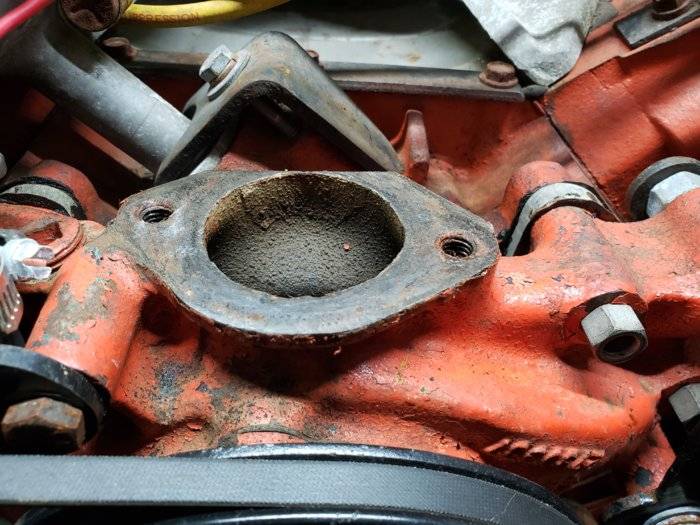

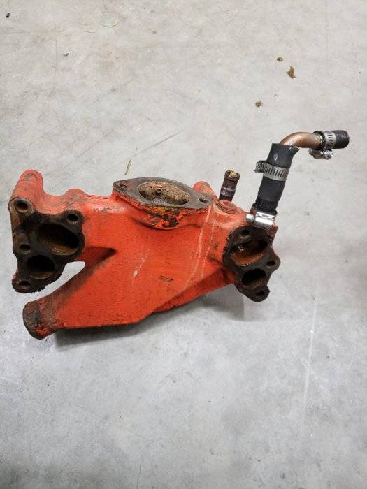

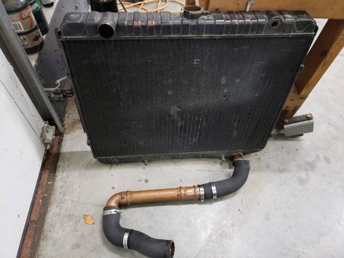

On to the next project. The previous owner strongly suggested I shiuld change the radiator from the 2 core to a 3 core as it ran hot. It never overheated on the short drives I have been on but my guages also dont work so no idea how hot it was getting. Plus it had the outlets on the wrong side and had this contraption to remedy that:
I picked up a 3 core with the outlets on the correct sides. But here is what I found on the waterpump housing:

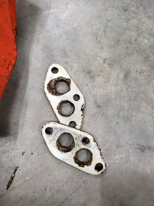

The back side of the thermostat housing is really thin. Is this normal? It almost looks like someone cut it down for some reason. Anyone know why someone would do this? It looks like there are some homemade spacers between the block and wp housing. Not sure why. Im thinking I should replace this. Any suggestions on a good housing? I see a few on Summit.

Not normal at all and it is going to leak for sure. Throw the housing and the spacers in the scrap pile. It looks like the entire back side of the housing has been machined as there is a nut spacer on the power steering pump bracket too. Replace the water pump while you at it. If you want to lose some weight, go with an aluminum housing and pump.
Looks like the previous owner was a real hacker:lol:.

Thanks. Yeah there may have been some budget minded mechanics in this car's past :)
Interestingly I found those spacers on the Mancini website.
INDY Water Pump Housing Spacers
Says they need to be used with part #440-22 but I cant find what that is. Did someone shave that housing down to save weight?
WhiskeyRebel
Aug 30, 2019
30
17
Probably came of an engine with a mid plate.
Ahh, this makes sense, thanks.
