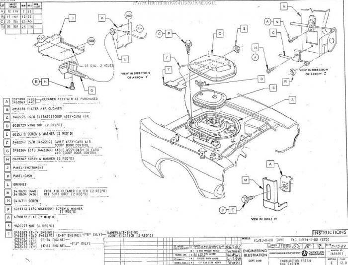

Thanks Steve I appreciate the tip, I'll contact Mega Parts.Mega Parts has them they are the same as a heater cable clip if you have any of those spare.
The inner or outer cable is probably just a fraction to long or too short. They do not have to be a lot out to be a problem.
Quite tricky to sort out can you set it so it looks acceptable?
