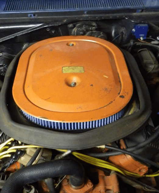

Can't say if it's the same for shaker but here's differences in the grabber style......
Nick's Garage - Air Cleaner Identification
Hi Dave,I was doing some searching on another site and I think Floyd and yourself might have done some fabing on a hemi base plate. It looked like someone bought a holley drop down air filter and fabed it onto the base. They make them in a couple different sizes. 1" 1 1/2". That would probably do it as long as it doesn't interfere with fuel lines etc. Thanks for your feedback.

Just my thoughts and I own a factory Shaker car.
The Shaker is time consuming to remove and a pain in the ass to take off over and over if you tuning the carburettor. Worse if the carb is flooding and fuel is everywhere.
Luckily this has not happened to me but I dread it.
You can barely see the carb with the Shaker on.
I doubt the Shaker works any better air flow wise than a well thought out performance air filter and it would let you see the carb and be easy to get off.
But damn they look good.

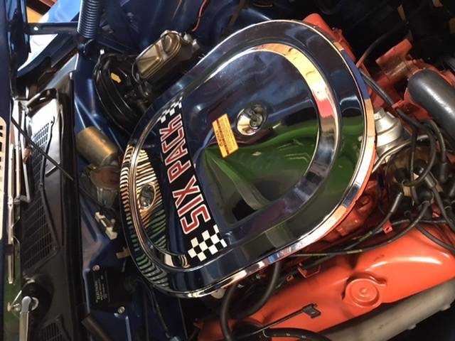

Nice clean engine bay. I seen a thread awhile back that you might have been involved with. It was about fabricating a holley drop air cleaner to a shaker base plate.
Daves69
Feb 4, 2014
360
130
ChiWest
..I think Floyd and yourself might have done some fabing on a hemi base plate....
Well fd, I've not modded any hemi bases. I do use a 440 six pack shaker base (less the adapter) on my '69 Barracuda. It required only a small bend to clear the 2 speed wiper motor nose sticking out.
