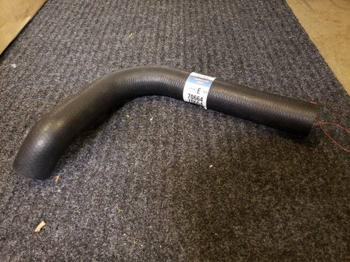

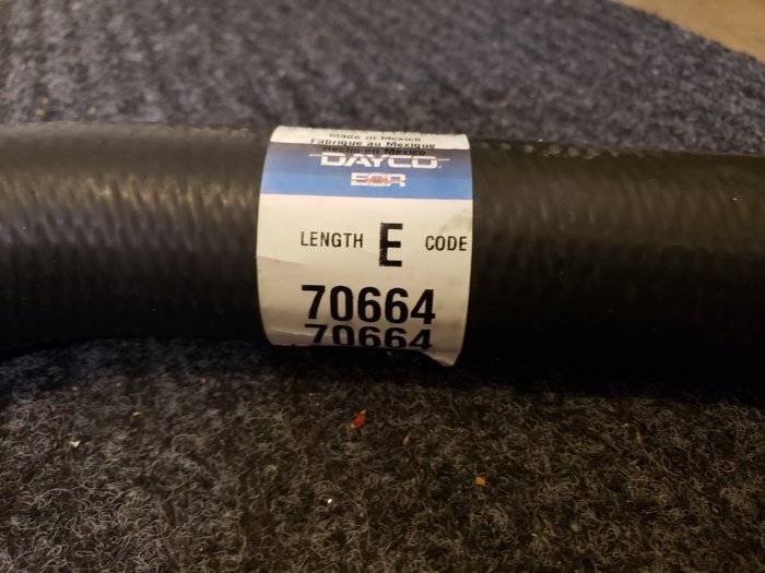

What lower radiator hose are you guys using for a BB/Hemi E-body?
I have a Hemi with an aluminum radiator, lower hose is on drivers side. I bought this hose after doing some research but it sure doesn't seem to be right. I'm not looking for an expensive restoration type hose, just something that will work.

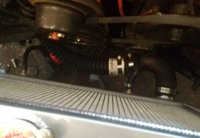

Im using part of a hose from a 5.9 truck and some fexi-hose from oreillys connected together with a pvc fitting and hose clamps. It doesn't leak. Yet...

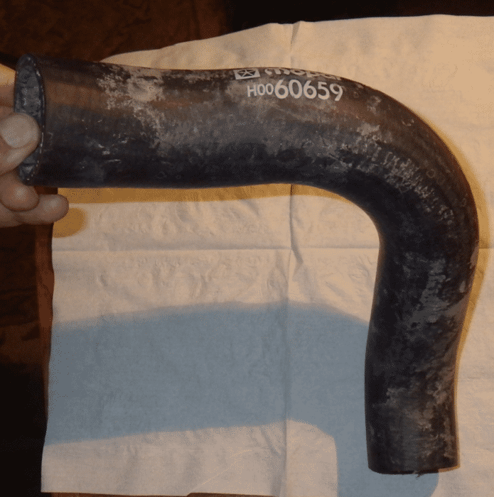

Hmm, looks kinda like this one Daves69. Is it the same?

I believe it is. That curl helps get the hose around the stock filter.
FWIW, I have a 26" radiator driver exit and driver side intake pump. I'll need to shorten it a bit as my Barracuda is an Abody.

I bought the 60659 hose, haven't installed it yet but it looks like it will fit perfect. Thanks!
