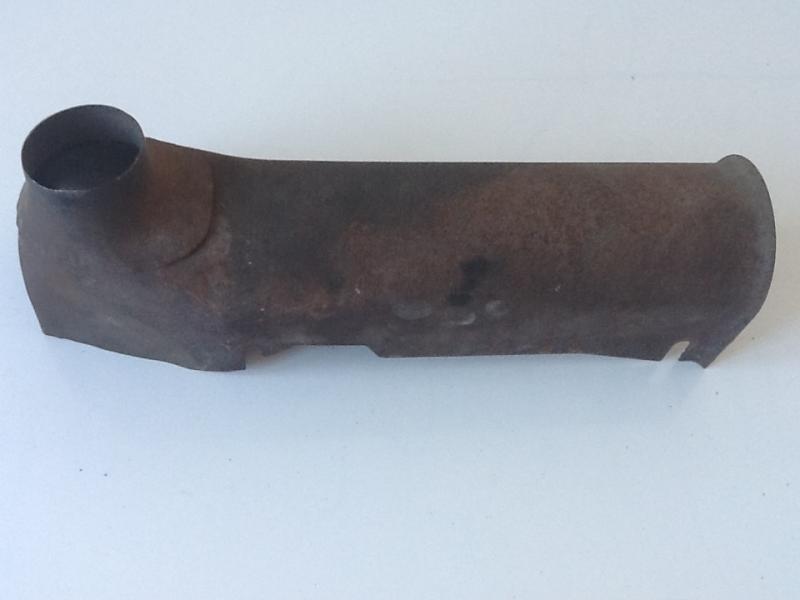

Will a manifold heat shield from a 383/440 fit a 340. I know they are made of thin metal but don't know if they could be modified to fit.
I am refering to the thin formed metal part that attaches to the left exhaust manifold which has a metal flex hose that attaches to the air cleaner. I don't know the proper name for the part. Heat Shield.jpg
no , totally different shape , the 440 has the plugs blow & sits high up , the 340 has the plugs above & sits out at an angle , you could prbably build a reasonable piece out of sheet metal

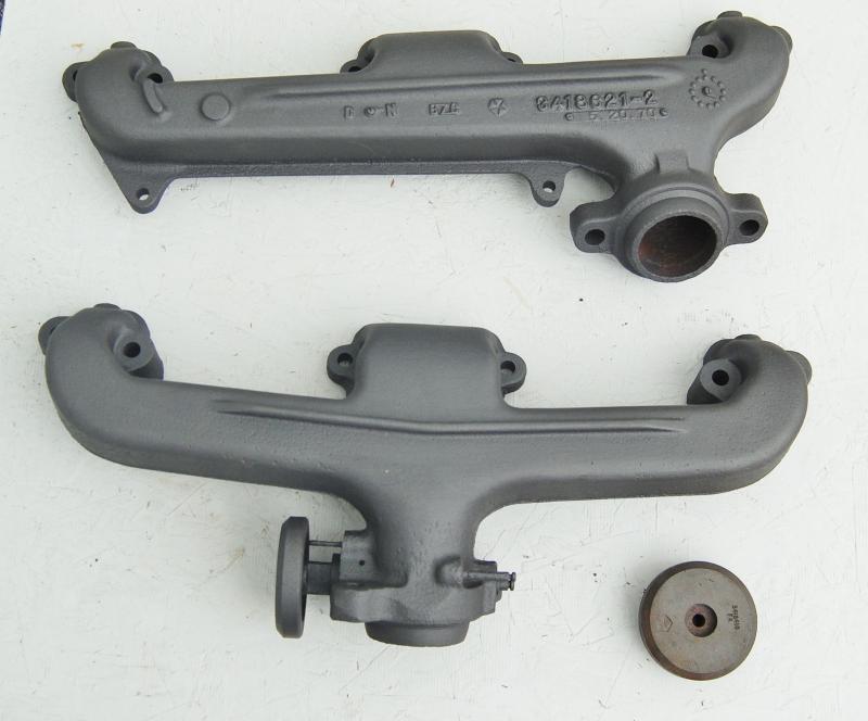

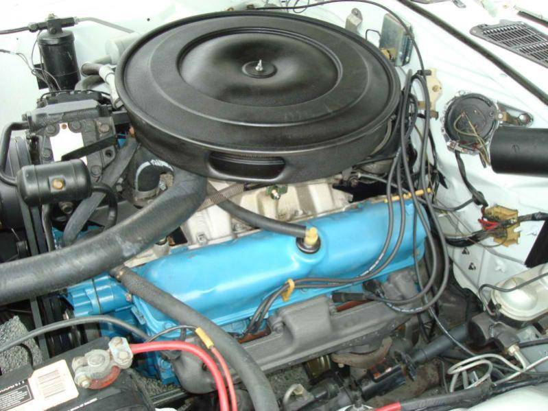

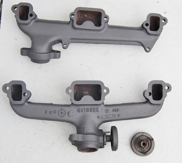

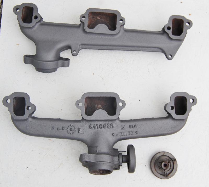

Looks like I'll have to look for another air cleaner, it turns out I have one from a 72 Challenger 340. The air cleaner I need has no snorkle, just 2 openings on the front as shown in picture. The reason I thought there was a hot air hookup is the two hole provision tabs at the bottom of the left manifold. According to the casting numbers these are the correct manifolds for my 71 Challenger, the dates are a little off but no big deal. Thanks for all the help, its always good to have others to run things by to see if I'm on the right track.$T2eC16h,!)QE9s3HG-uEBRPT2JLwPg~~60_57.jpg$T2eC16h,!)EE9s2ui)!4BRPT2CuIMQ~~60_57.jpg71 Left Exhaust Manifold.jpg
They used a different manifold on one side for 71 due to smog BS. Must of had the tabs built on but they did not use them. Would think it for sure did not if it has a non snorkel air filter.
